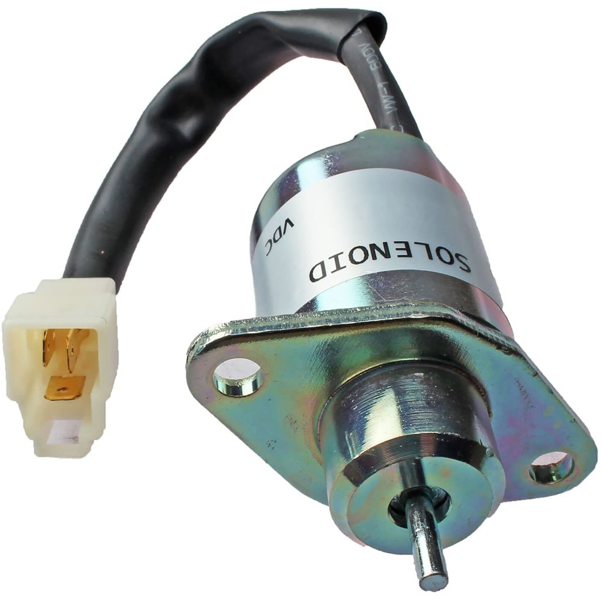

OK, I got it running tonight.. bottom line == most people were right Stop/Start Fuel Solonoid
It was a different symptom than before so yeah, I assumed that wasn't the problem(plus I've replaced it twice and I only have 1000 hours on the tractor -- it -fing can't be that).
It was.. on the plus side, I did replace the fuel filters, the air filter and did check the glow plugs and all are good :) I even found the oil sensor wire that had broken and fixed that one.
Thank you all.. and yep most were right.. solenoid

first part arrived.. starts right up.. but then shuts right down.. the plungers goes right back down when the key is in the running position :-(
   / BX2200 -- will almost start #49
Check for power on the connector one should be hot with start another in the run position. The third is ground. There was batch out there for Yanmar (same part) with the wiring different. 2 pins switched on the solenoid side.... could be your problem.
Let me find the details been a minute...
   / BX2200 -- will almost start #50
White wire should be start voltage 12v while starter is engaged
Red/Black should be run voltage 12 when in Run position
Black is Ground.
Make sure that solenoid is grounded through the black wire and it connects to the black wire on the tractor.

reviews on a few of the solenoids said they were wired wrong from the factory. I couldn't find my allegator clips so didn't try others but I did leave some reviews :)

I'll check today.. thanks for the help... I really want to just send it back and say.. fix the part. Yes it was from that place and the amazon reviews(all just disappeared).. hmmm
   / BX2200 -- will almost start #53
Nothing wrong with sending it back. I've had one miswired (different application) but the other 2 were fine. Stuff happens rarely good.

I got another part.. it is all good . Of course when I plugged it in I noticed a fuse had blown so started wondering.. was that the issue with the other part.. no the other part was wired wrong.
