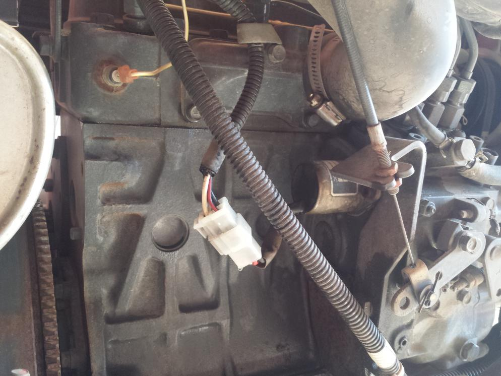

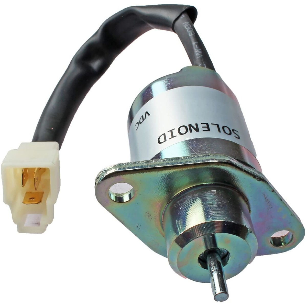

I think there are 2 coils in the fuel stop solenoid. One is energized while starting, and the other is energized while running). Could be the run coil is fubar.
The tractor should start and run with the solenoid removed.
I can pop that off(pretty easy overall) wasn't what I saw in the past. Usually it wouldn't even start to turn over. But, that will have to be tomorrow :)

Never had a fuel stop solenoid keep it from cranking over. Had it cough and not run but only thing that stopped the started was Starter Solenoid, starter or lack of power.

I did reach out to the Kubota Dealer and they seem to be leaning toward the ignition switch or a wiring issue as well. Also suggested the timer but doubted that and i hate throwing parts at something.
I'll probably trace wiring later today.

If the stop solenoid is removed and the starter spins over good, there is nothing electrical keeping it from running except the lift pump under the tractor providing fuel to the injector pump.
These things are simple, mechanical injection, no ignition, no ECM, nothing. If you have fuel to injector pump and compression it needs nothing else. If your stop solenoid sticks engaged (or you remove it) you can't shut the thing off electrically.....removing air or fuel is the only way to stop that little motor, well you can stall it with enough load.

Is the "fuel solonoid" near the start stop one?
   / BX2200 -- will almost start #29
$25 on Amazon or Ebay.
