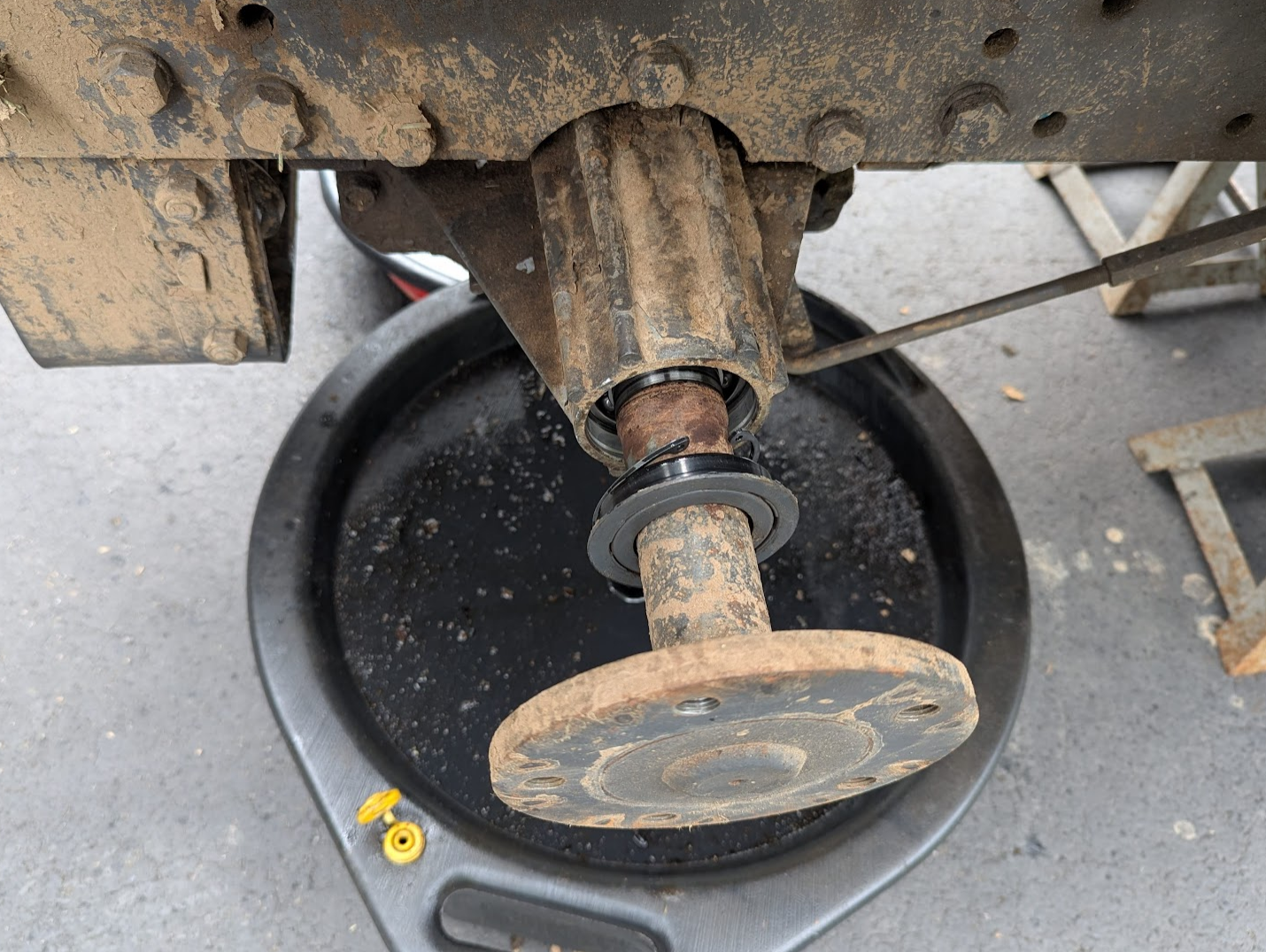

I replaced the seals and bearings yesterday, as well as doing full service (except the lash adjustment (not needed yet due to hours)).
Having a hydraulic press and adapters made effortless work of this task.
Took pretty much the entire tractor apart. Full days worth of work from start to finish.
My tractor no longer leaks and is a happy clean tractor once again. :cool:

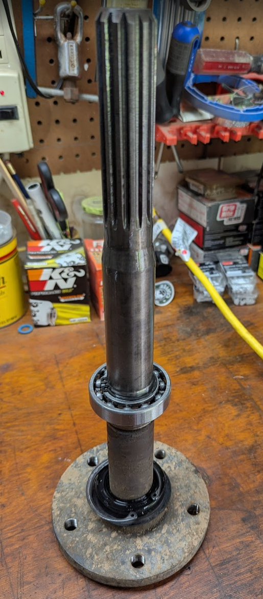

I know you all want to see pictures...
One of the axle shafts out with old bearing set and old seal:

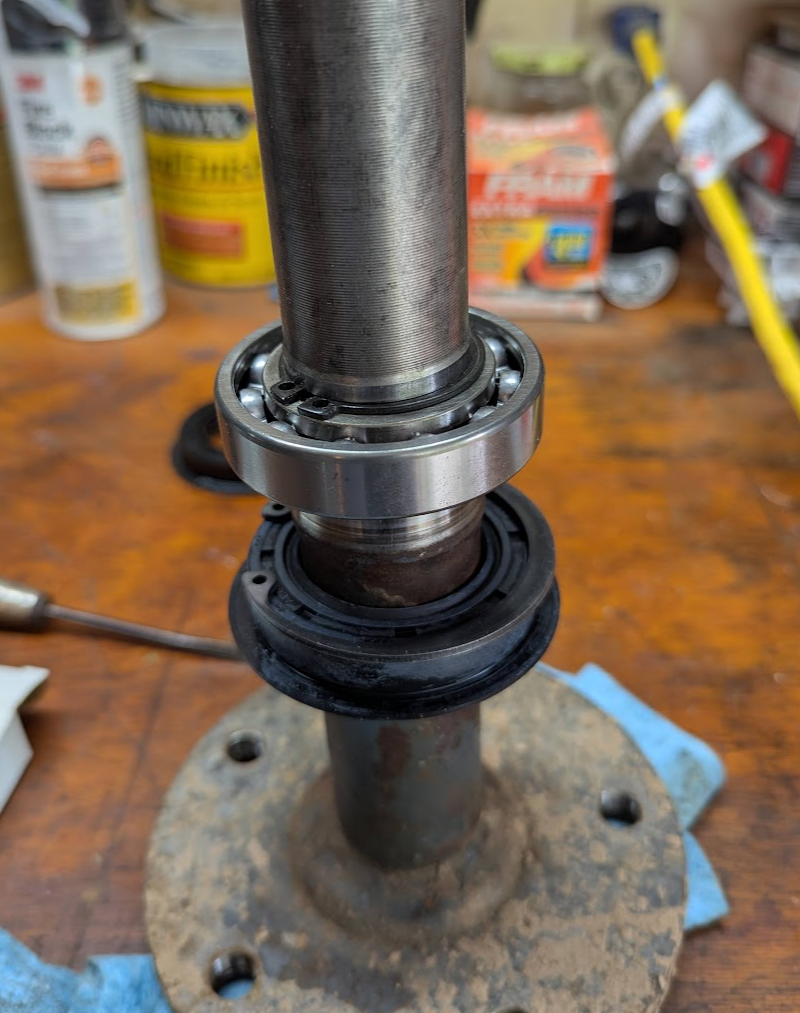

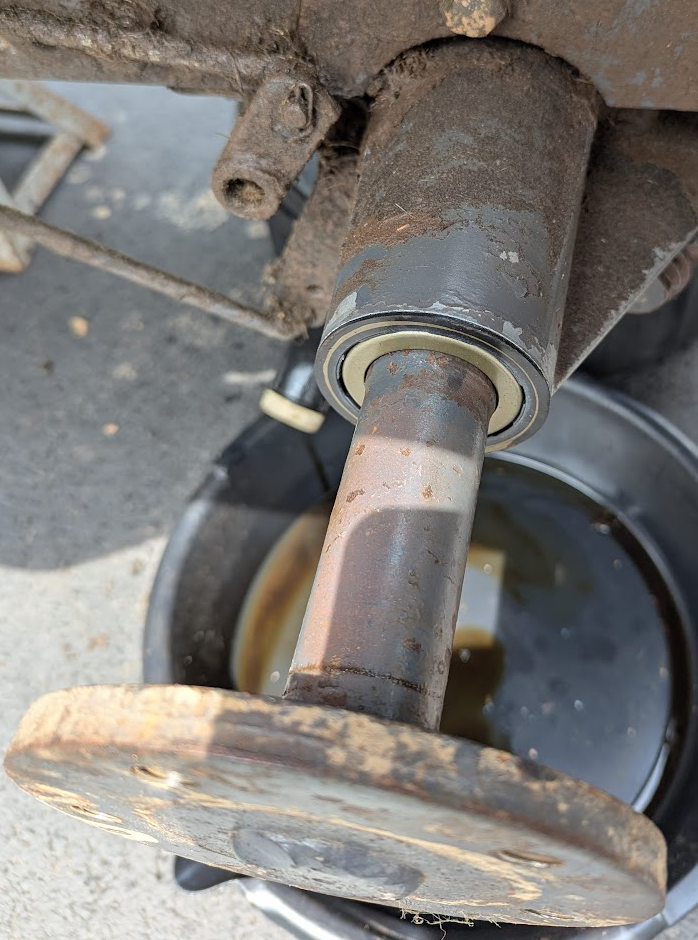

Initial removal of Jesus clip and seal:
Old bearing and seal removed off shaft:

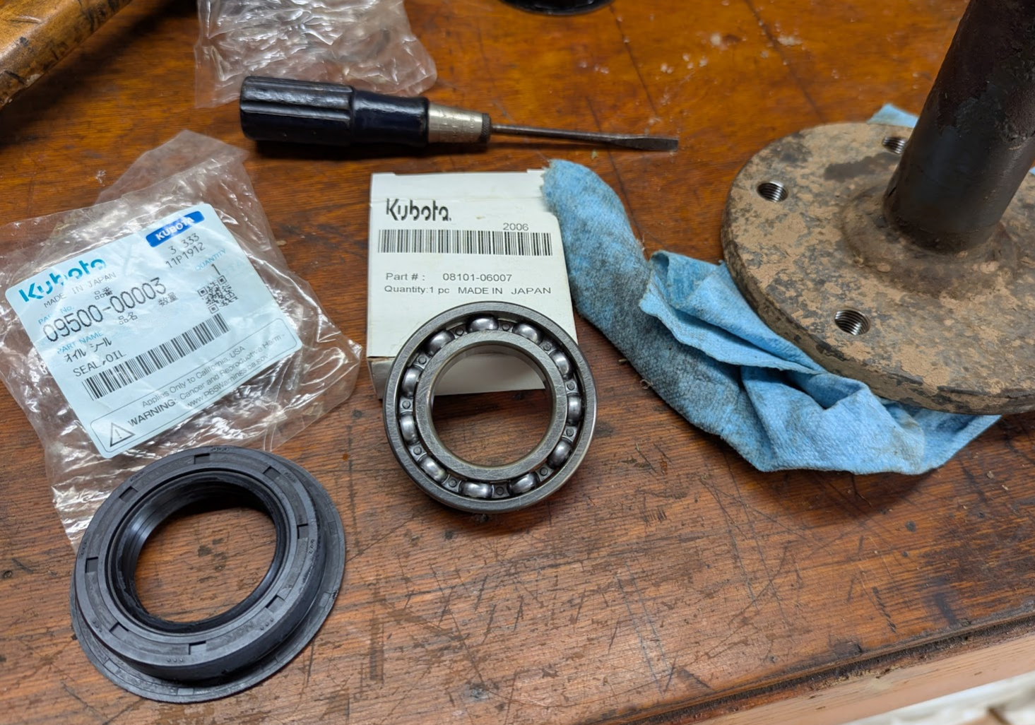

Part numbers for bearing and seal:

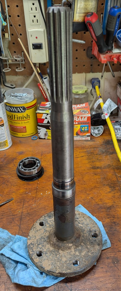

New bearing pressed on and new seal:

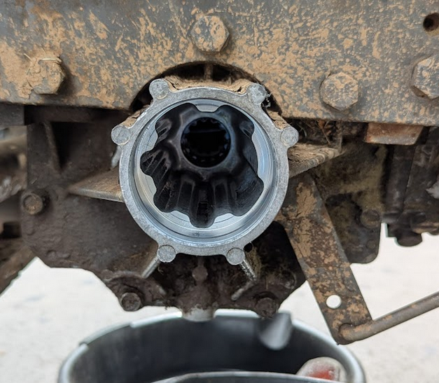

Cleaned out axle flange area:
Assembly reinserted and seal installed:

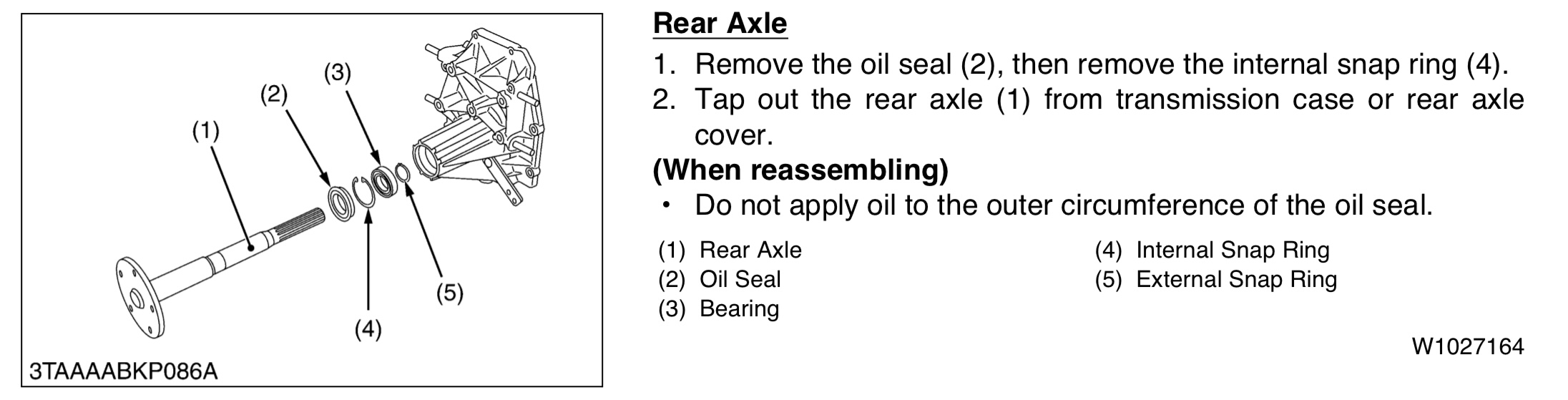

I was curious about how the axle came out if a seal needs replaced.
Seems you would pry out the seal, remove the external snap ring, then pull the axle/bearing combination out. Simple enough.
Of course the bearing has to come off in order to position the new seal on the axle shaft.
The axle seals came out easily with a plastic pry bar and a couple taps with my fist. They are in there about as hard as a wine cork. Literally, nothing to it.
Yep, exactly like you said. The two ways mention in this thread will work to get the bearing off. Heat/cold or hydraulic press methods.
I did one side at a time, as I'm not sure if anything inside the transmission would get disturbed or fall if I removed both axle shafts at the same time. Didn't want to chance any bad luck. No reason to remove both at the same time was my logic anyways.
