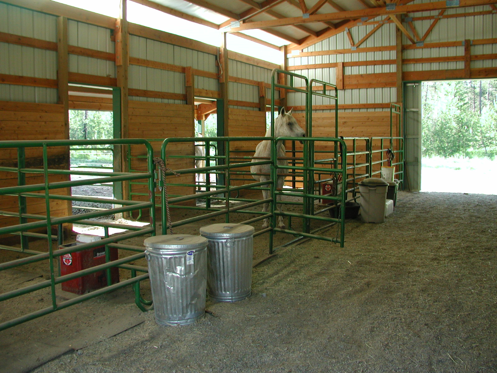

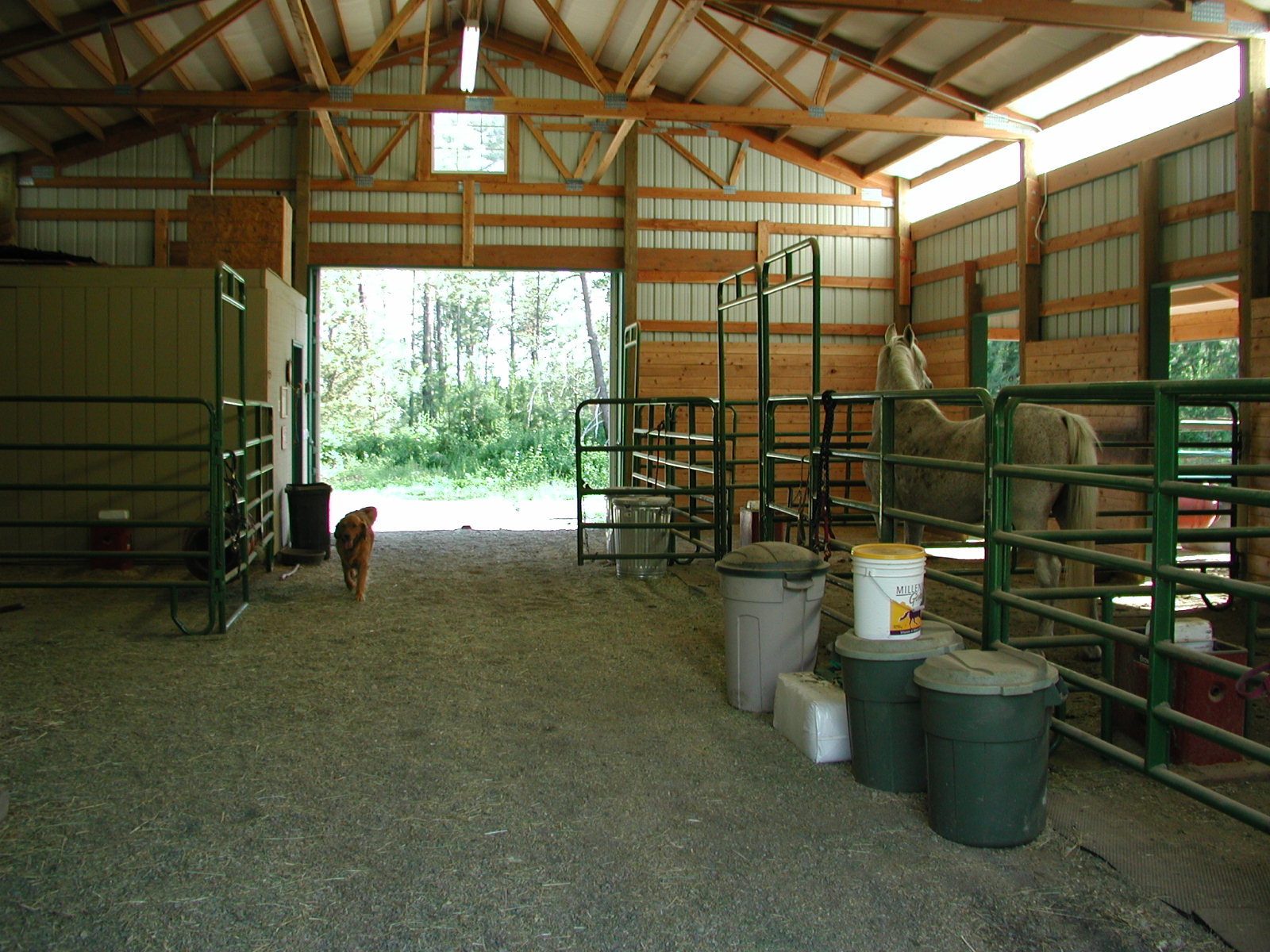

I have a 36 x 60 barn, peak of ceiling about 14-15 feet high. I used 5 - 8 foot long light fixtures along the peak and have plenty of light. I spaced mine so there was one fixture between each main truss. the double trusses are 12' on center. this places the lights as such. 2 foot space, 8 foot light, 4 foot space, 8 foot light, 4 foot space, 8 foot light, etc till i reach end.
as i said, plenty of light.
Now i have an open stall system. if you have solid stall walls 8 foot high, then your going to have to have something entirely different. me, i hate enclosed barns. i like the open feel. inbarn1.jpginbarn2.jpg
in the second pic you can see one of the lights.

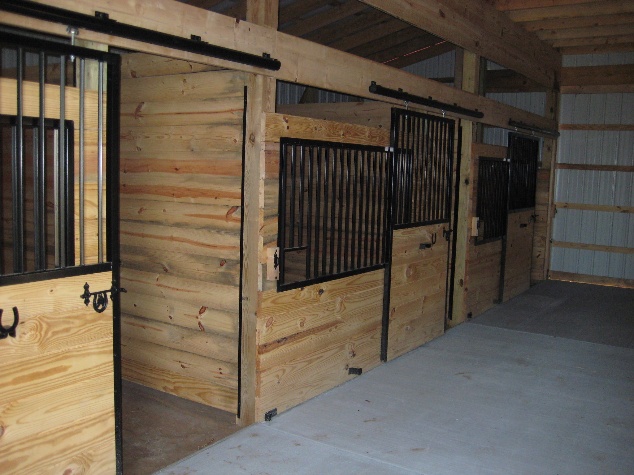

I went and looked at your pictures, and i can see that the large beam above each stall will block any general lighting you put in the walkway.
Since your barn is so split up with the partitions and beams, i really dont know how to run this scenerio in my software program. it cant adjust for shadowing.
I think you will have to install a separate fixture inside each stall as others have said. They do make florescent fixtures with full vapor proof wraps, and i have installed these in wash bays and in stalls where people are worried about dust. My lights are 16 years old....using original lamps. Have never been cleaned, and put out awesome light. http://www.homedepot.com/h_d1/N-5yc...keyword=florescent&storeId=10051#.URw8KlGxj7U
