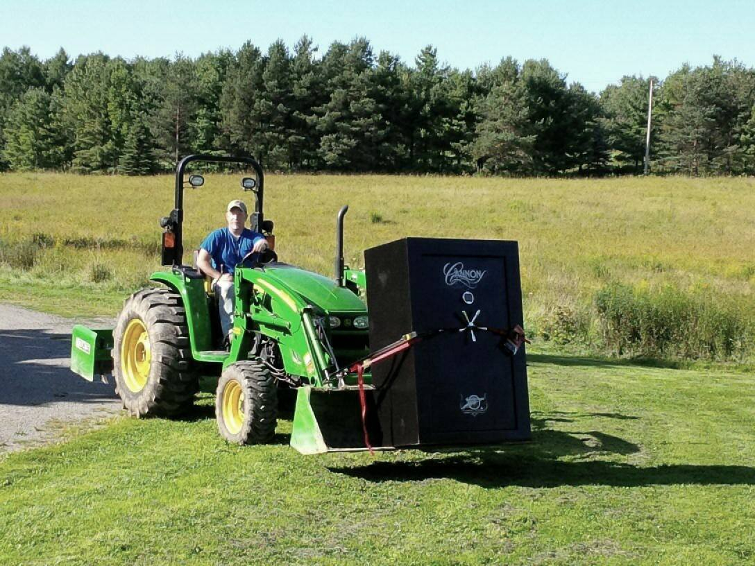

I hope I have the correct place for this question, if not I apologize. I am having a gun safe being delivered next week and have opted to lift it off the delivery truck myself to reduce the delivery cost (they won't have to bring a fork lift with them). I'll then need to position it in the garage I've built out for cars, motorhome, etc.
I have a cabbed JD 3046R with an H165 loader, and wondering two things.
First, will that the 3046R with H165 loader be able to lift it off a larger delivery truck ... safely?
Second, assuming it can lift it, should I attach a ballast box before unloading? I don't have one yet but will purchase one before if needed.
The shipping dimensions of the safe are listed as 63.33 H x 42.79 W x 28.00 D, and the weight is around 750 lbs.

Thanks to all for the reply’s. I do have forks which will be used. I also forgot to mention the rear tires have fluid in them. For the lift I’ll attach a rotary cutter to the 3ph. As suggested, I’ll lift and have truck drive out from under.

Using forks? Some subcompacts can lift that off. Yes use ballast on your 3x series if you have access. Even an implement would help. You only have to raise it a little then curl back a little. More capacity curling than lifting.

You should have zero problems. I use my grader blade with suitcase weights on it in a pinch. I have loaded rear tires as most people do.

Like most say, put some weight on the rear 3 point, box blade. mower, etc. But it should handle the load. Back away from the truck slowly and lower it gently till just enough above ground to proceed to drop off area, slowly. I found that borrowing a portable pallet jack worked fine to move the gun safe around in the house to get it where I wanted it.

I would also suggest that you strap the safe to the back of the bucket before moving! Things can get tippy.
/ Lifting safe - Ballast Box needed? #76
Reply #25, says he has forks. Straps still are a good idea.

Taking the safe off of the trailer ended going smoother than I thought It would. First slide forks under and lifted off the trailer bed, without backing up. There were a lot of other materials on the trailer so couldn’t have him drive out from under the lifted safe. Was very smooth, no feeling of tipping. Backed up very slowly to get clear of the bed and put just about on the ground. Slow pace into the garage was also very smooth.
I strapped myself in, always do even since darn near tipped it. Did air up tires, they were pretty low. Took it slow … no problems. The only thing I didn’t do that I should have, was to strap the load in. No issues, but will make sure and do that next time.
