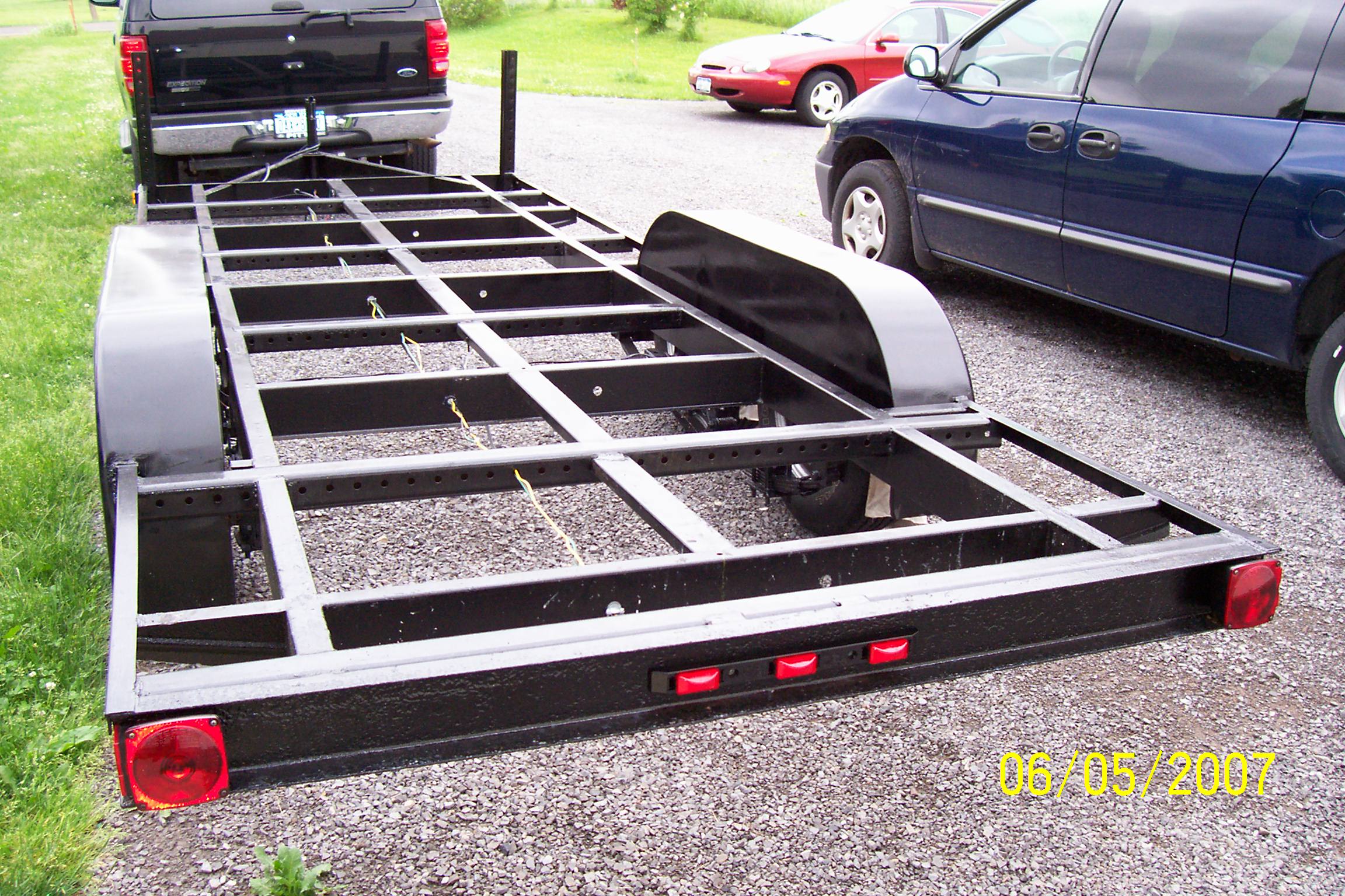

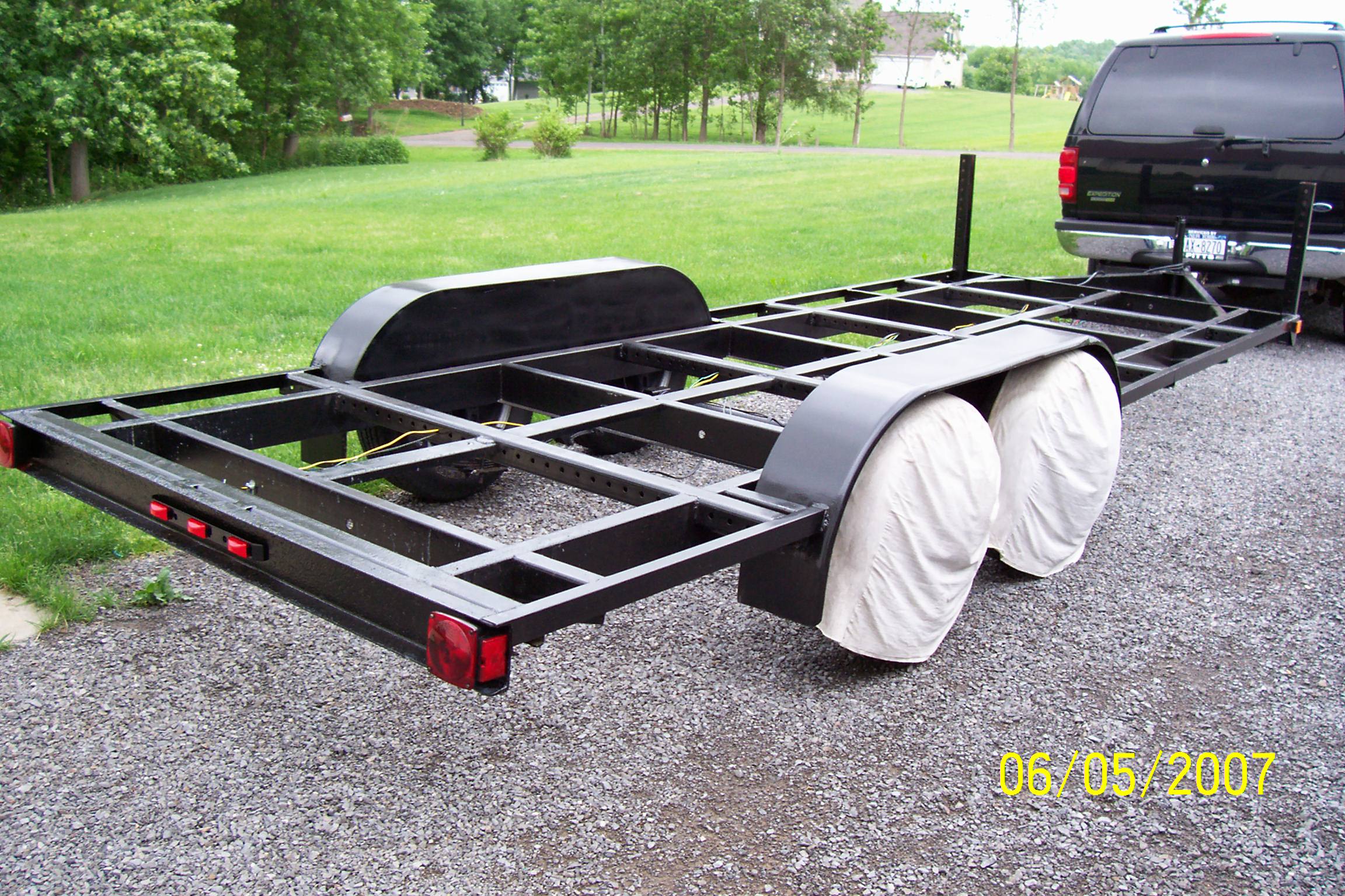

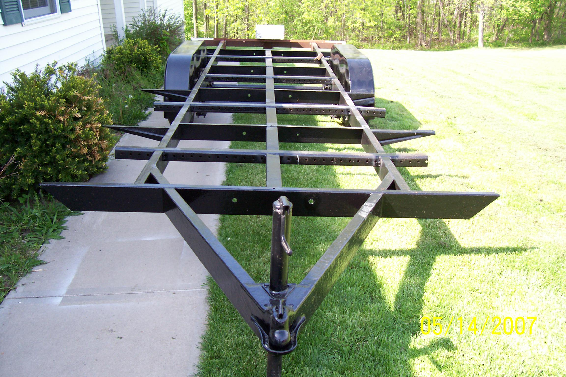

Has anyone from NYS experienced getting a homemade trailer over a 1000# licensed ? I stripped a camper trailer off the frame and put on a deck, it is a 6x16 tandem axle w/elec. brakes now I need to get it on the road. I know the state needs to inspect it also the DOT. Iam close to Rochester. I have called DMV but as always, thats like pulling teeth to get an answer, where do I go for the DOT inspection. I will post my pics when I get a chance.

Nice trailer. How much weight do you plan on hauling? The reason I ask is because without the camper on it how rigid is the frame? I don't know if that may cause you any problems with the DMV.

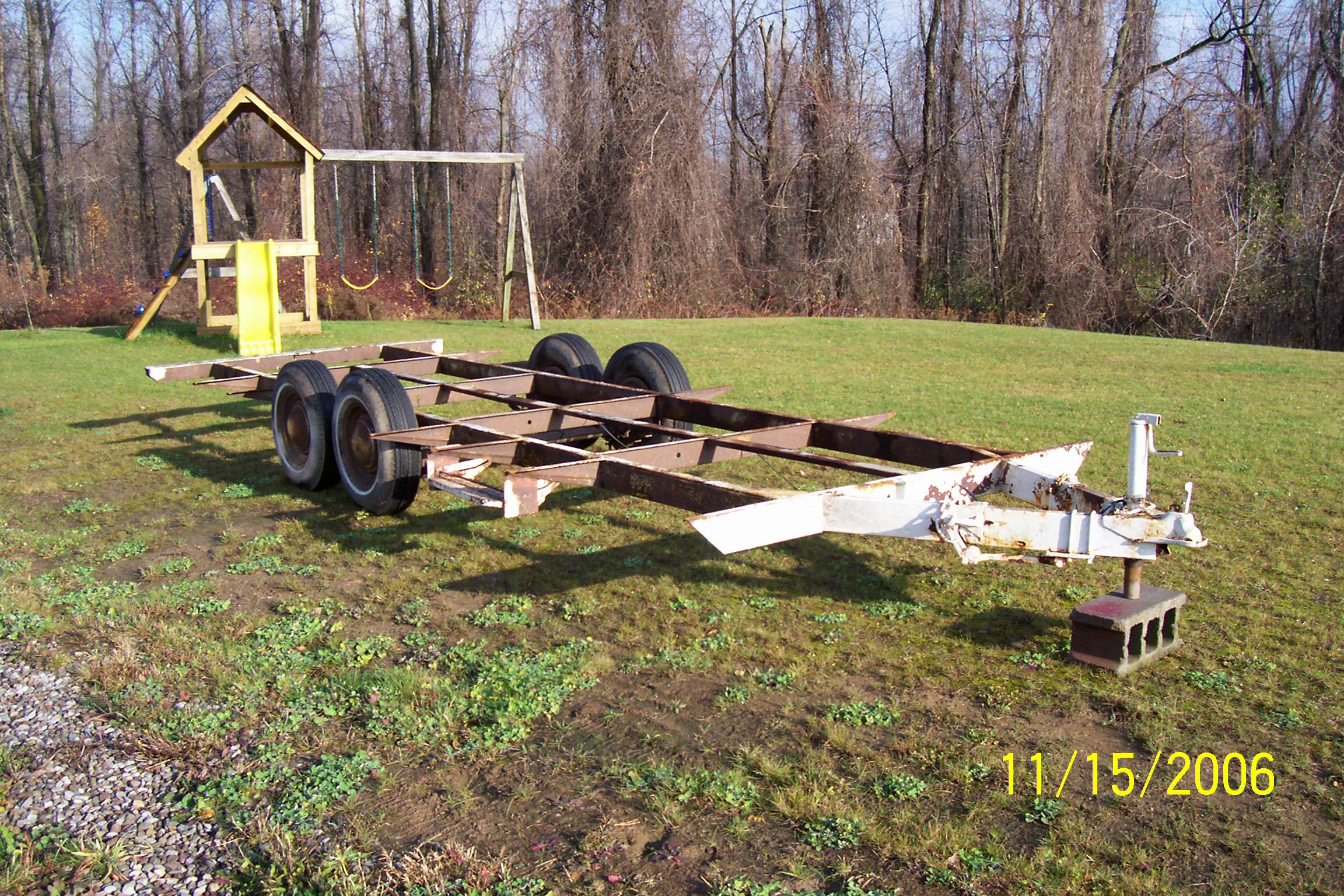

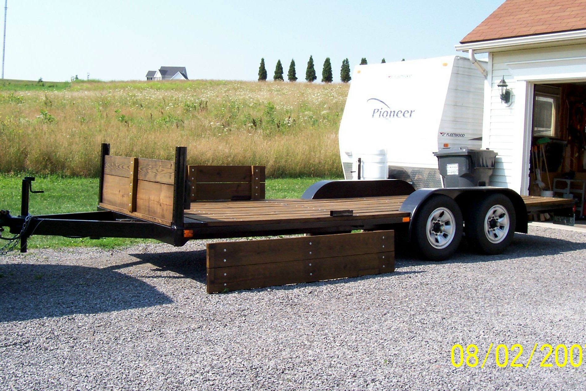

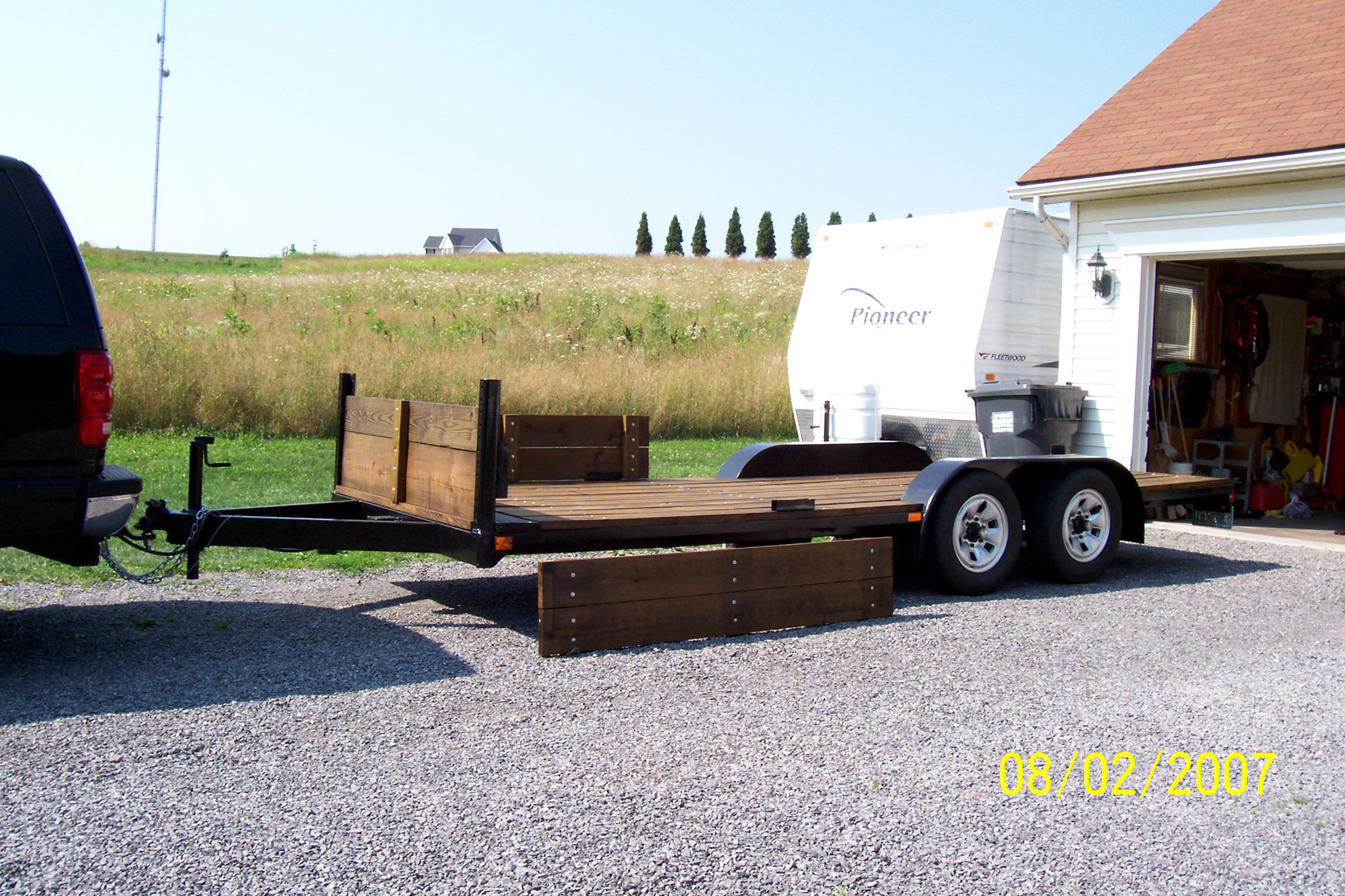

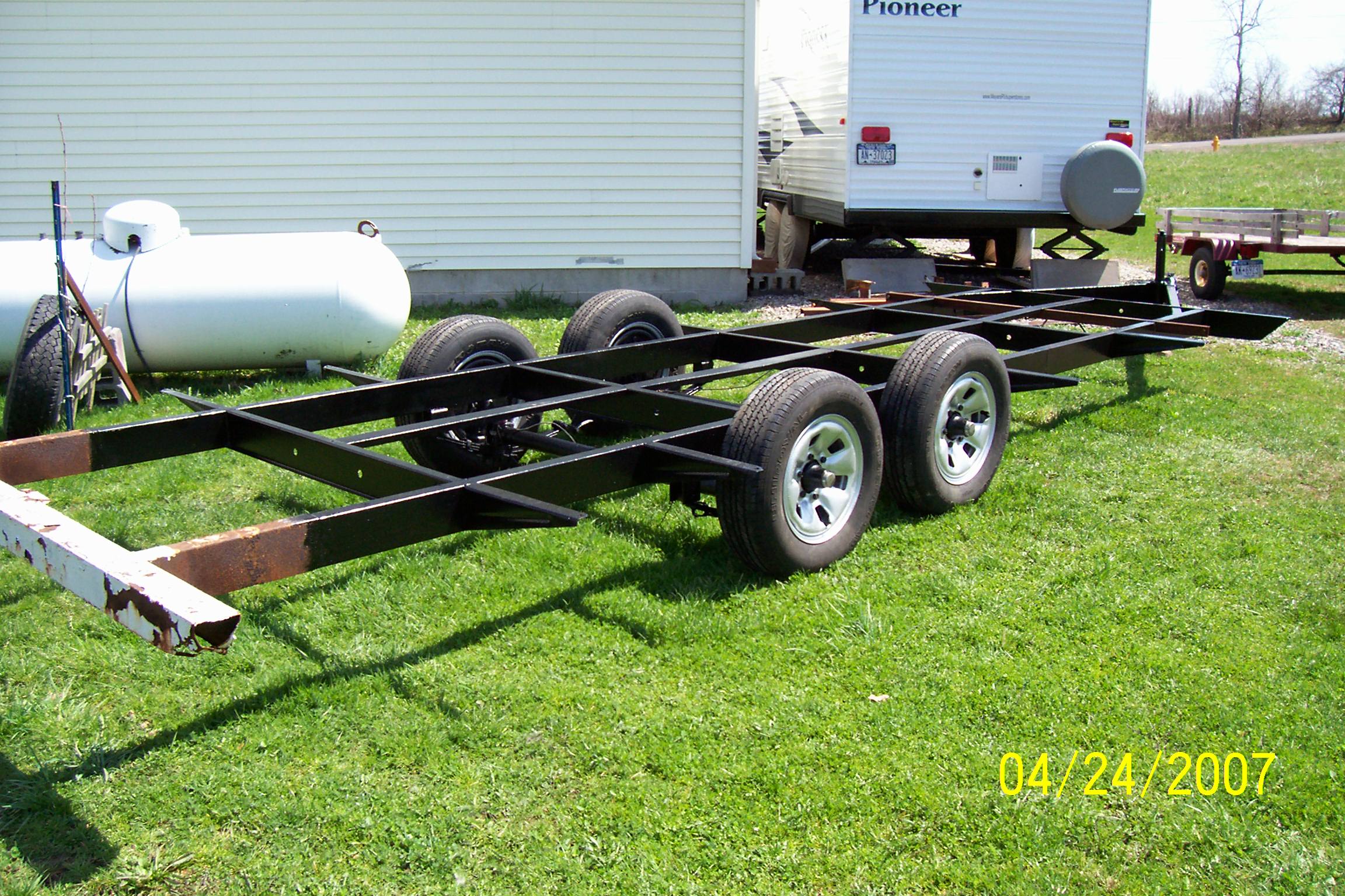

Thanks for the responses, the NYS link was a big help, it appears that the state DOT issues me a VIN# after they inspect it. Heres some pics of the project, I stripped the frame and added supports. The most I had on it was my Kioti tractor with FEL and box blade. I would quess all of 3000# took it down the road with no problems. Now to get it legal.

Not in NY Brian, just by changing the intended use of the trailer (camper to utility) also changes weight, the state sees it as a new build. That was my thought when I started the project. Now I am finding that I need to show receipts for materials and any add ons including the paint I use.

Excellent! You shouldn't have any trouble with the design or workmanship, you just gotta find the right person to talk to at the DMV.

1) My local DMV was helpful and told me I had to go through Albany for an application for title and gave me Ph# to call. I called Albany and told them I was building a homemade trailer and was going to register it for 6K even though I was using 2 6K axles. They sent me an application.
2) Once built I had to make copies of all materials purchased showing I paid sales tax. If not they will make you pay sales tax based on their estimate. Also had to go have it weighed empty and get a certified copy of the weigh slip to send in with application. The local dump has a certified scale and didn't charge me to weigh it.
3) Send application with copies showing you paid sales tax on materials (mainly axles, tires and steel I bought) and the fee (I think it was $25.00 at the time) and weigh slip to Albany. I know title fees have gone up now. $50 just for title.
4) Albany scheduled an appointment to take trailer to DMV to inspect. (My closest office for this was on Taft Rd. Syracuse) The inspector checked my frame and welds, tires, lights, and a brake test, Then affixed a VIN# decal to my frame.
A few weeks later I got a title for the trailer showing it as a custom built.
I don't think I would do it again since it is a hassle and time consuming.
Out of curiousity, don't you have a title / registration for the camper you stripped? Or if not get a pencil tracing of the VIN on the frame and apply for a lost title / registration. It would be much easier doing that.
By the way you did a great job converting from your pics.

I'm gonna guess that the one in the background is your next project and will also be torn down into another tractor-haulin trailer ??? ;)
