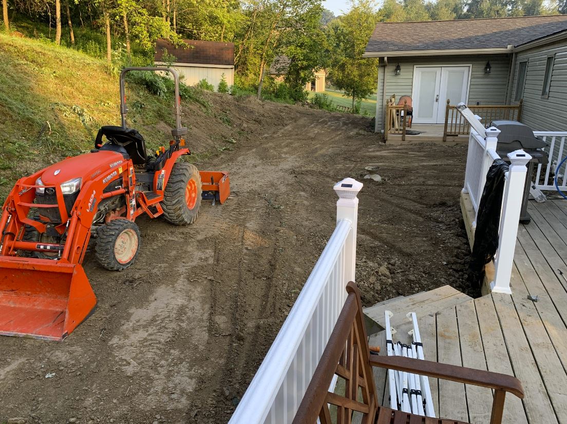

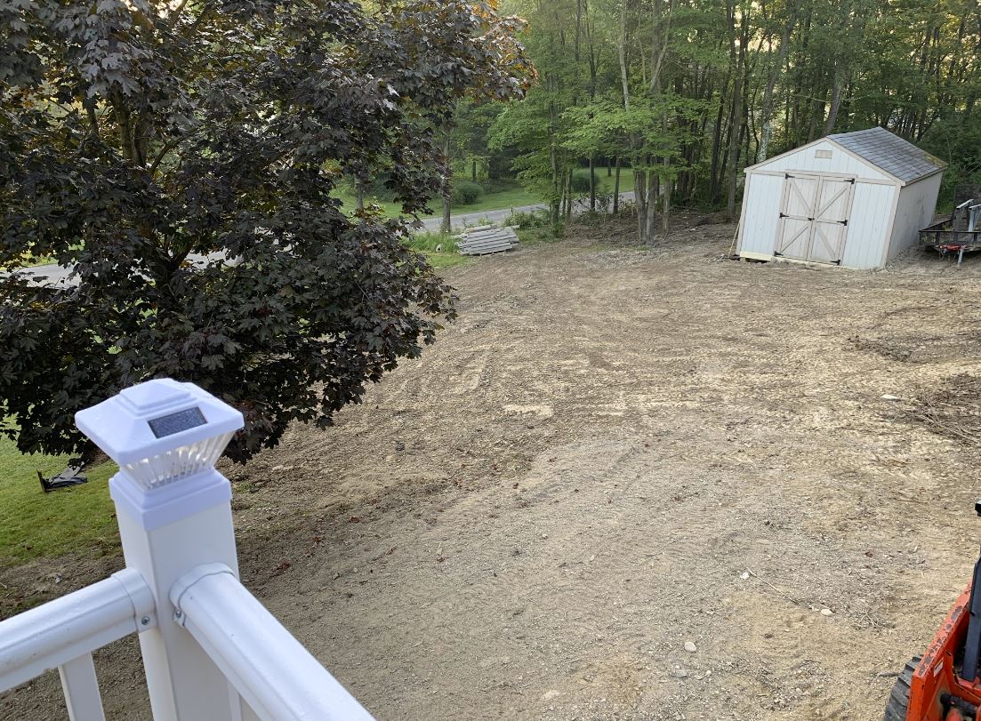

I relandscaped my side and back yard and have it close to almost finished. I am waiting for september to plant grass seed. I will need to purchase at least 4 tandem truckloads of topsoil. I am going to get the screened topsoil and have mushroom mulch mixed in, like a 50/50 mix. What would be the best way to spread this so I would have very little hand spreading to do? I have a box blade, but though about getting a 3 point landscape read to help level it off.
I will initially spread the topsoil out using the fel and get it somewhat leveled off, but once it is spread, what could I use for the final leveling off? Also, since most of the yard is on a grade, what would be good to use to cover the grass seed to keep it in place until it grows? I have straw, but if it rains really good, I don't know how well that will hold the seed from floating away.

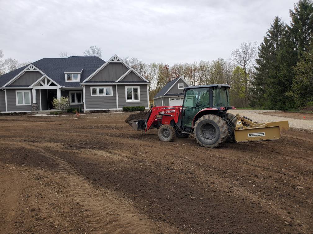

A LPGS (land plane) works excellent for good fresh topsoil. Especially with a hydraulic toplink so you can adjust the pitch on-the-fly.
I do a lot of this work with my landscape company (topsoil prep for sod/seed) and if the material is dry, and there's adequate space for a tractor to move around, the LPGS works wonders.

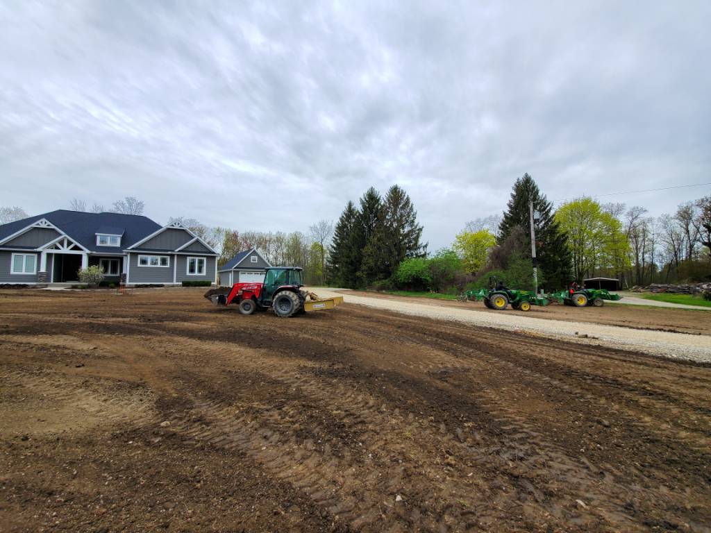

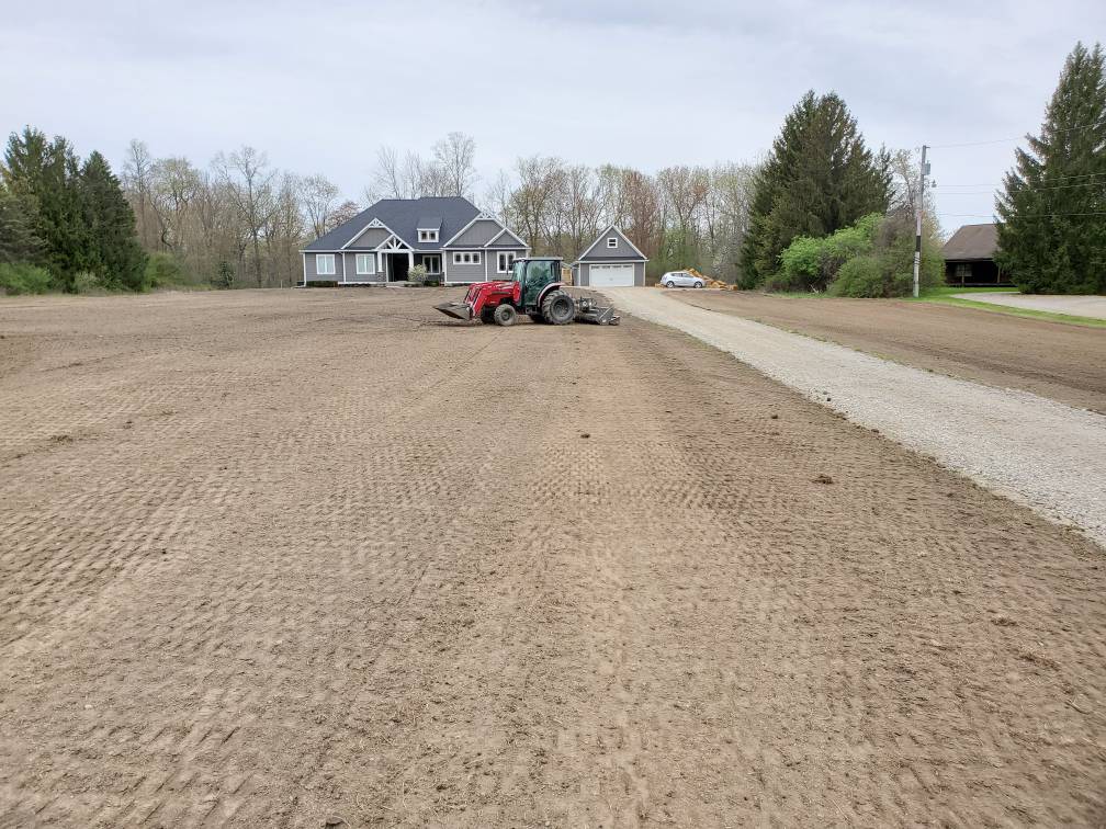

Perfect way to finish it after that is with a Landscape Tiller (ATI Preseeder is what I use). Very expensive tool ($12k) but the finished product is very nice.20190511_105822.jpeg20190511_105832.jpeg20190511_170837.jpeg

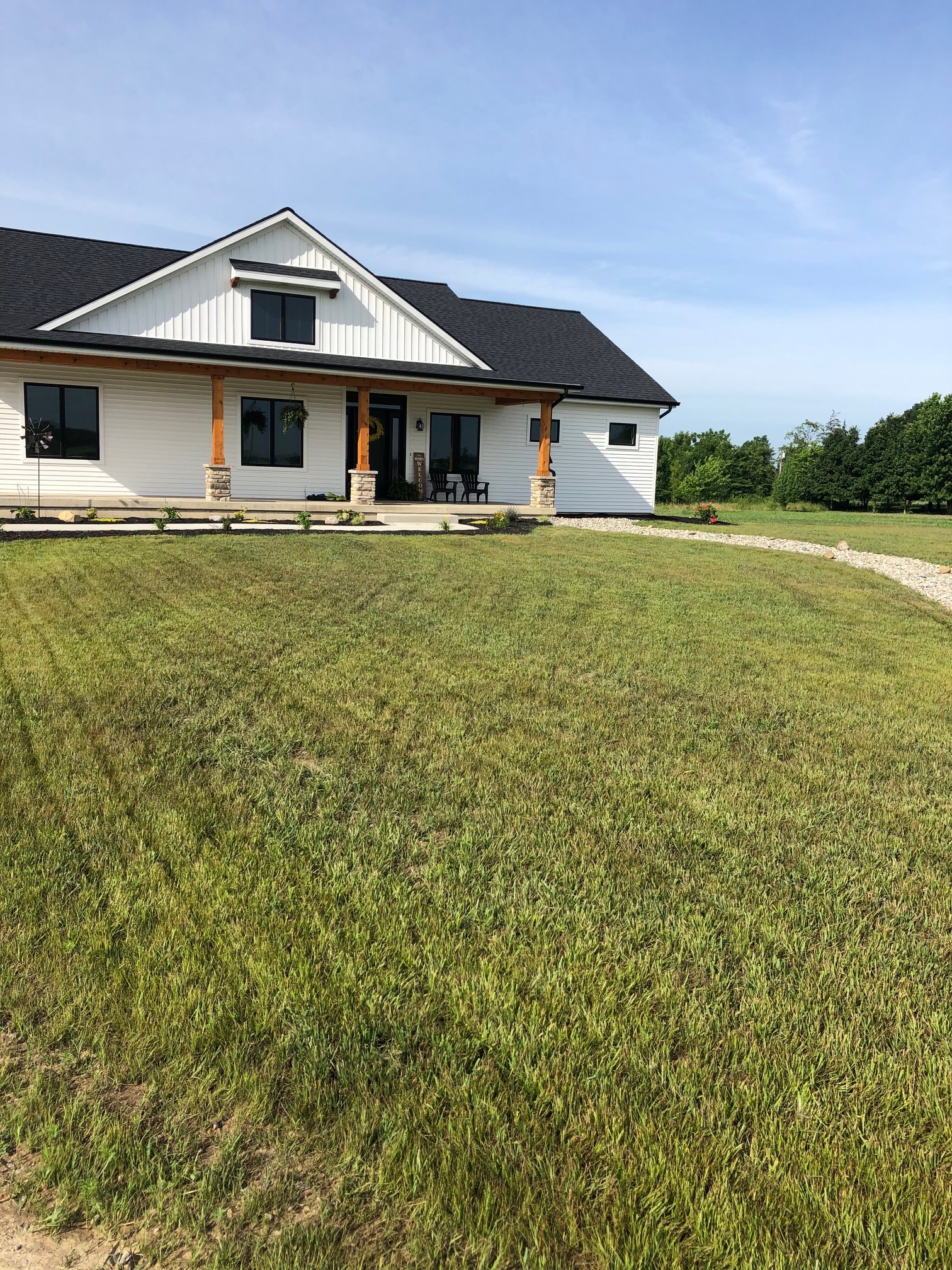

This past spring when our house was finished, I went through the entire discovery phase of how to finish grade, level, spread topsoil, and then plant grass. I ended up buying a used Land Pride Pulverizer. I used it to smooth out the rough grade, and then added a layer of topsoil. The teeth did a nice job of mixing, and the weight and the fact that the pulverizer is made on steel I-Beam makes leveling effortless. I overseeded this area, and hit it again with the pulverizer to bury, and then firm the soil (roller with spikes on the back). Since it was basically drilled in, I did not need straw. Yard turned out nice.

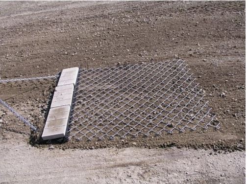

Since the topsoil will already be screened, I wonder if this drag harrow would work if I can get the topsoil down well with the fel.
Easy to build with a section of chain link and a bar across the front and back

Chain link with bar front and rear works good for final level if you can keep some weight on top for downward pressure. Have also used a heavy oak pallet rightside up to start and upside down to finish pulled by an atv for maneuverability . An old partial piece of steel spike tooth harrow also works good with some concrete blocks on top removing blocks as level is achieved.
