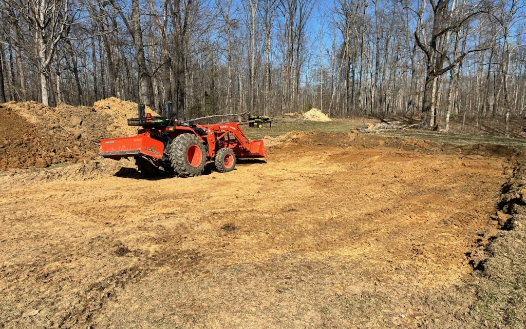

So help me out guys. I have a pool to finish installing that I never got completed last year and the miss is on me to get it finished this year. The pool itself measures 21’x43’ and need about 3' outside of that, and it needs to be leveled within +-1”. I have cut down into the ground about 30” but I still am not within this 1” requirement and having a hard time getting this large area leveled. So tell me all the clever ways you all would use to level out this large area. I am a one man show for the most part.

Use the dirt behind the tractor to raise up the low sections, compact it in small lifts. Do you have a laser level?

Yeah I do have a laser level. Maybe building up instead of cutting down is the better way. I am all ears for sure.

Need to establish the desired elevation you're trying to achieve and then work in both directions toward that point. What if you get this area leveled and then realize you're several inches or a foot below where you'd actually like the pool elevataion?

That's not an issue, I am not trying to achieve a certain height above the ground. At least not enough that a foot either way will matter much. I have it leveled really close now but having a very hard time getting it within an inch. I am thinking there is no other way than using a shovel.

I have set grade pegs on the few pads I have worked. Usually about 6-8 foot grid. They limit the movement of the tractor, but seem to allow "cut and fill" operations to get along more quickly.

Agree with CalG - set some 24" long grade stakes around the 24x48 area every 12' max, then several down the center of area - then a lobster claw rubber band (colored rubber band) around the post.
Using the line level and a 14 straight edge like a 1x4 you should be able to determine your high points and get it close.
Using sand is easier once you get it close then tamping will change it too.

I like the grade marker idea really well. I had used paint to mark the grade after shooting with the laser but that quickly wore off and found myself constantly re-shooting. Once I get it level, I then have 16 "L" shaped posts (8 on each side), and the foot of each post which is about 36" long and 2" thick, have to be recessed under the surface. So I then have to dig and level each one of those. This all has been a nightmare for one guy to do.

I think it is hard to grade to within an inch. They used to make aluminum rakes that were 3 or 4 feet wide. That might be an option to get the soil leveled to final grade by hand. Not being compacted, it may settle.

I thought most above ground pools were built on a sand base. If that's the case, I'd make sure the remaining high point was at least an inch or two below the desired finished elevation. Then I'd set up screeds, bring in the sand and screed it off. With the screeds set parallel to the long side at 8' centers, you could get by with setting the first one so a 12' 2x4 would do the first 8' swath plus the part of the 2x4 that hangs beyond the first section could level the extra 3' beyond.

the legs sit directly on the earth, the sand base goes inside the walls under the liner. And the directions state to not build up to elevation, but to cut down to elevation so that you have firmly compacted earth under the legs. And a perfectly straight 2x4 is about all I could come up with for leveling such a wide area. I really do like the grade stakes to help with cutting. I am now looking into one of those aluminum 36" rakes to help moving material. I think I could wet the ground a bit to help in making it easier to cut.

Use your laser to set grade stakes about every 10 ft through the area, with a clear, dark line. Will help to see what needs done. It also makes it pretty easy to pull the string from stake to stake. My preference is put C-1 stakes; IE the line is 12" above the desired grade, and then you pull a string from C-1 to the other C-1, and measure down to grade. That way the string isn't riding the dirt.
Once you get it all within 3"; sprinkle dirt a bit at a time in low areas. To get +/- 1", you will need to do some rake and shovel work too,

A Lute Rake, most often used for asphalt, works well. The proper name is "Lute" but its often said "loop" rake. Magnesium head, flat on back, small teeth on front, and you use both sides. Works well with asphalt and sand;

When we built our in ground pool a company came and did the final grading. I cut it down close with my BX with the FEL. They finished it mostly by hand. I’m a land surveyor and borrowed an optical level and as a recall just painted cuts on the dirt. Lath are good for it but don’t put in to many they get in the way.
With ours they put the liner on the dirt. They were very careful to get every little twig or lump picked up because you feel every defect through the liner. They didn’t want sand since it can contain rocks and poke holes. If you can get a very pure sugar sand that’s fine.

I have had the "vevor" style landscape rake for 20 years - was $100 or so when I got it back then - still using today to level sand / topsoil etc.
To move dirt with this rake it needs to be loose soil before compaction - if you can get the area farily level, install the legs then rake and grade with the loose stuff, compact then raise the legs a bit as you need too.

I went back and reread, and didn't see the answer. Are we talking a semi permanent, above ground pool, a non permanent above ground pool, a fiber glass precast inground, a partially inground semi permanent, or a full on concrete in ground pool?
Reason I ask; if we are grading to +/- 1"; that sounds like an above ground with a liner. For that, honestly, I would get everything close, and then use a sand or stone dust type material to get it "right". That red clay isn't going to rake well, and is going to be a beast to fine grade.
If it's even a partial UG pool; the deck area will be heavy disturbed in the process, and +/- 3" would be fine until it's time to form/pour the deck.
