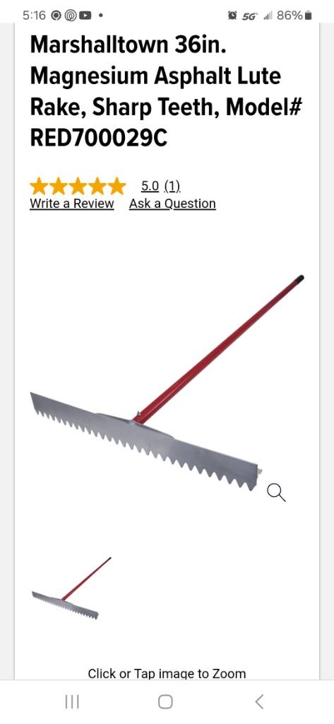

A Lute Rake, most often used for asphalt, works well. The proper name is "Lute" but its often said "loop" rake. Magnesium head, flat on back, small teeth on front, and you use both sides. Works well with asphalt and sand;
   / Best way to level a large area? #16
On the rake; a proper asphalt Lute is pretty pricey. On the other hand, Vevor has this 36" aluminum landscape rake for pretty cheap.

I have had the "vevor" style landscape rake for 20 years - was $100 or so when I got it back then - still using today to level sand / topsoil etc.
To move dirt with this rake it needs to be loose soil before compaction - if you can get the area farily level, install the legs then rake and grade with the loose stuff, compact then raise the legs a bit as you need too.
