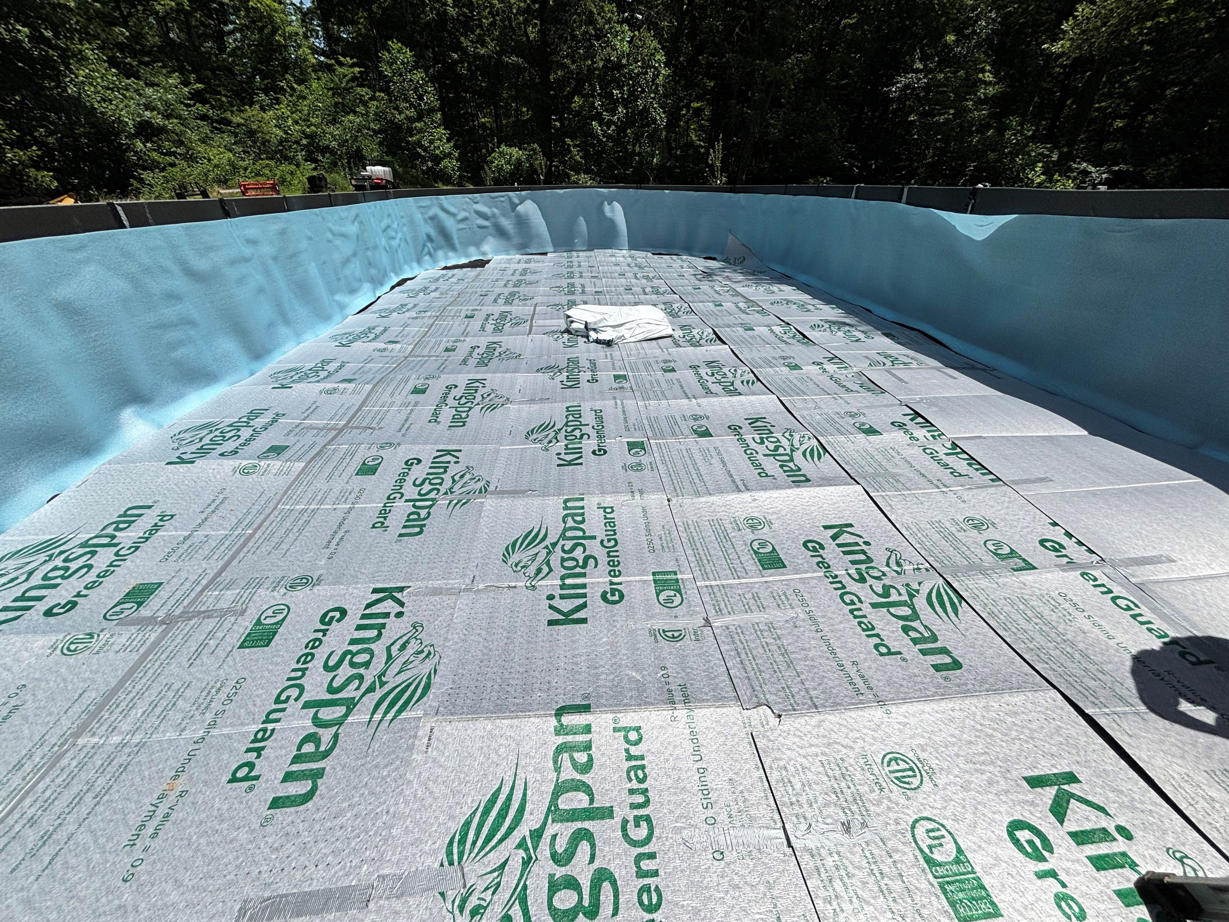

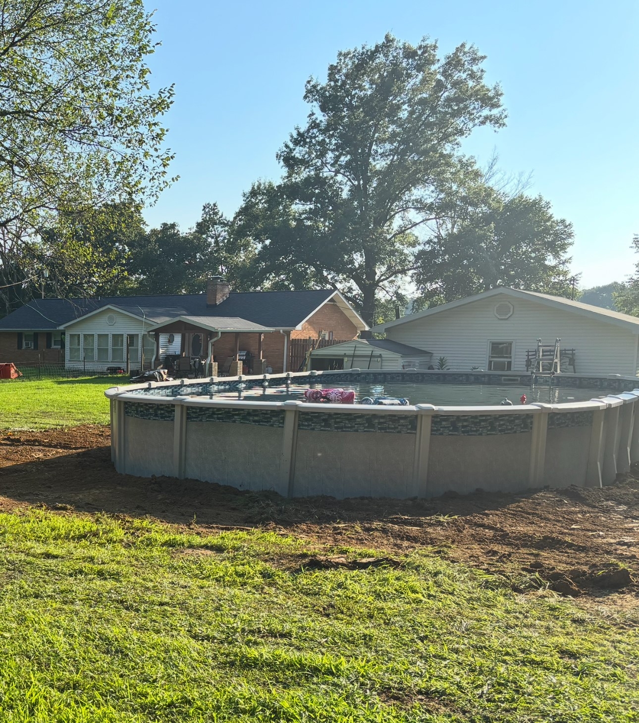

Don't overthink this. The only thing that really needs to be level is the perimeter where the side posts are placed. The center or ends are often dug deeper to make a deeper pool for diving.
   / Best way to level a large area?
#35
I have metal straps that attach to one side of the pool and go to the other side of it. The rounded ends of the pool don't have these so leveling there isn't critical and is the only place I could create a "deep end".
