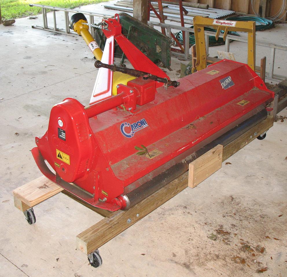

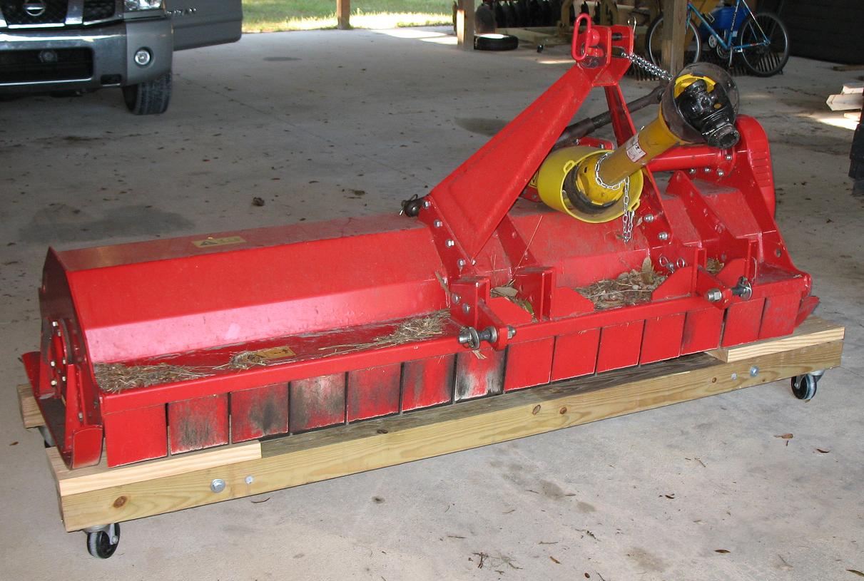

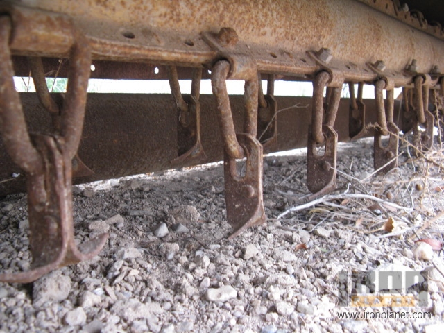

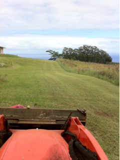

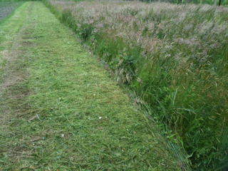

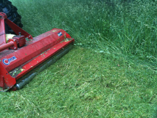

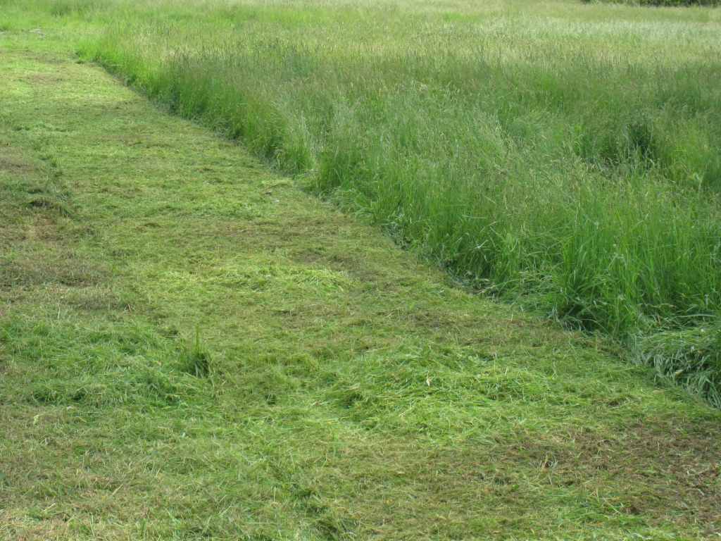

The Caroni should be fine for your acreage even with long intervals between mowing. It won't leave the land looking like a golf course but it is much better than what a bush hog does. I mow typically every 6-8 weeks and in some areas just once a year. Just don't mow when it is wet. I'll repost a few photos showing what it looks like below.
If you are used to maintenance free bush hogs you will need to readjust however. Greasing of bearings (2 minutes) each day and periodic replacement of drive belts (about $50 every few seasons) are routine maintenance requirements. Blade replacement intervals will depend on how many obstructions you hit. Some guys seem to go forever without needing blade maintenance when mowing pastures. Others, myself included, mow in rocky areas and I probably replace about one set of two blades and clevis every four or five acres mown. If you have read through the whole 1947 posts before yours, you are probably aware that the Caroni supplied clevises used to hold blades are not as durable as those sold by Flailmaster (but which require minor modification to fit).
Based on my experience, the Caroni will certainly fix your problem with clumping. I would probably still use the bush hog to do first cutting of the 10 acres of thicket even though the flail can do that work too simply to save on broken clevises/blades.

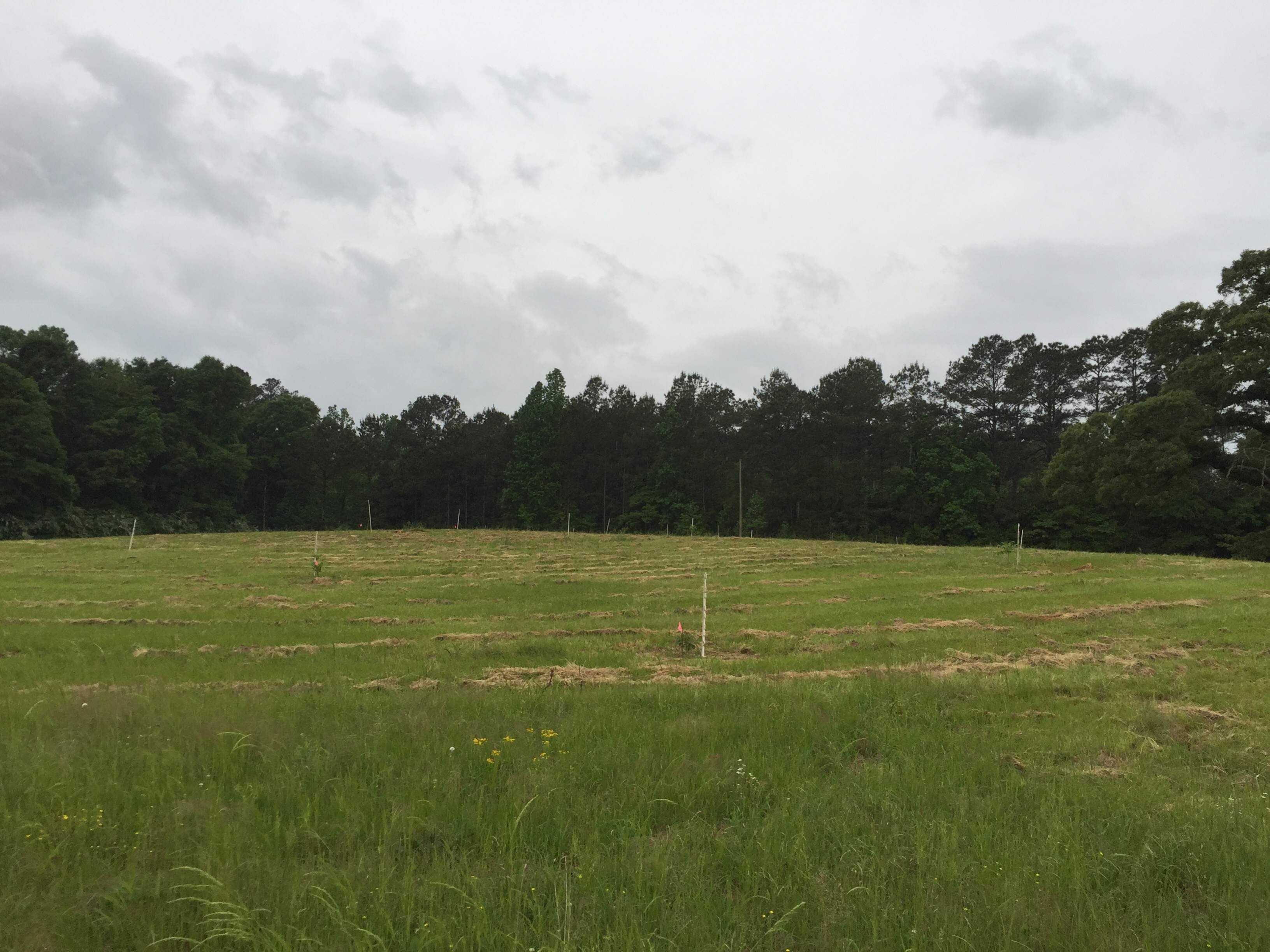

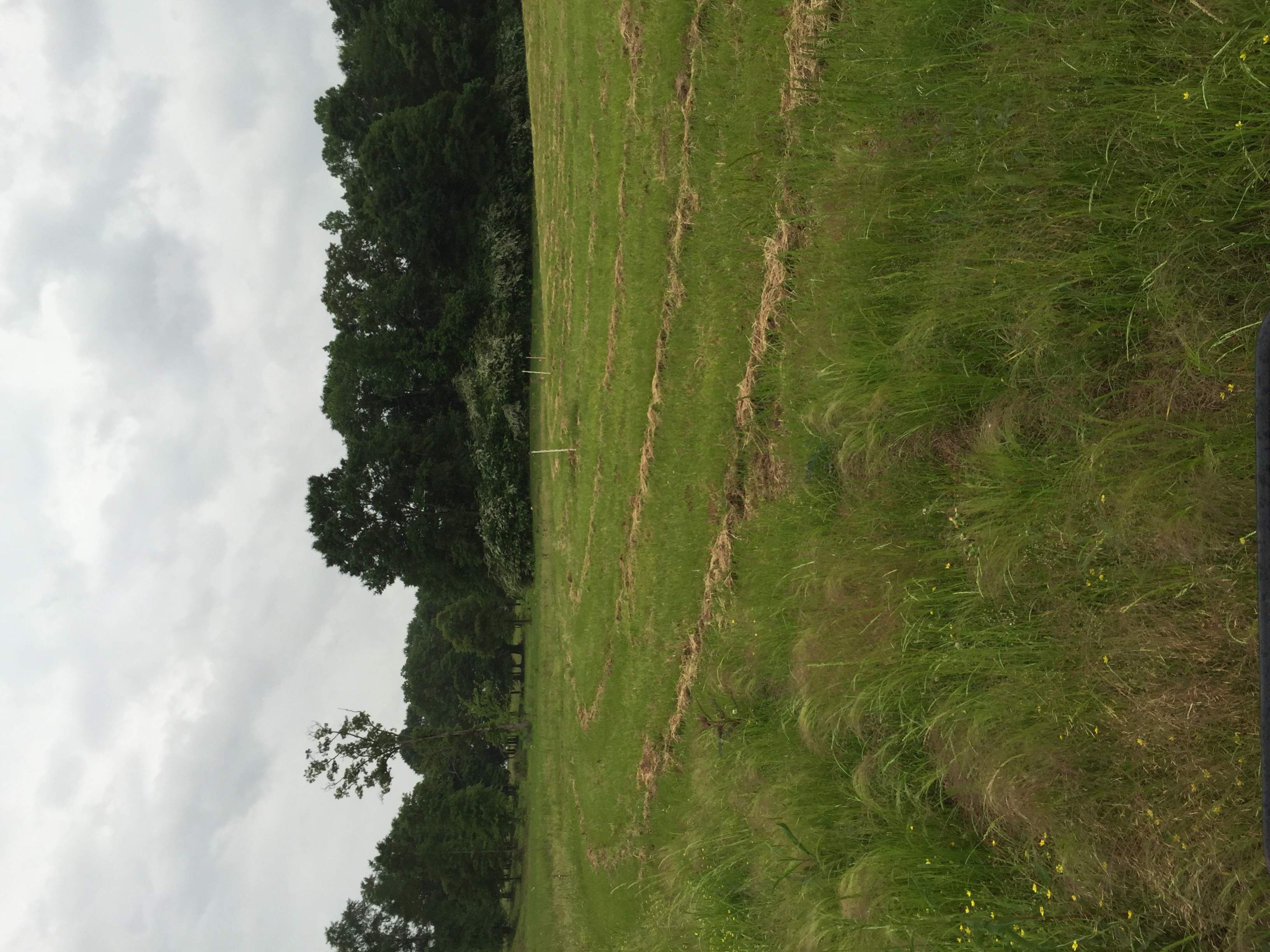

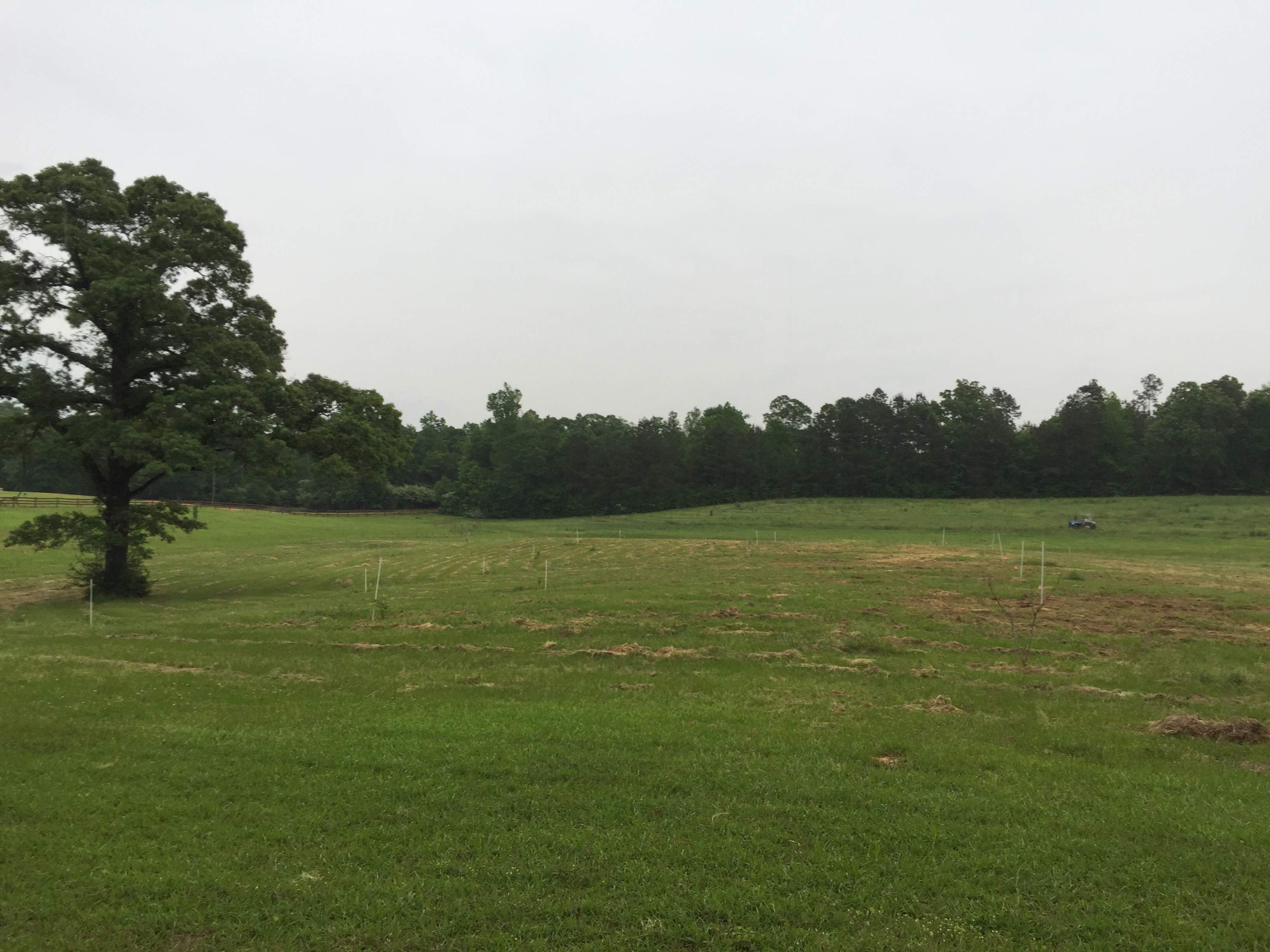

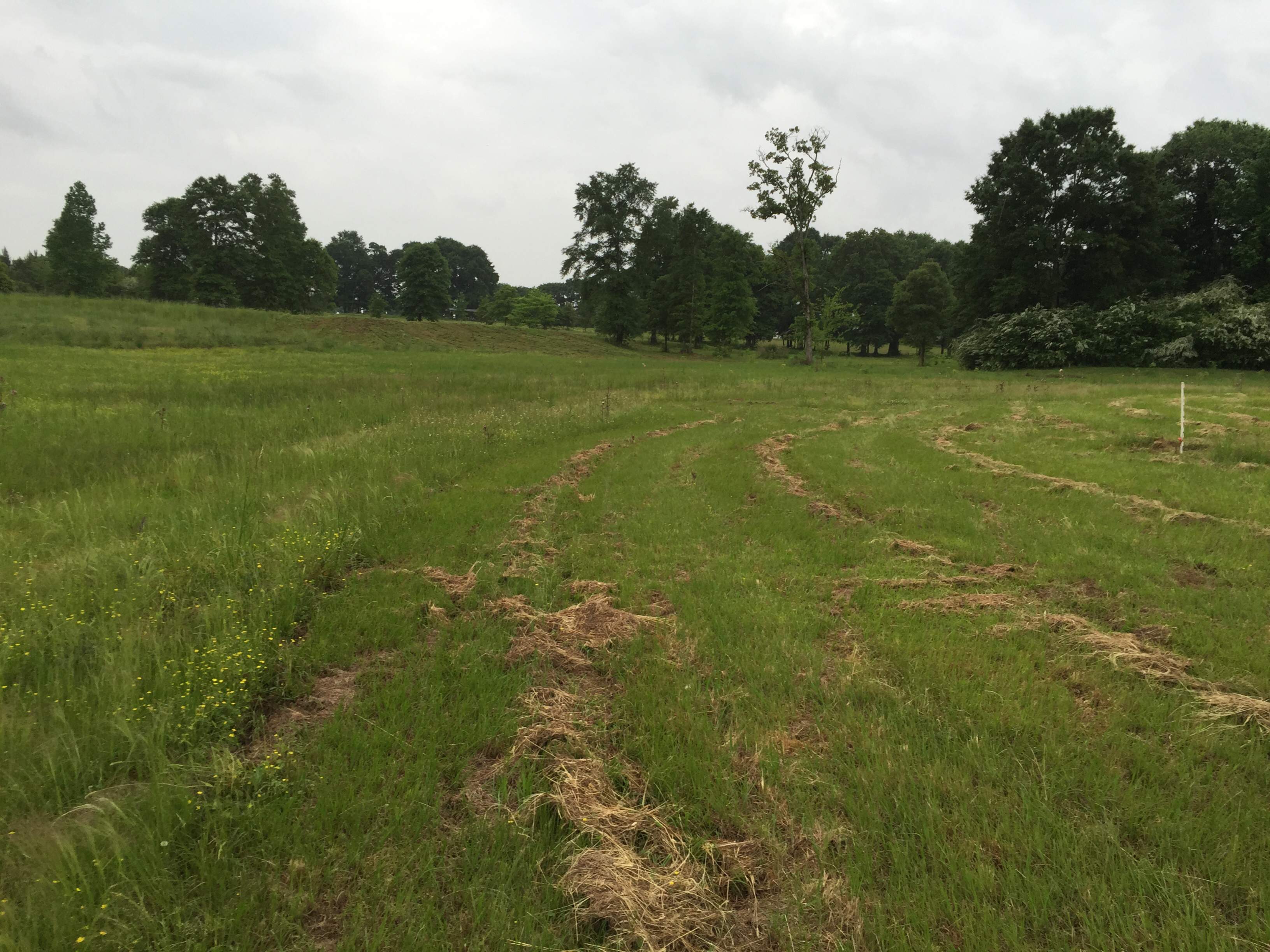

Thanks for all of the responses. I have decided to go ahead and order the Caroni. We are fortunate that we could spend more for a heavier duty mower, but we can use the extra money on other items on our list, especially if it's not needed. If we did not already have several rotary mowers, I might go with the heavy duty flail. All of our rotary mowers are only five feet, so a six foot flail is definitely an improvement.
Here are some pictures of the front pasture the Craig cut last weekend with the rotary mower that leaves rows of grass and causes ruts. Sorry about the rotated one - I could not figure out how to fix it.
/ Let's talk flail mowers #1,958
You won't see windrows with the flail but if you cut really high or lush grasses, there will still be evenly distributed cuttings laying on top of the cut grass that will turn hay color in a few days. Only way to prevent that is to cut more often.

Those pics look really nice!! What kind of speed are you running to get those results?
/ Let's talk flail mowers #1,960
In the really heavy stuff or brush I typically run in low range both for better cut and so I can look out for obstacles. Not sure what MPH. Strolling pace is the best I can come to quantifying speed.
In fields I know well but are dry and have tall but not dense grass (usually Sept or Oct after no mowing since Spring) I mow in midrange at a speed that doesn't rattle my teeth too much. The fields are a bit lumpy. I'd say fast walk or jogging speed.
