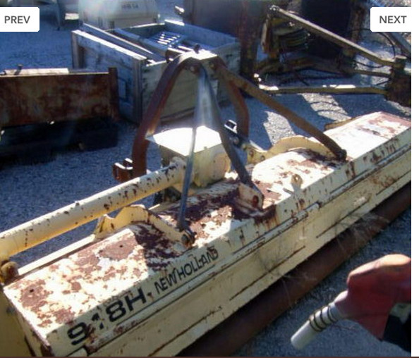

Somebody NOT ME paid $470 for it. So now everyone can tell prospective sellers "well I could have gotten a 91 inch new holland flail for $500"
Pretty good deal. Doubt it needs more than a days work and a few hundred in parts.

Better than that; A buyer could remind a seller of the very nature of auctions, i.e. nobody ELSE thought it was worth $470, only ONE buyer thought it was worth that much - the wisdom of the majority, etc.

On this auction the official bidding period ended then it went on bidding for 30 minutes, basically between 2 bidders. My best finds have been when the person posting the auction information is clueless and describes it wrong. Like this was termed a "New Holland North America Inc., Mdl: 918H,
Bush Hog," I stayed out of it because it might be a little big for my M4700 and it would cost me $100 to pick it up.
