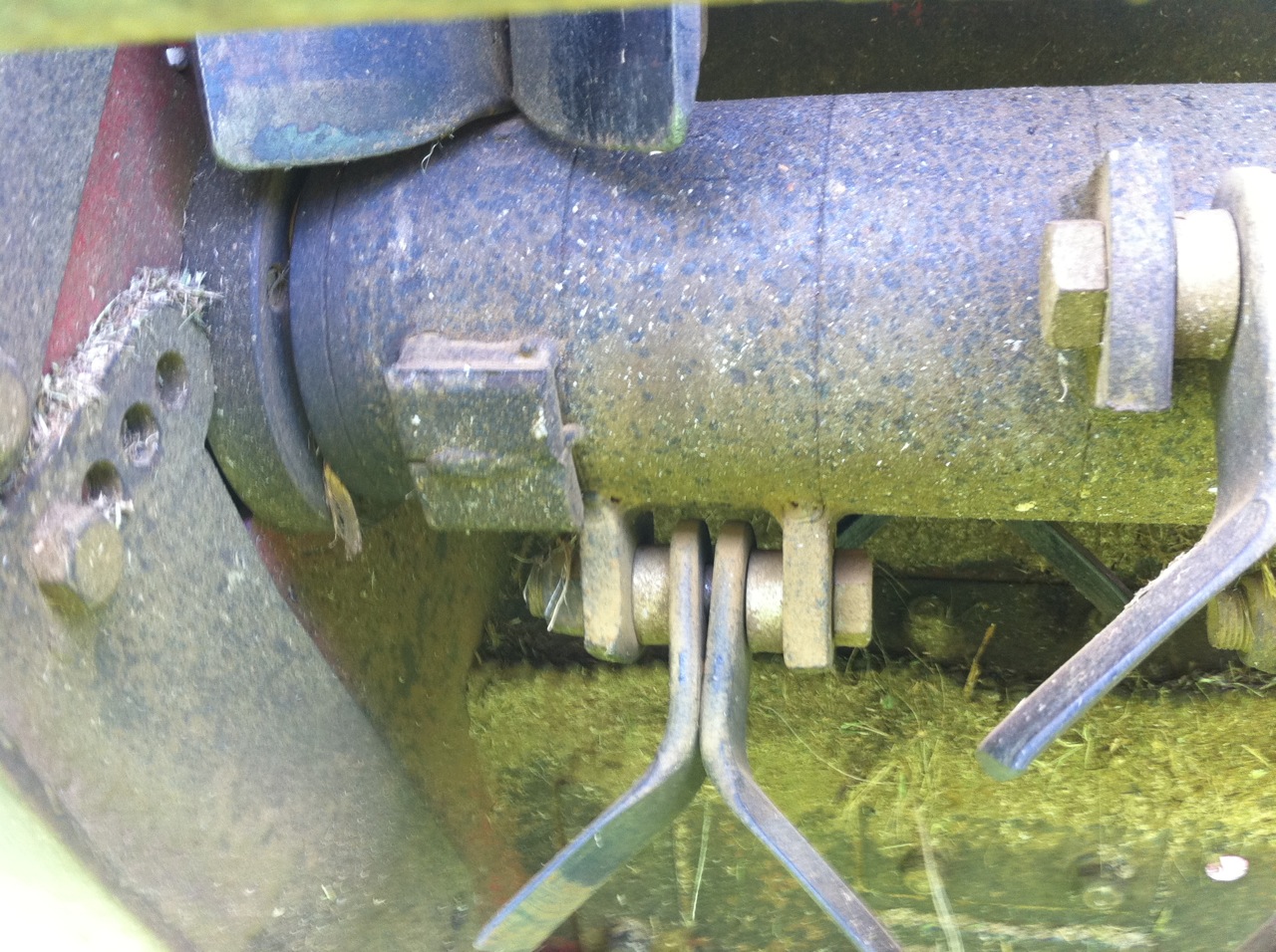

I would be a bit cautious using fine cut blades/rotor for true bush hogging. No question it will work on cane prunings, corn stalks and even small branches or saplings, but true bush hogging involves cutting and hitting things that you might not have intended to. Hitting a stump or rock with a rough cut mower is par for the course and most rough cut knives actually swivel on a clevis so that there are two levels of flexibility to allow the knives to "get out of the way" once striking an uncuttable object. The clevis itself can move backwards and the knife can both move backwards and sideways. A finish mower rotor typically has the blades attach directly to the rotor and there is very little if any lateral movement possible. That plus the fact that finish knives are generally thinner makes me wary of using a finish flail for bush hogging. I wouldn't hesitate to use a finish flail to cut a known pasture with high grass and a few smaller branches or saplings but I'd be loath to back a finish mower into a thick area with ??? under the visible layer of grass etc.

That is simply because it is a fine cut. Fine cuts always have more knives. It insures a perfectly smooth cut. A rough cut rotor is not optimized to cut every last blade of grass cleanly and typically uses heavier but less numerous blades. It really isn't the number of blades that is as important but rather the gauge, weight and mounting system.

I have a lot of stumps and downed trees on my property. I've hit a lot of them with the flail. The knives are on swinging hangers and they're also free to rotate on the hangers themselves, so they don't seem to mind the stuff I've run them into. When I hit a big rock it will make a big noise, but so far it doesn't look like I've damaged anything under there.

Island a Tractor is correct. Just remember that the basic blade design on those units are for finish cutting. Not only will you notice the knives are thinner but they are also longer which makes them more likely to bend if tested. Once you bend these they can't be straightened as they will bend even easier the next time. Blades of this sort should handle 1" saplings as pictured but if you plan on doing much more I would opt for knives designed for the task.
