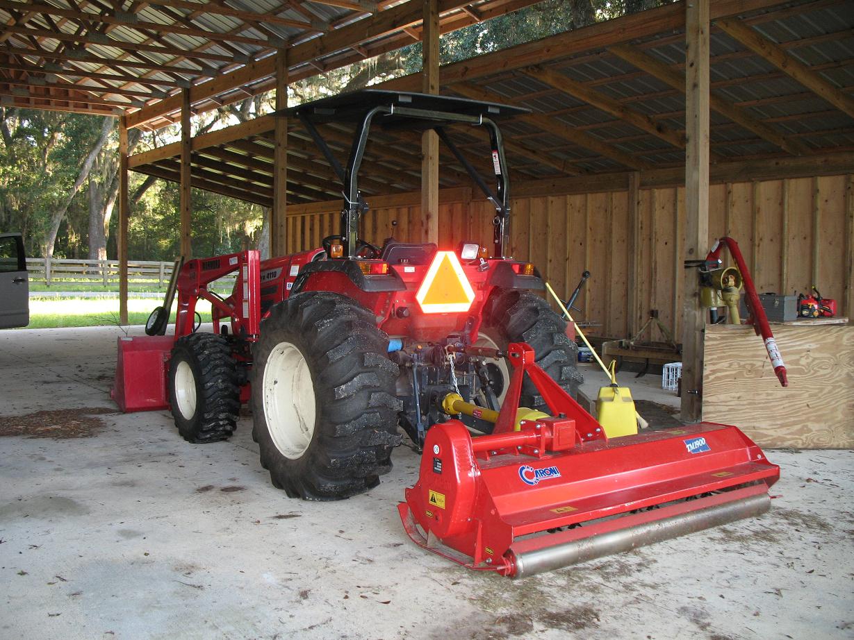

Well you guys have polluted my mind, I'm calling Agrisupply in the morning and ordering the Caroni. Been himming and hawing about a used one but they all look so beat up, with a new one I know what I'm getting ... I hope..:eek::D

Used flails can be a great deal but we haven't heard of ?any new flail buyers who wished they had done something else. Take care of the Caroni and it will serve you well for many years. Get a set of Gates kevlar belts and figure out a blade/clevis replacement strategy. Grease before every mowing and you'll be golden.

Well its done! I ordered the 73" Caroni from Agrisupply this morning.. might be here by the end of the week!!
I feel like a kid before Christmas!:D:D:D

Well its done! I ordered the 73" Caroni from Agrisupply this morning.. might be here by the end of the week!! I feel like a kid before Christmas!:D:D:D
Looking forward to pics and a full report.
