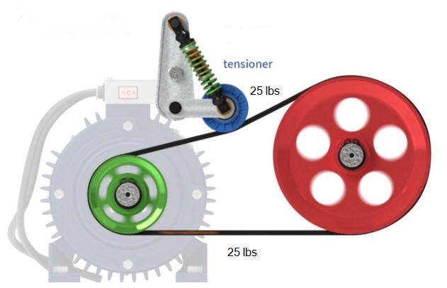

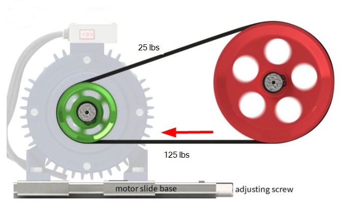

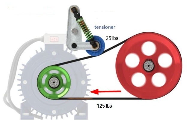

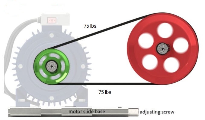

I see often mentioning of V-belt tension gauge which makes me wonder why are the manufacturers not using spring loaded tensioner, like shown in my old Ford 917L Special below - perhaps it's just cheaper to make them without one?
Yes! Cost. Retired tractor engineer here. You typically see sprung tensioners on high quality drives that see variable loading. Why? The belt tension is held to a low constant regardless of the loading allowing long life for the drive.
Many belt manufacturers advise their V-belts run to a 5:1 tension ratio (although ratios as low as 10:1 run fine without slippage).
Here is a typical drive with 5:1 tension ratio at full load. Wonderful. Look what happens to tensions when the loading is lightened or the drive stops:
Now add a backside sprung idler tensioned for full load.
Same result right? Now analyze at low or no load:
Huge difference... belt tension lowered by 1/3!
If a drive only see's constant loading (air compressor for example) a sprung idler doesn't offer much advantage. If a drive will see variable loading (like mowers).... a sprung idler lowers tensions considerably and increases life on belts, sheaves, and bearings. Adds cost though. Hope this helps!

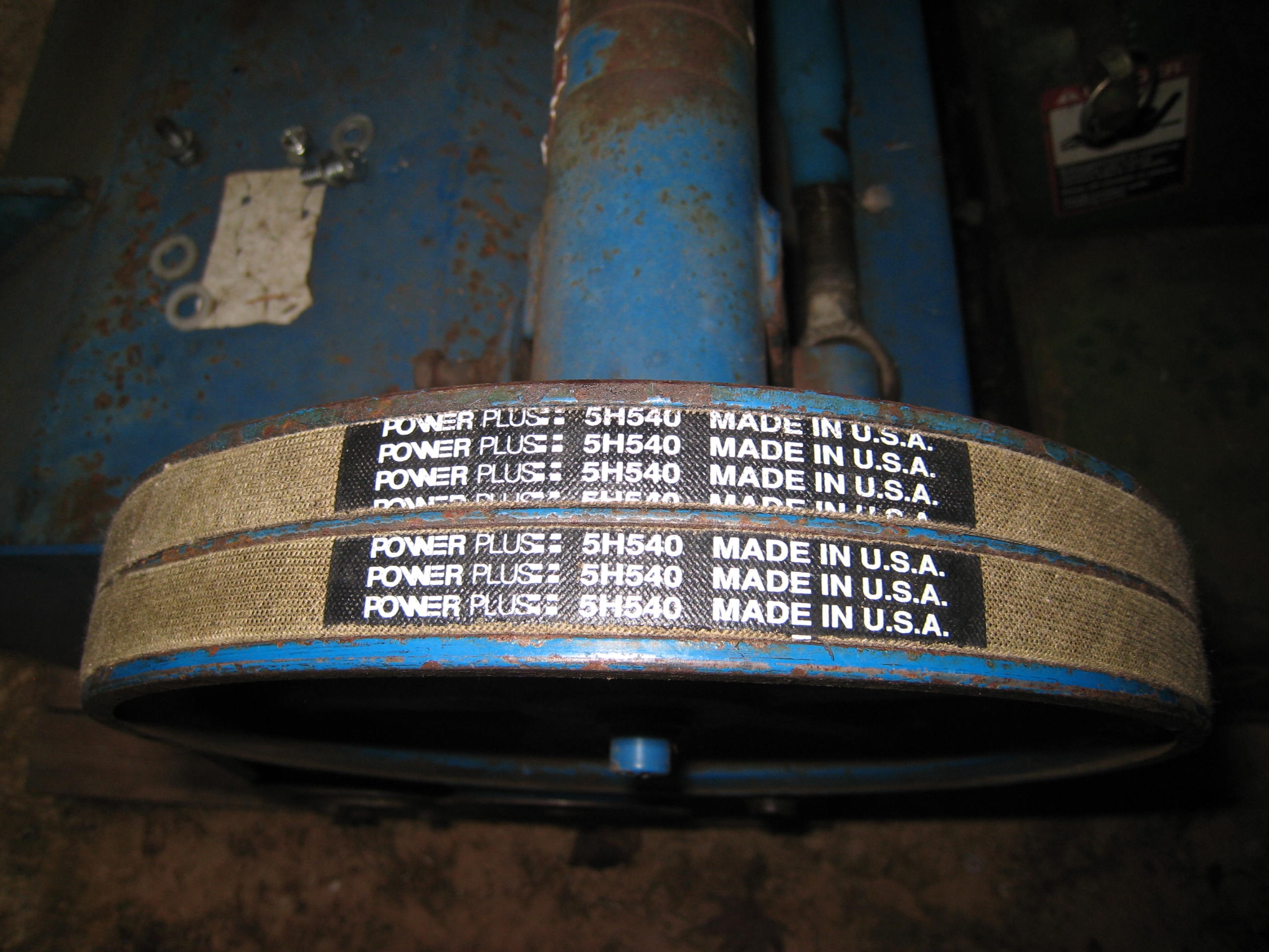

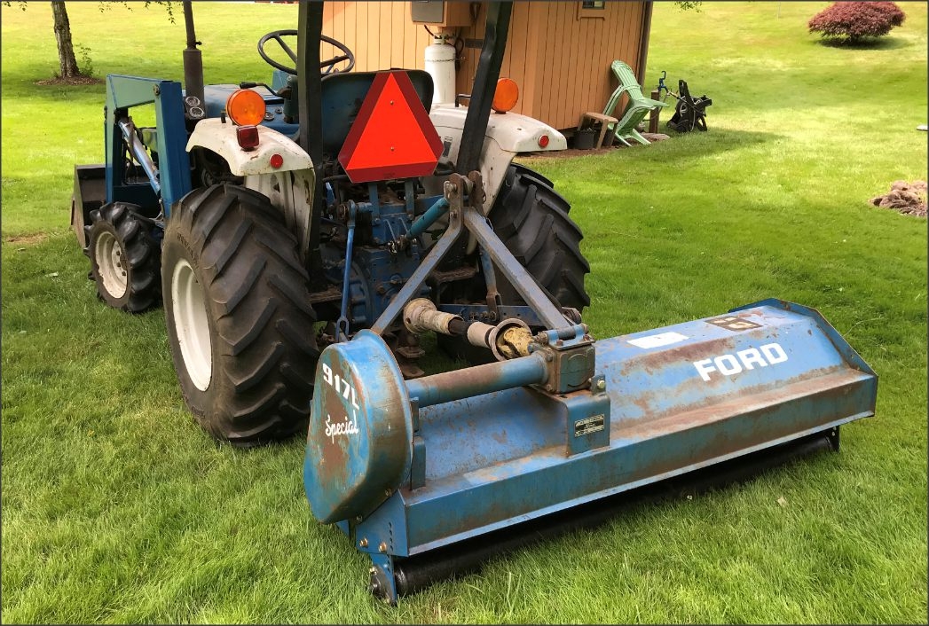

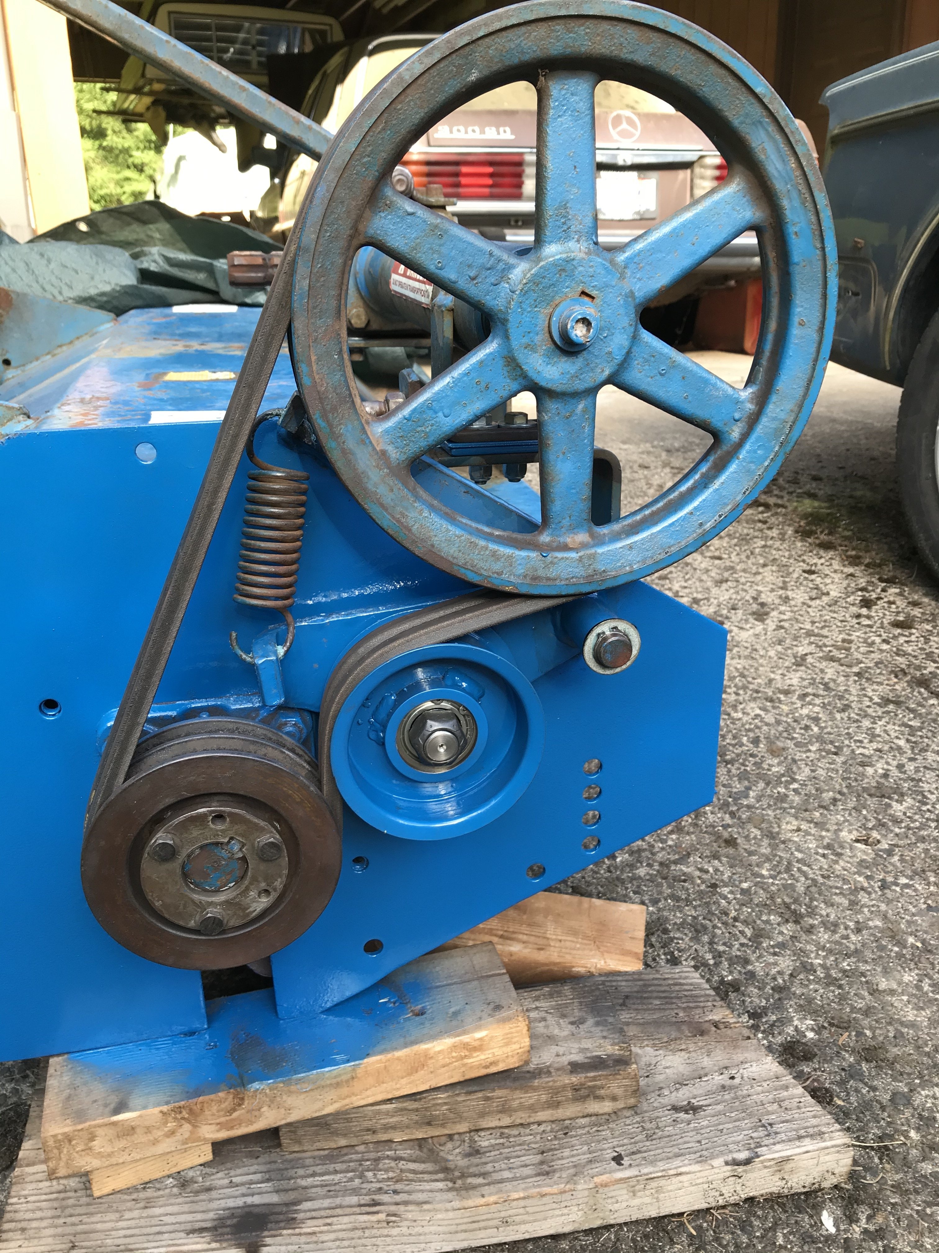

I bought this mower five years ago as a fixer upper and it has worked out very good without any need to mess with the belts, once I figured the correct belt length.
This is obviously light duty mower with side slicer flails and it does a nice job in mowing a field, as well as forested area, without any scalping.
This thread has been very helpful for me!
View attachment 4184713 View attachment 4184711 View attachment 4184719
I like the idea of an auto tensioner. It seems like it would be one less thing to remember to check.

Yup.... a no-brainer. These are not high quality drives. Even if you buy a gadget to measure belt tension, what tension do you set it to?
/ Let's talk flail mowers #8,247
True. My Del Morino doesn't even specify what to adjust the belt tension to. I made an educated guess to adjust the deflection to 1cm midway between the pulleys with moderate thumb pressure.
After maybe 100 hours the belts look great, so hopefully I'm in the ballpark!
/ Let's talk flail mowers #8,248
The tension gauge measurement markings are used to do that for the specific belt size.
/ Let's talk flail mowers #8,249
Correct belt tension is based on knowing the loads, not belt size.

All V belts have a certain amount of stretch that is managed by proper creating the proper tension.
/ Let's talk flail mowers #8,251
V-belt characteristics vary based on their application and construction. Is the belt to be used for clutching? Full load start/stops? Does it see mis-alignment? (like rotary mower primary drives). The loading and the specific application determines belt construction and final tension.
Polyester cords stretch. Aramid cords dont. Wrap molded belts offer smoothest engagement; raw edge belts can carry higher loads. The scale on a tension gage considers nothing of importance.
Belt drives need 3 things to transmit power:
  • Sufficient sheave size
  • Sufficient belt wrap
  • Sufficient tension
Loss of any one of these three leads to slippage, heat, and failure. Proper belt wrap is easy on a 2 sheave drive; both pulleys give the belt approximately 180 degs of wrap. Most manufacturers cheese-out on sheave size: larger sheaves are expensive. They can spec them down to a bare minimum and get through the warranty period ok. The manufacturers described in this thread have left tension completely up to the customer. Smoke a belt? "Well, YOU didn't tension it right." Don't put up with this! Carefully review the design before you buy their products.
