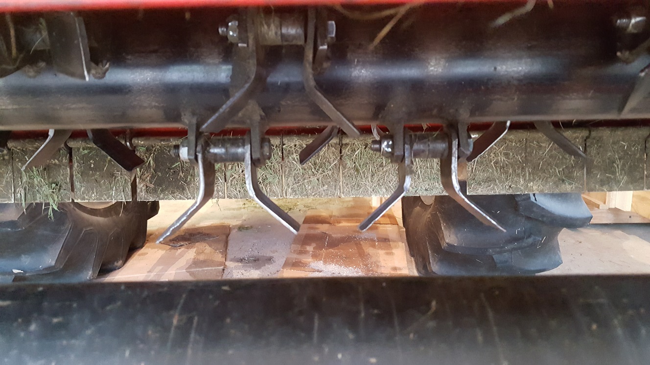

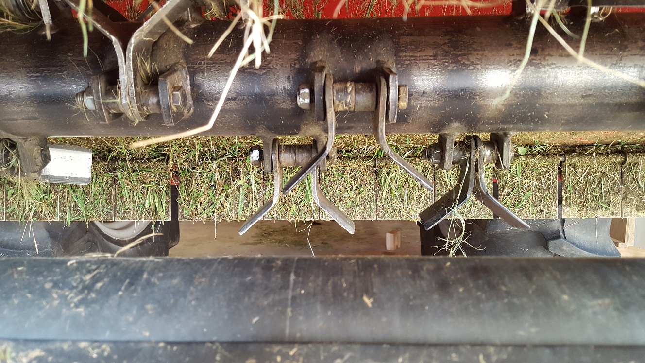

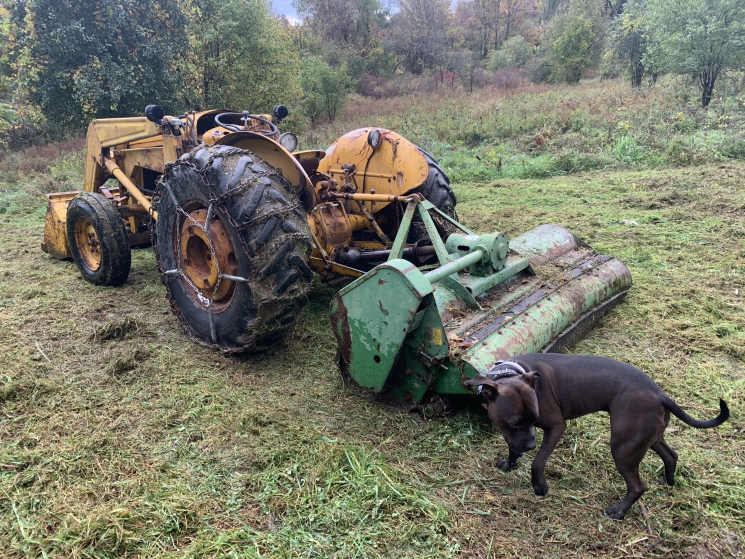

Took my $300 JD25A out for a spin this past weekend in the wet, soggy field. Just tuned the carb on the old MF35 and needed to load it up to test it.
/ Let's talk flail mowers #7,369
What's your opinion of the cut quality?
Considering that I've never replaced any of the knives aside from what was damaged or missing when I got it, nor have I ever sharpened any of them- I'd say the cut quality is pretty dang good. In dry conditions at the lowest cutting height it'll take my overgrown field (seen in pics above) and make it look like I mow it weekly in just one pass. The cut quality is orders of magnitude better than a brush hog/rotary style cutter. If I hold the back guard up in wet brush it'll blow the clippings out in a smoother fashion than if it's super wet.
The key is to make sure the flail is set up right, don't let it nose dive into the ground. It takes a few minutes of careful adjustment on the threaded top link to get it to sit just right, but once set, it's great.
If I run over a small tree, something woody about 2-3" diameter at the base, it'll just shred all the small branches and leaves off of it and leave the main trunk mostly untouched. A hammer flail would likely mulch that up. But as I said, I paid $300 for this thing, it came with a coffee can of extra knives (which I had to replace six or seven of...) and top off the gear oil. I've been running it for about six years.
The plus side of the duckfoot/scoop knives is that they leave a flat cut like a lawnmower blade does. It looks more "finished" even though there are only 36 knife stations. If my zero turn dies I can use the flail to knock my yard down while I wait on parts, it still looks really good after I'm done.

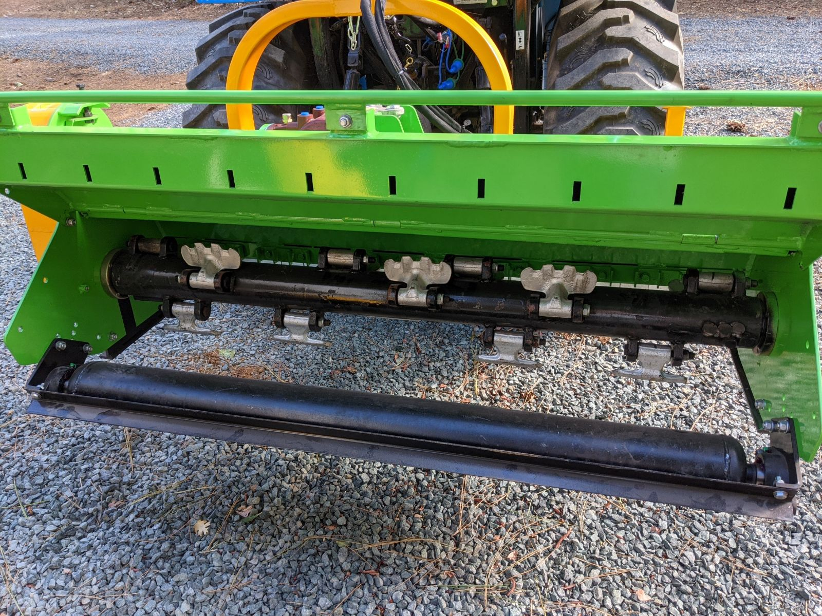

Got my new Novatractor MFZ155 hooked up dialed in and then got a little rain so we could try it out without starting a fire. So far, I'm super pleased with it. It's so great when something works exactly how you expected. Maybe any flail would do the same, but this thing munches up berry bushes and other brush so good. This is exactly what I needed.

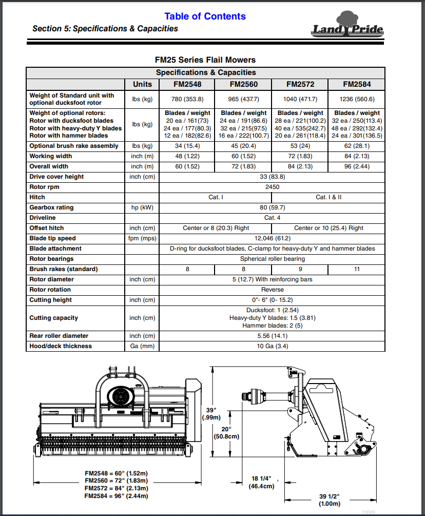

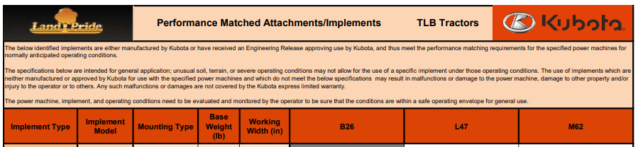

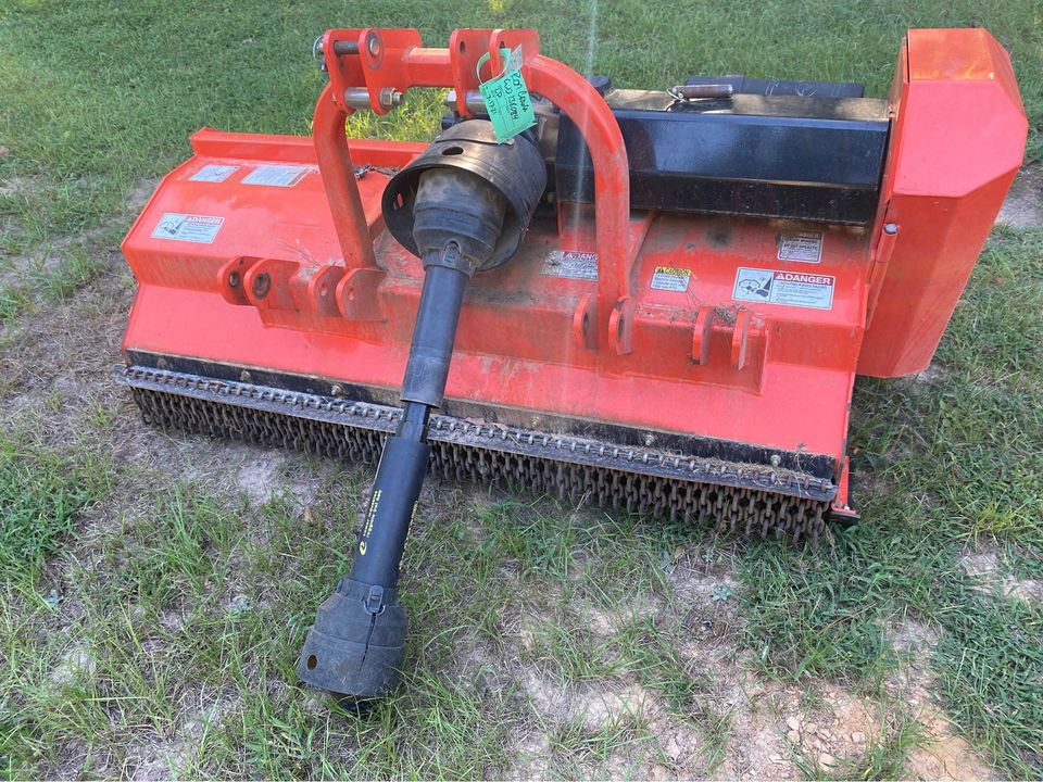

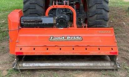

I haven't been around in quite a while and sorry for the long post. So I recently bought a Kubota B26TLB that has a claimed 19.5 HP at the PTO. I am in the process of buying 20 acres that is mostly wooded but has some areas that were previously cleared/ mowed and need to be mowed again now so we can get moving forward on building a shop and then a home. I would really like to go the flail mower route and wanted one years ago when I was still in western NY instead of using the rotary cutter. Main question is anyone's thoughts on the Land Pride FM2560 flail mower. There is one used locally with the ducks foot blades for what I think is a decent price. From what I have read the Land Pride seems quite expensive to swap blades and rotors if needed. Kubota does not recommend this mower for the B26 and actually none of their flail mowers for the B26. They only recommend the 48" for the L47 and M62. I assume Kubota is being very conservative in their recommendations.
Land Pride lists the weight at 965 lbs. and Kubota lists the B26 at lift at 1676 lbs. 24 inches behind 3 pt. hitch lift point. I have read some say if you can lift it then you can spin it but I'm thinking this may be just too much mower for the little Kubota? What I will be cutting is not real thick and I know I can take smaller bites. The Land Pride looks well built from what I have seen. Seems like most 60" flail mowers are out of stock. The Novatractor mentioned above appears to be in stock and would that be a better route? There is also a used Maschio Birba 135 around that looks to be in good condition but fairly small. My other option is to pick up a 60" rotary cutter for getting going on things and wait for the flail mowers to come back in stock and also keep waiting for the "right" used one to show up. What do you guys think? Thanks for any input.
/ Let's talk flail mowers #7,377
I can answer this. I would strongly recommend staying away from that flail mower. To begin with, those flail mowers made by Kubota are crazy heavy and weigh a ton. They weigh more then what your little B26 can adequately handle. It could easily push your tractor around and cause a real safety concern. Secondly they are very hp hungry flail mowers and no way would I recommend taxing your 26hp engine down with one. And thirdly the replacement cost for knives is beyond stupid, it's just straight up robbery. Take my advice and stay away!
What I would recommend instead is a flail mower made for low horsepower tractors such as the Befco H40-S line, Vrisimo Mini Max Series, Trimax Ezeemow and Maschio makes a flail for lower hp tractors but I would look at the first three first.
