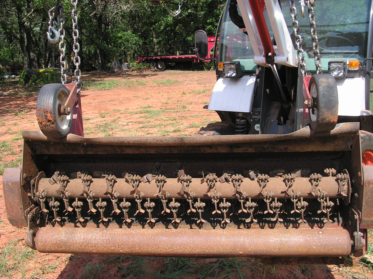

Has anyone found a way to access and replace the blades by tipping the entire unit forwards or backwards? I’m really not comfortable working from underneath it.
Hanging from the loader works:
/ Let's talk flail mowers #7,388
Thanks. But I don’t have a loader. Not sure my 3pt boom pole could handle it. Maybe?

Hello Jethro,
You do not have to lift it that high to work on it. You can drain the oil out of the gear box and then lift it enough to set it on its back to do all the major surgery.
Check the knife hangers as they are automatically suspect when you mentioned the knife condition as you probably need new hangers, bolts and nuts.
The best tool for this if you do not have smoke wrenches or an impact wrench is to use 12 point metric sockets and 12 point box end metric wrenches to remove the bolts and nuts.
You can use a 36 inch 1/2 inch drive breaker bar, 12 point metric socket and hard wood blocks to rest the wrench against to hold it in place.
Once you have the nut broken loose you can use a ratchet with a shallow socket to spin it off unless you have a 3/8 drive 90 degree impact wrench.
You will be able to tell whether you need to replace all the nuts and bolts with removing the first one. Use Blue loctite to secure the new nuts and bolts in place.

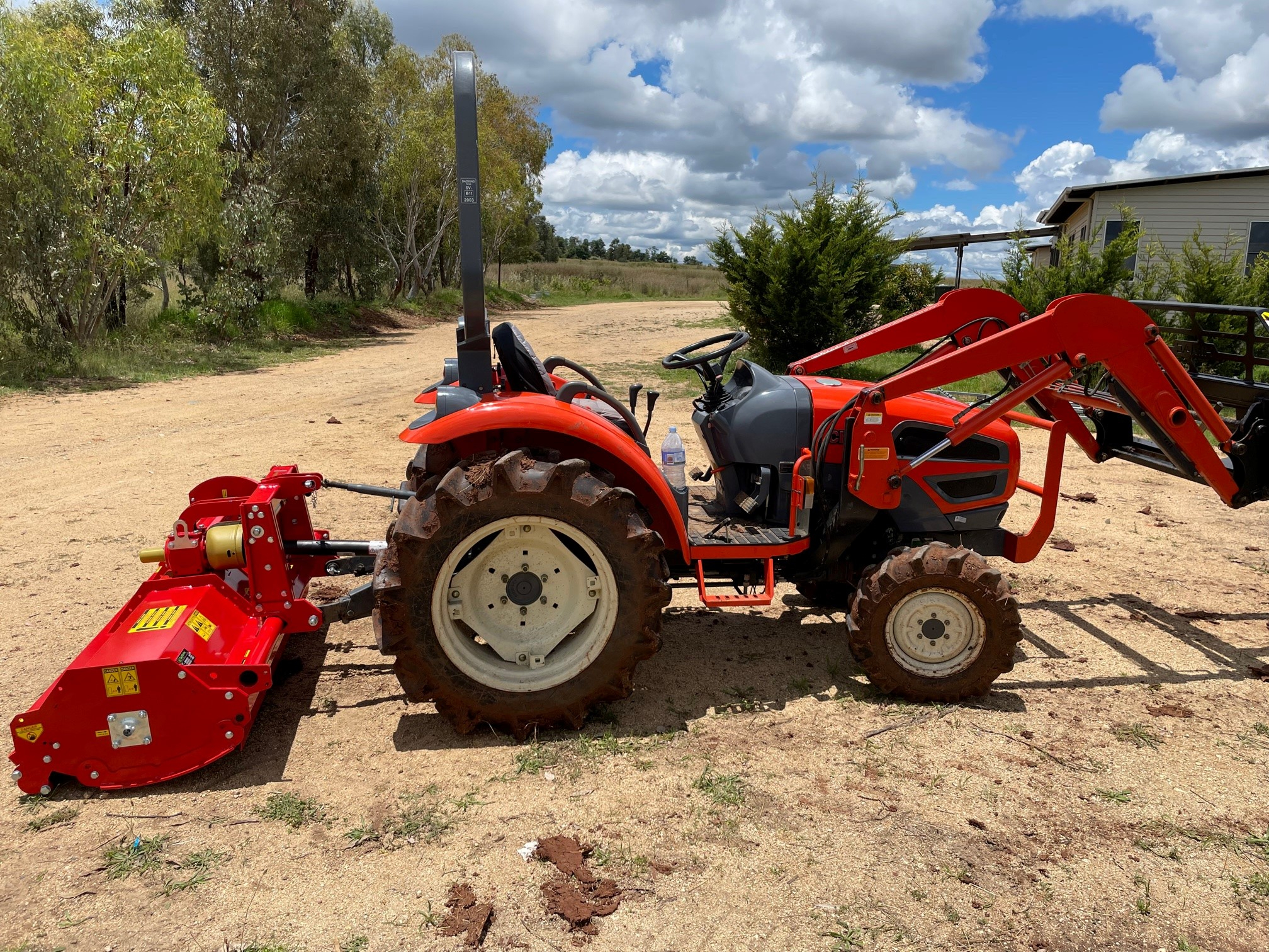

Del Morino Flipper 158 delivered today ... and hooked up for a quick test flight!
I did a quick run around the outside of the small paddock, and it all seemed great. It handled the long grass with ease, and didn't strain the tractor whatever even going over the thick windrows left by the previous slashing ... although I did take it very slow and easy. As it's hammer blade equipped it didn't seem to mulch as much as I had originally thought, but there was lotsa grass (about 4ft high). I'll need to fiddle a bit with height adjustment (currently a bit too low), but I reckon will be a good unit.
Once it stop raining, I'll need to re-adjust the belt tensions and give it a couple of squirts of grease and I'll be flailing away .... lotsa grass to cut here after all the rain.
This thread has been great in helping me make the call on the right unit
Thanks
Andrew
