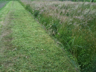

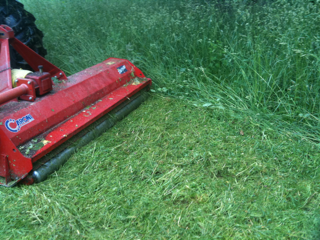

I found this description of flail mowers on the internet a few days ago and I thought it was the best description I have ever seen denoting all the benefits of a flail mower:
FLAIL MOWER​
The flail mower is the best of both worlds. They can handle heavy grasses while also providing a beautifully finished cut. A Flail Mower or a Mulcher does not create windrows rather they leave an evenly distributed mulched bi-product that decomposes quickly and puts many necessary inputs back into the soil. This mulch assists in preventing erosion and improves soil structure and fertility also reducing the chance of disease infestation. Mulching is effective for weed and pest control and over time a mulched paddock will require fewer fertilisers, pesticides and herbicides.
Flail Mowers are also very popular in the bush for their ability to create firebreaks and remove fuel loads to help shut down potentially deadly grass fires.
Here is a link to the article if anyone cares to read it:
