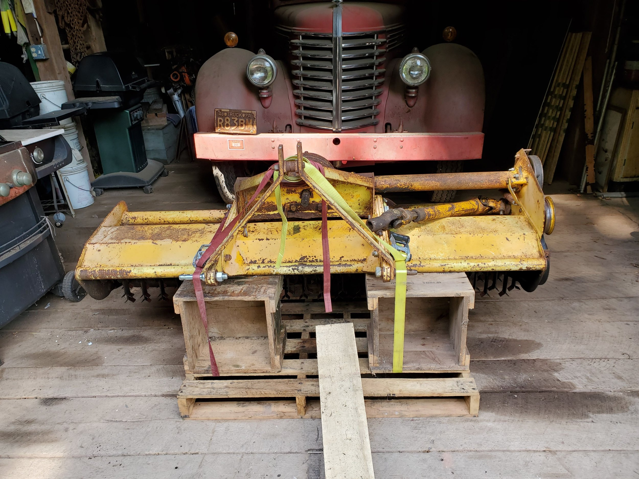

Ok... So today I got to check things out.
No model number anywhere that I can find. No manufacturer tag. One older dealer tag, but that doesn't help too much. Obviously old since it doesn't include an area code on their phone number.
Roller is bent. Bearings are gone. It's a threaded, round shaft roller, which according to the Flailmaster catalog, means I have to convert to something else... That's unfortunate, but not horribly shocking I guess.
There's a triangular rib under the housing that either stiffens it, or deflects debris. Center area of it is rotted out. Easy to cut it out, and weld in, but it isn't going to be the first thing I do. Doesn't get it the way of the flails.
The tube that covers the shaft from the gearbox over to the pullies got warm on the gearbox side after running it at idle for a little while. Not quite sure how it's set up in there, but obviously I've got an unhappy bearing of some sort. It looks like I have to pull the whole gearbox off to remove that tube/shaft... That's on tomorrow's list of chores.
Needs a new belt for sure.
When running the rotor at idle, I could tell something wasn't perfectly balanced. There would be an occasional jump that I though was some resonance point, but now I imagine that jump was the belt... The vibration wasn't from the belt. Something is a little off, but it might just be the flails being a little beat up. I didn't see any missing apart from one station all the way on one side. It looks too close to the housing to take knives, but who knows... I didn't count stations and knives... There's a lot... I guess one missing pair could throw it off enough to feel.
PTO shaft was crashed pretty bad at some point. Has a big pinch in the tube, and a matching ding on the mower. Seems a PO used it on a smaller tractor, and had shorter 3 point arms. On the 135, there's no way I could crash the shaft if the mower was anywhere near level, even at full lift. It ran true, and I didn't see vibration there, but it seems awfully short for the 135. I've only got 4 or 5 inches of overlap in the two halves when hooked up. I think I'll want to get a longer unit. A shame really as the ends work very nicely, and the joints are in very nice shape. We have a Ford rotary that we don't use at this point, and I may be able to steal the PTO shaft from that. I probably won't get that lucky, but ya gotta dream a little...
So repairs will be a little pricey... I'm only in $250 on the mower, so I have room to go before I should have just bought a new import...

Got everything apart yesterday. I hope that design has been tweaked a bit for new owners, because getting the gearbox and shaft off the mower was a friggin nightmare. I believe I will be opening up the hole where the input spline passes through the body to make reassembly reasonable.
Since I had gone that far, I pulled the rotor as well. No point in fixing everything and then having the rotor bearings go south. Plus I can A) make sure the rotor is straight, and assuming it is, B) do some welding on some of the mounting tabs. Somebody has done some really ****ty welding under there over the years.
Have to call Montage today. If I can get a parts breakout this would be a little easier. They're about an hour or so away from me, so if I have to pick up something heavy, at least I can save some shipping.
So...
  • Roller, Roller supports, Conversion parts... If this is crazy expensive, I can make one like was on it, but even that isn't cheap.
  • Rotor bearings
  • Gearbox Bearings
  • Output shaft bearings
  • PTO Shaft
  • Think I'd like a toe guard for the front if I can. When I had it hooked up, that opening sure seemed big looking back from the tractor seat.
  • Knives/Pins/Cotter Pins (if I do everything else, I guess I'll go all the way)
This is all predicated on the rotor being straight, and having good bearing seats. I didn't see any wobble on that, but worth checking. If that's shot, I'll likely cut my losses, and look for something else.

That gearbox mount is the same design on my Alamo SHD88. I'll have to look if that hole is opened up on mine.
I have a little vibration on mine, but it seems to balance out as I get up to operating PTO speed. If you weld on the tabs, make sure it is about the same amount of weld as factory used. Too much or too little weld could cause a vibration. That style of blade is less forgiving if you hit rocks or other hidden objects, but it will leave a very nice cut. The fine cut blades are commonly used for parks and soccer/football/baseball fields. They are also not very good with brush. If you need to wipe out some brush you might be better off using a brush saw to clear the area first.
A toe guard likely won't be necessary. The blades spin the same direction as the tires so you won't be getting things thrown at you in the seat.
The belt is probably a common C-section belt. I believe for my Alamo I use a C53 on it, your belt drive appears to be similar to mine so it may be the same belt.
As for the roller situation, Flailmaster sells (or at least they used to sell) the roller ends so you could make your own roller, just you will need to update the bearings and housings. Do you have a picture of the roller bearing housing and support? I can let you know what you'll need to update. Definitely have Flailmaster quote the parts as they are reasonably priced for their stuff.

I really only need to open the hole on the right side 3/16-1/4". Not much, but there's just no compressing that assembly to make it fit nicely...
The PO told me it would smooth out at higher RPM. Seeing the cracks, and missing tabs, I felt I was better pulling it to work on it at work where I can TIG everything. Plus it's just easier to work up on a table rather than under the machine... I dropped it on V-Blocks today, and it seems straight enough. Probably .010 wobble at center. Bearing seats aren't perfect, but I think they'll be ok.
The belt is a C section. It's a C50 in fact. Always amazes me when you can read the belt numbers after god knows how much abuse they get....
Good point on the toe guard, and standard rotation...
Fortunately, our fields aren't too bad for rocks, and brush. Worst case is likely to be some 1/2" or so briar near the edges. Since we've been cutting with a finish mower, I can't imagine the flail having any serious trouble. I'm actually mostly glad it's a finish cut unit as I would prefer to eliminate most of the "normal" lawnmower work in favor of this.
I will check with Flailmaster on the replacement ends for the roller. Worst case is I throw a couple chunks of steel on the CNC mill I run, and just put them on the ends of some straight pipe/tube. I'd really rather buy the solution for this, but I'll do what I need to to get up and running.

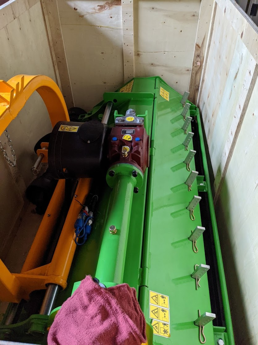

Merry Christmas to me. I say Christmas because it may be December before I can actually do anything with it due to fire hazard here in Ca. But we'll see... at least I'll have it ready to go by then.
Went with the Novatractor MFZ because their hammers just look like they will munch stuff better. I'm less concerned with how fine it cuts grass and more concerned with how it will shred berries, weeds, brush, saplings and small branches. So hopefully these will do the trick. In my wife's hand they look huge, though they are still pretty big.
Will review once I get a chance to munch some stuff :)

Hello and good afternoon Racenut,
I want to welcome you as the newest resident member of the "Flail Mower Nations" from the Golden State.
To save yourself a great deal of aggravation I want to suggest to you that you remove the spring clips and
drill these holes on the recutting bars larger to enable you to use 1/4" by 1" inch fine threaded bolts and
nylock nuts.
By doing this you will avoid losing the recutting bars and also avoid having to hunt for them
on the mowed land.

remove the spring clips and drill these holes on the recutting bars larger to enable you to use 1/4" by 1" inch fine threaded bolts and nylock nuts.
Thanks or the tip. I'll take care of that before they have a chance to escape.
