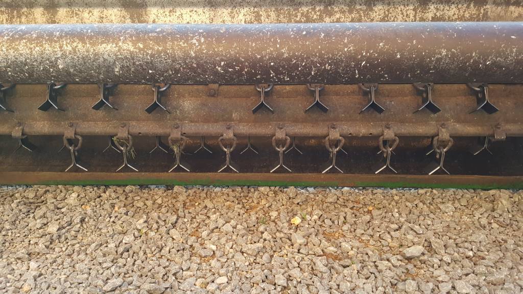

Pic of my JD390. The rib is 1/2" thick flat stock. My JD25A has a 1/8" thick hat section rib welded to the rotor. I have had the straps that hold the d-ring wear as well as the d- ring itself have a groove worn in it by the blades. 20200816_075031.jpg

Yes. The strap is through bolted with anti-vibe nuts. This pic was taken before a full blade, strap, d-ring and bolt replacement.

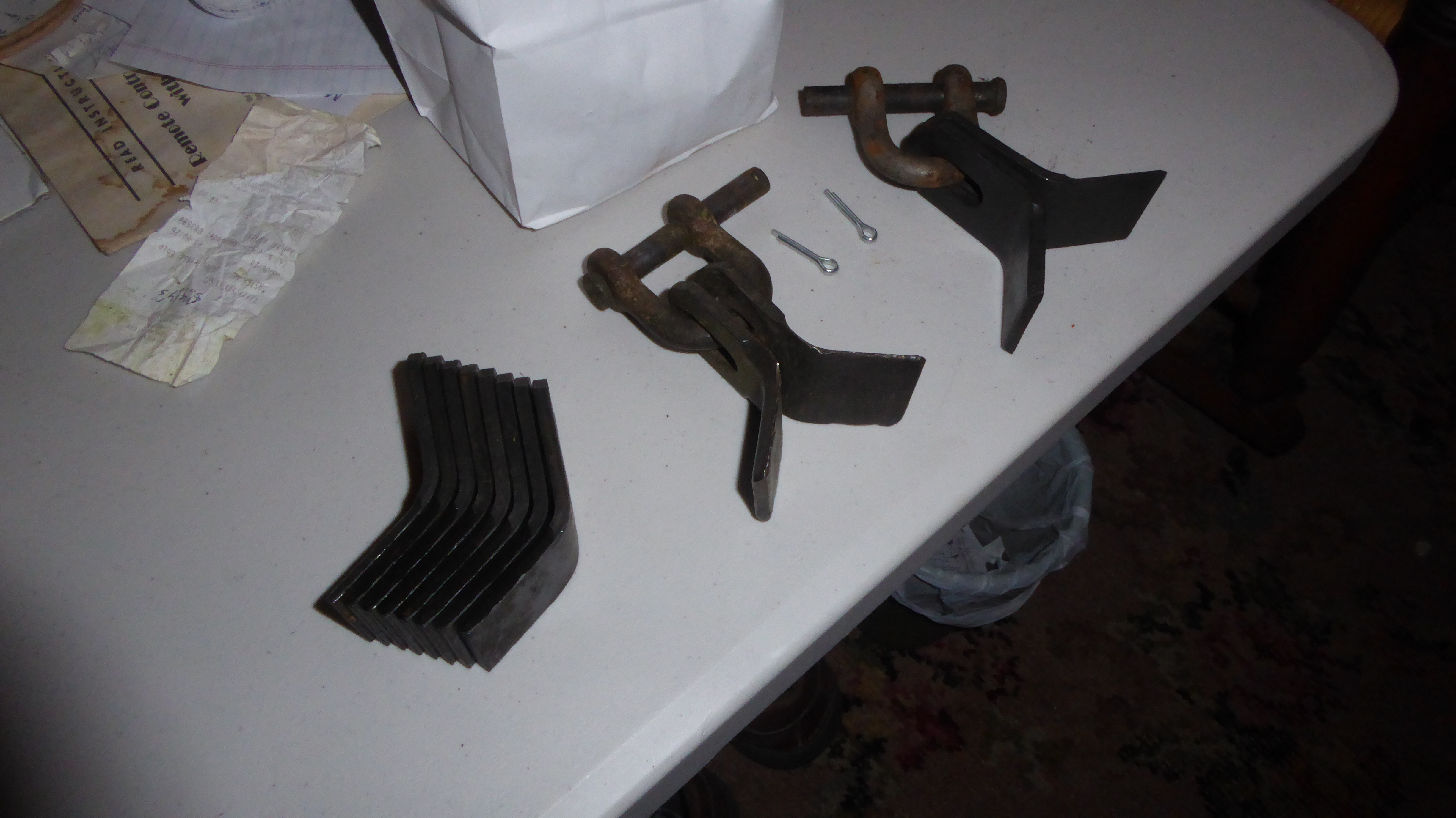

Interesting. My Alamo's design is per this picture
Some observations:
1) The Deere design is more of a pain when one breaks/loses knives. I had to replace knives twice in one day last week and there is only one cotter key to pull, no bolts. I'm glad mine is not bolted.
2) However, looking at the Deere design, the triangular knife support 'clevis' probably never comes out of the bolted strap even when the knives are beat all to heck. My Alamo clevis and pin with cotter key DOES sometimes come loose via breaking the cotter key apparently, leaving me with a dangling clevis and missing knives, so the Alamo design MAY come apart more often than the Deere design ??
3) Our knives (Deere and Alamo) look identical even to the oval shaped elongated holes in the knives. If the dimensions are close they are probably interchangeable. The oval shaped holes in the knives are required in the Alamo case to get the clevis ends thru the knives.
So how do you get the Deere triangular clevis's loose from the knives? Are they made as one unit and you have to replace the two knives and the clevis all at the same time OR is the Deere clevis made with a gap (hidden by the strap in your picture) ??

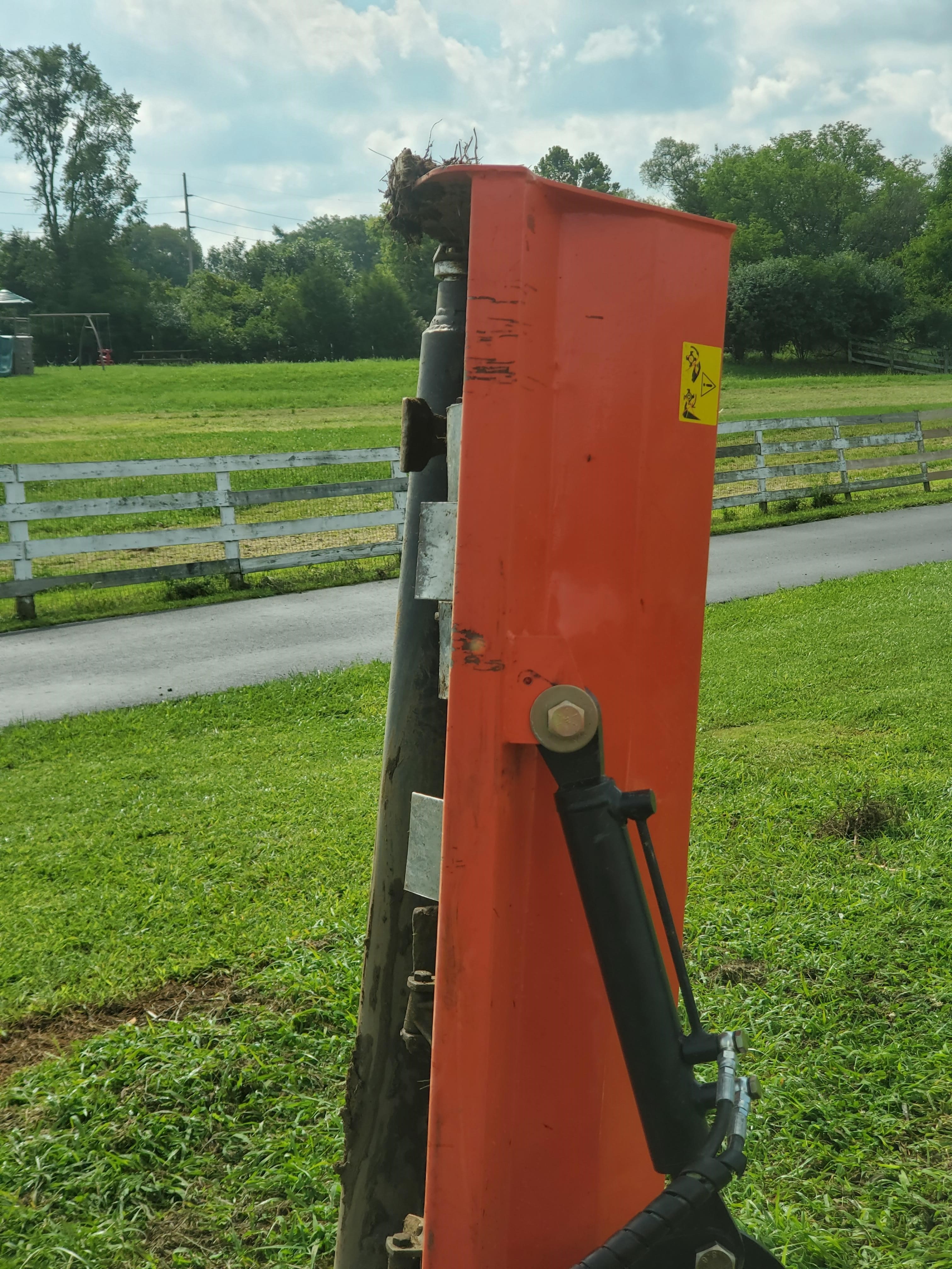

Whelp, within half an hour of use my AGL165 is trash.
I'm not sure what exactly happened but I think it all occurred because the vertical extension pin broke off and the mower dropped hard into ground while I was driving. The end result is the assembly is torqued where the flails hit the housing and bent the mud scrapers and flails broke - all within a few seconds. I didn't hit anything, so assume just the weight of the mower broke the pin. I'm not even sure how the flails could hit the housing but it is what it is.
Disappointed. Hopefully the company will treat me right. I'm sad I sold my Ford 917 that I've used for years without issue. I'm ticked because I had been waiting to mow after I got better belts (bx39) and a few other things I learned from the research here. This came with bad hydraulic crimps too, so bought 4 new hoses on my own just to get it functional.
I sent an email, since calling they just told me to email them anyways about the hydraulic hoses. I'm going to keep my faith they'll treat me right. I'm kicking myself for buying something I knew was cheap from the get go.
In the picture you can see how it's been torqued about 5 inches between the end (top) and the base. I may be able to twist it back, but what else is damaged? 8 flails are just gone in the middle of the tube.

I would ask for a refund of your money as that flail mower is no longer safe to use.

Sorry to hear about your problem.
It looks like the flail mower housing is twisted to sort of a propeller shape.
Few years ago I ended up replacing a 72" rotary finish mower fabricated deck due to somewhat similar twisting issue or problem.
No doubt a competent metal workshop could have straightened it, but due to other wear & rust it was decided instead to replace the deck shell.
You can see the problem here if you look closely:

The d-ring (clevis) has a gap hidden under the strap. The gap is just wide enough for 1 blade.
The d-ring swings in the strap, thus the strap can wear and drop the d-ring and blade assembly. There were many missing scoop knives and d-rings on the 25A when i bought it. I changed to side slice knives for cleaning up my weedy hill pastures.
On the 390 I lose 1 or 2 blade stations/year mowing about 25 acres 6 times/year. I personally prefer the bolts over a cotter pinned pivot. Judging by the dings and nicks on the bolts and rotor rib, i can see the cotter pin getting broken fairly easily.
