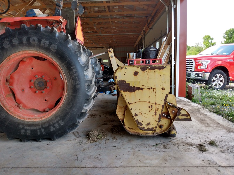

Here are some pictures. I have the roller on the highest setting. You can't see the bubble on the belt guard but, it's set to be level.
The problem is my property is quite hilly with abrupt changes in grade, so I scalp the ground all the time, and there's no way to really avoid doing that. I included some pictures of that too.

thoner7, I don't see any "skid fronts" on your mower:

I don't see any "skid fronts" on thoner7's mower:
The bottom leading edge of the frame has some skid flanges built in. In the picture they are probably 2, maybe 3 inches off the ground. I've gone higher than others bc I'm always scalping and trying to minimize it.
I was comparing it to pictures of other brands that I have seen with skid flanges farther forward:
Maybe you could add something to make it work better.

Ok, I see the skids now in the photo Xfaxman just posted. Is this your mower and if so, those skids should work if you let the mower float along meaning, do not lock the 3 point from going up and down freely. Keeping the nose off the ground is essential using the top link or scalping will happen on turns.

Those shoes are quite substantial, mine are not that big. Mine is a Ford 917 if you care to look it up.
I do have a lock knob under my seat however, it's stuck and doesn't turn. I've never used it so maybe it's seized up or maybe I need to do something else to adjust it?
I've always let the mower float up and down while driving. I actually think letting it sink down may be part of my problem now.
