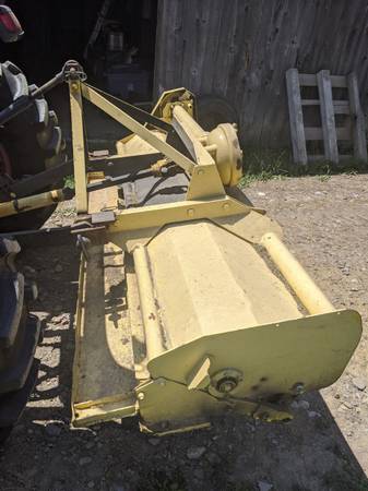

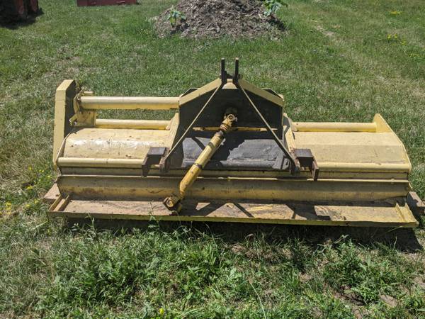

Good morning all - I wrote in shortly after purchasing our new property with some questions on flails. Just to catch up - I have an old beat up 5' brush hog, but want a flail to keep about 6 acres of field/meadow cut down once a month or so. I have a Deere 3033R and a 72D MMM for yard mowing.
So I've found a flail mower, but hoping I can get a little bit of feedback on it. I'm told it's a Mott Alamo #72 - possibly 80's vintage, with finish knives. I did a bit of searching parts manuals and google image search, but I'm not coming up with the exact model. The right side drive pulleys is throwing me - most that I'm finding have the drive line on the left side. Also, I don't see any with the extension on the front of the mower body like this has.
It looks to be in good shape, I just want to be sure it's the correct rotation and speed. Any other thoughts are welcome. Thanks!
Jon
/ Let's talk flail mowers #6,869

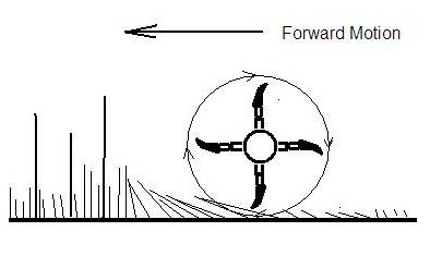

Well, I can't see the knives from here so it's hard to tell which way they're suppose to rotate. :confused2: You also didn't say which way it's rotating now. :cool:
Mine uses the "folded spoon" style knives. When the knives are hanging down, the cutting edges face the front. This is because mine rotates back to front.
Both my JD25A and JD390 rotate in same direction as tractor motion. (Opposite of image)
