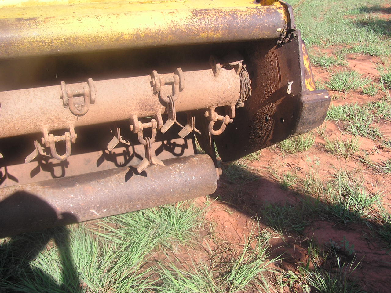

From what it appears in your photo image the problem is that the original anti scalp skids are gone.
At some time prior to this the skids were removed or worn off.
Properly adjusted skids prevent the mower from nosediving and breaking side slicer knives and knife hangers
If you are able to loosen the clamp bolts for both the lower links go ahead and reposition the lower link arms up at least 2 teeth counter clockwise that will help a lot. if you have telescoping lower link arms on that mule unclip them and remove them before loosening the clamp bolt for both lower links so you have less weight to deal with and after you have reset their position by 2 teeth reset and pin the lower links with the arms fully extended.
Use a fine tip sharpie to locate the gear tooth at 12:00 before you remove the lower links as it will be easier to manage and not cause the lower links to be off a degree or 2 as remounting the mower or other implement will become a real PIA.
Use the sharpie to mark the inside position of the two teeth to the left of the 12:00 position ON THE STUB SHAFT and you will not lose track of the point where you must set the lower link arm. Please be careful when removing it as it is going to be very heavy.
Perhaps if you have a sheave pulley you can hang it over 2 or three rafters with a piece of rope prior to removing the lower link lift arms as it will prevent any surprises like losing your grip on the lower link arm-been there done that NOT PRETTY even the small ones hurt.
If you have telescoping lower links on this mule they should be pulled out all the way and then pinned back into place.
Flail mowers with wheel sets mounted in front prevent scalping more effectively and keep the mower from dropping and breaking knives and knife hangers.

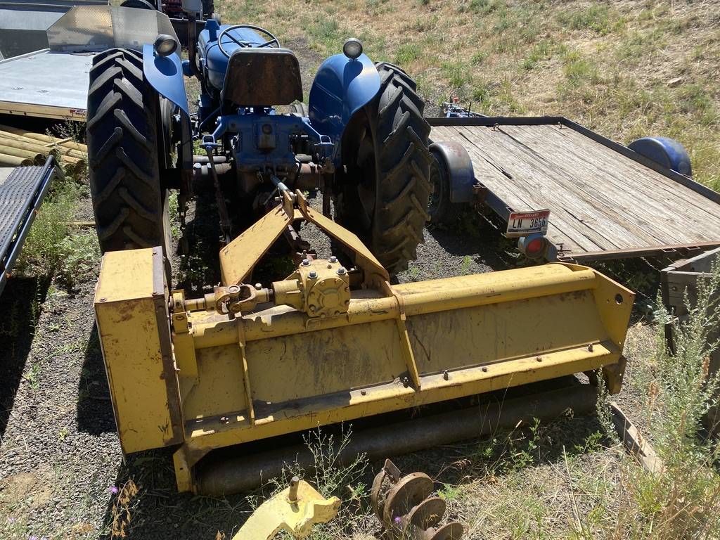

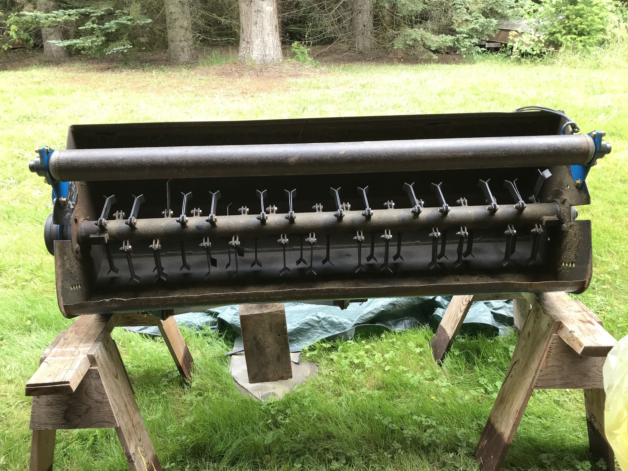

Anyone recognize this flail, who the manufacturer might be?
/ Let's talk flail mowers #6,906
I think I figured it out. Looks like it's a Mathews Company product. Not sure the vintage. Here's a comparable, model stated as 7HDCL:
MATHEWS COMPANY 7HDCL For Sale - YouTube
Stalk chopper. Paddle type flails which aren't likely available and which won't serve the purpose I need: I need to cut grass and tree debris.
/ Let's talk flail mowers #6,907
Hello DieselBound,
The paddle knives should still be available from Clean Cutter or Mathews. They will cut grass for you but they will not recut the grass unless its brittle.
If you need to break up pruning debris you will need a flail mower with heat treated/hardened side slicer knives or make two or three passes over the
tree debris to break it up with the paddle flail shredder..
