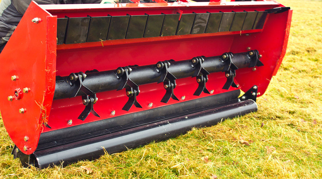

I was torn between the bestco and woodmaxx.
I went with woodmaxx for 2 main reasons - one being the grease maintenance - bestco is 25 hours and woodmaxx 250. Yes, 10 TIMES the time between greasings - tells me they're sealed bearings or much more well sealed. Having worked with dirt bikes and quads I can tell you sealed bearings are easily 10 times longer lasting. Second was the belt tension arrangement - to tension belts on the woodmaxx, well, it's automatic for the most part. the bestco..manual and you move teh ENTIRE gearbox/shaft assembly to do so. Awkward to say the least.
The door on the back...I opened to see the difference it makes - much rougher cut as the suction is considerably less, BUT it's tossed out much longer grass pieces - which I like as I'll be able to use it to gut hay to bale.
The other big question was hammers or knives...I ordered knives as grass is my main thing needing cut. Woodmaxx shipped it with hammers...so I mowed some with them and woodmaxx sent knives so I put them on and mowed some more.
The hammers have more mass, are noisier, shred grass MUCH finer...not sure I can tell much other difference, other htan when cutting tall grass the finer shreds fall to the ground where the knives cuttings sit on top and turn brown..waiting to see if this will kill the pasture grass or not.
Mowing speed is about the same as a brush hog - 6' hog and 78" flail both on a kioti CK3510HST (30 pto hp).
YOu cannot mow in reverse with a flail where you can with a brush hog. the hog is 8' long more or less, the flail 3' perhaps. Weight is similar (very heavy!)
I got the hydraulic offset flail which you can't get a BH like that - handy for under fences and tree limbs.
Can it work as a finish mower? Yes..but it's not as good as a finish mower.
And you'll find with the big roller at the back it can leave oddly un-cut patches when the ground is uneven.

Interesting, I would have GUESSED that the hammers would leave larger pieces of stuff.

I do not think it will be satisfactory for cutting hay to bale at all. Never heard of anyone using a flail mower in that role. Others with experience in that area will comment of course.
Yes, you can cut in reverse with many flail mowers. I certainly do with my Alamo SHD-88. My knives are double sided and would cut either way if rotation got reversed (which it does not for me), but they are going so fast it makes little difference if you are going forwards or backwards. In reverse the only real hindrance is that the roller is rolling down the grass and only what springs up enough after being rolled over will get cut.
The hammer style knives are NOT double sided and mainly aimed at cutting heavier material. I can't think why they cut smoother for you than the Y-shaped thinner knives. POSSIBLY because the hammer style is flat across left-right while the Y-shaped ones are not but this still doesn't add up. Is it possible that the knife mounting holders are spaced differently for hammers than for thin knives? That would seem logical since the hammers are probably wider than the Y-knives. In fact, maybe that is why the hammers give you a smoother cut?

I don't think they are spaced differently. I'm pretty sure I could buy a set of hammers and swap them with the knives with no other modifications. I can see how the long horizontal blade would cut differently than the angled knives. But it would seem the knives would have more cutting surface along a vertical plane and thus have more opportunity to hit already cut material as it passes up over the drum. The WoodMaxx has 3 knives per station, 2 angled out and a straight one between them.
