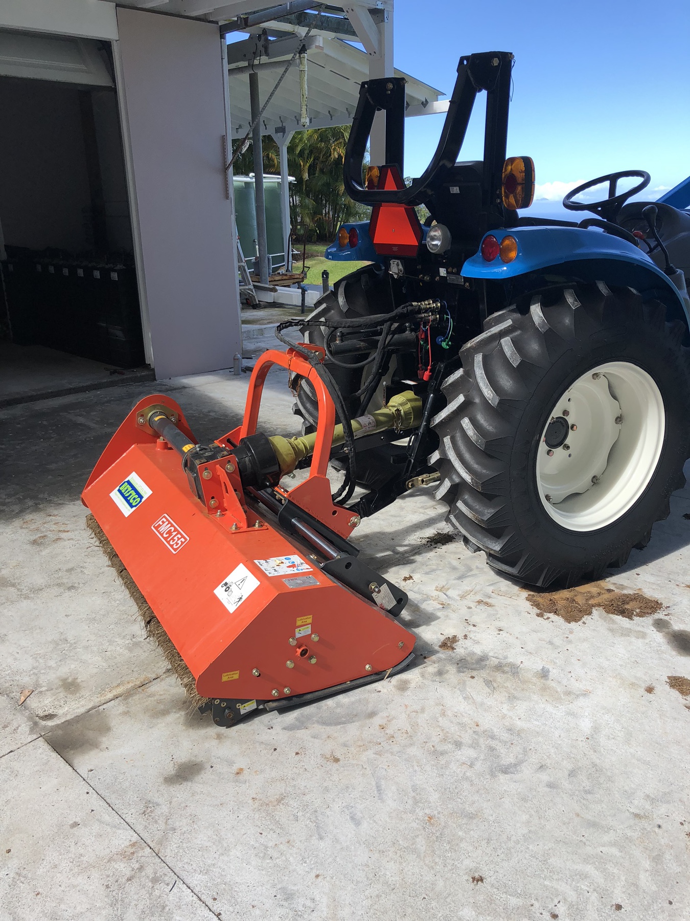

Got the hydraulic side shift kit installed on my FM155
Offset is enough to mow up to fence without catching tractor or tires, but not enough to effect balance noticeably.
So your FM155 comes centered?
