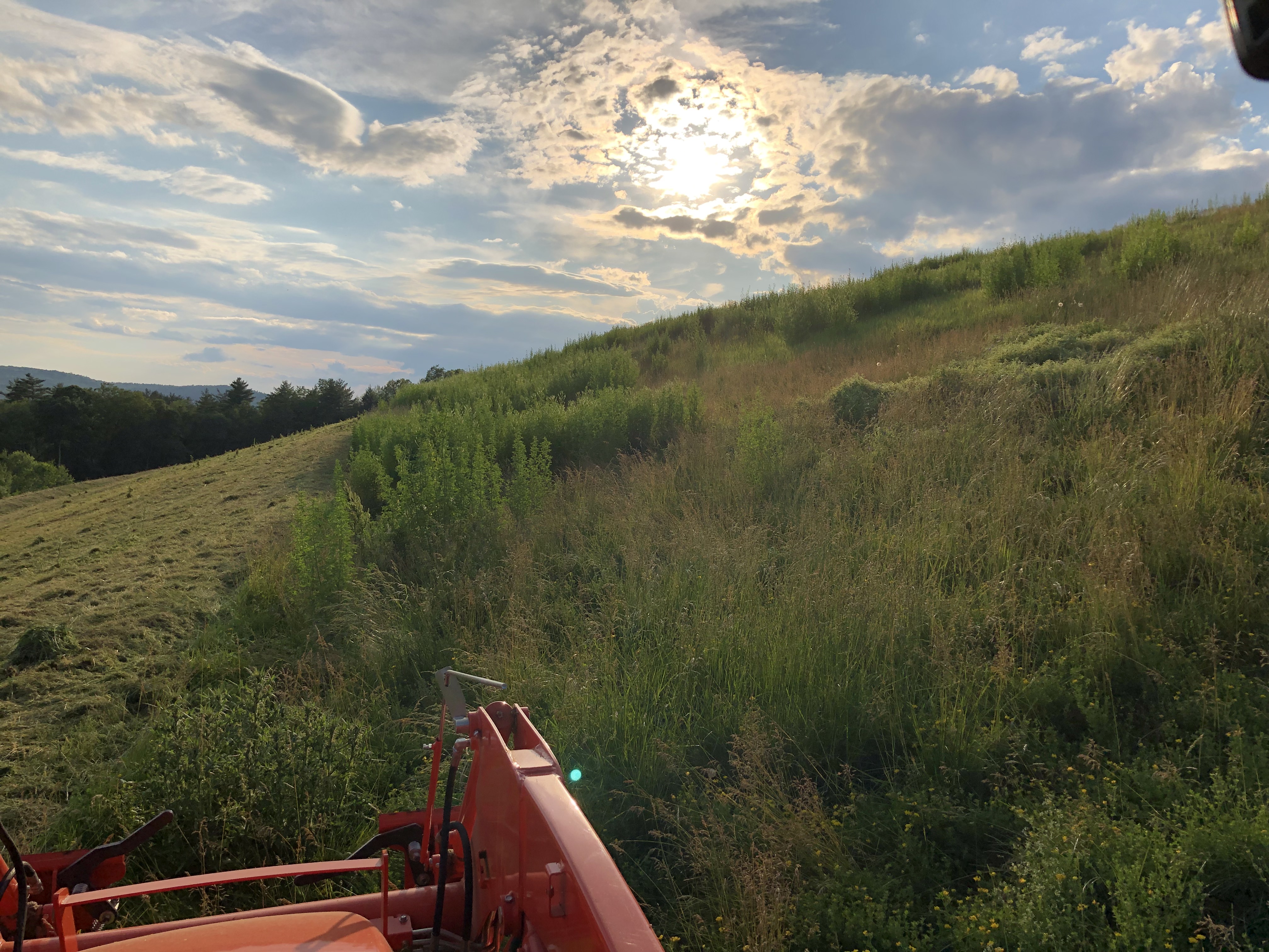

I got the offset, for $290 extra it's well worth it.
three uses for it - under fences is my biggie. I have a mile of horse fence.
over top of banks next to the road and similar sitiations where you need to mow a foot or 2 beside you but can't put you tractor there.
Third, trees...I can stay away from them.
And best, being offset it's MUCH easier to mow close to things (fences, buildings, etc) - first you can see it better sticking out and if you get too close you can slide it back in a bit and avoid having to stop, backup, steer away, etc.

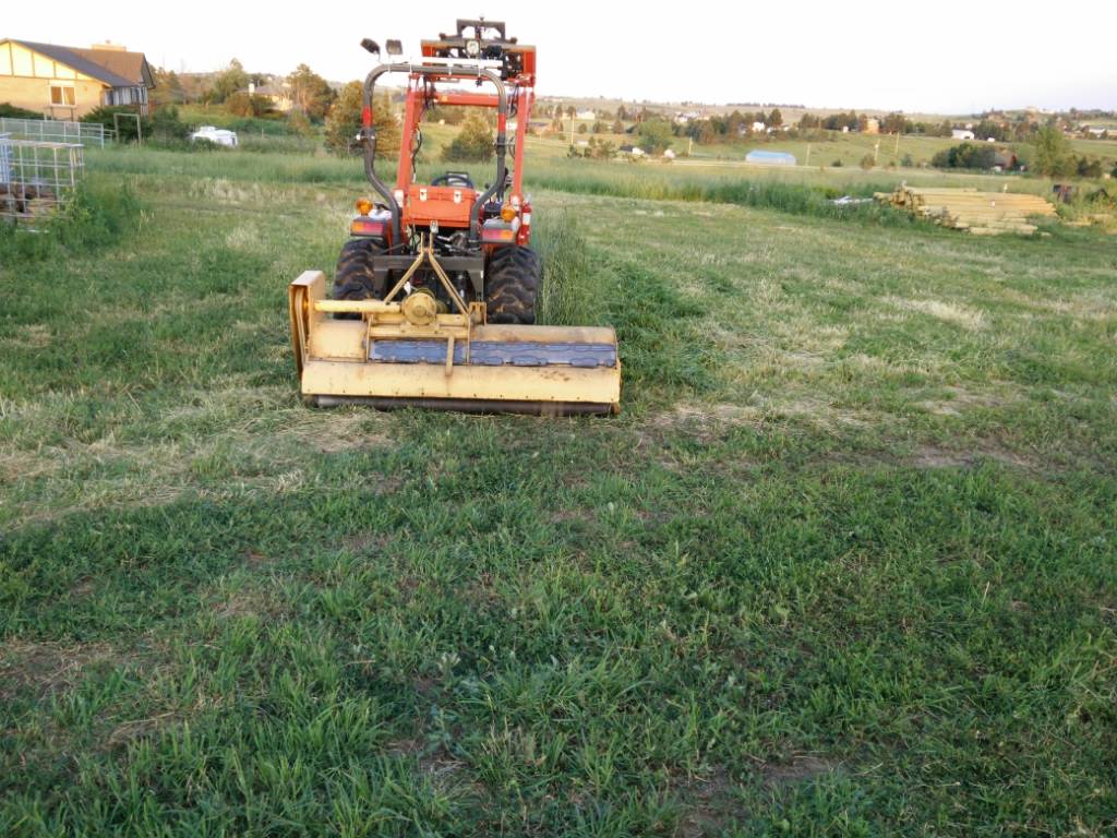

I find it interesting you guys are running such large flail mowers with low PTO horsepower.
Heck, my L2501 (same size as the L3200) only has 19 PTO horsepower (HST trans) and I run a small 4-foot flail behind it. That bogs down going through tall grass, especially uphill, although if you go slow it chugs along pretty well in low range.
I have 3" spacers on my rear wheels of this tractor and only a 4-foot mower. It's nice to have the mower stick out past the tires but not necessary. You just use another point of reference on the tractor while cutting (in my case, I line up the row to cut with the brush guard). Everything gets cut and the quality is very good.
/ Let's talk flail mowers #6,229
Maybe my grass is not as dense as yours. How do you rate it? If it was hay, you could say "X bales at Y pounds per bale per acre"... I actually do have a couple areas so steep (measured at over 50% grade) that I need low range just to go up regardless of whether I'm mowing or not).
I have 2-1/2" spacers on my wheels. I have the flail offset to the right, and as such my left wheels ride on already cut material, leaving only one track that gets smashed down and therefore not cut as well.

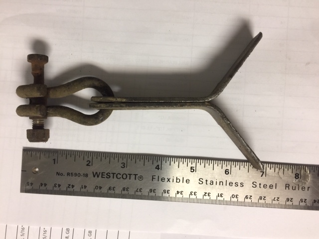

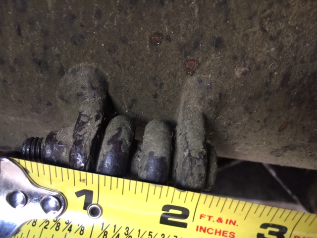

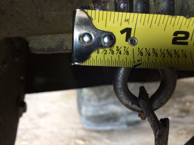

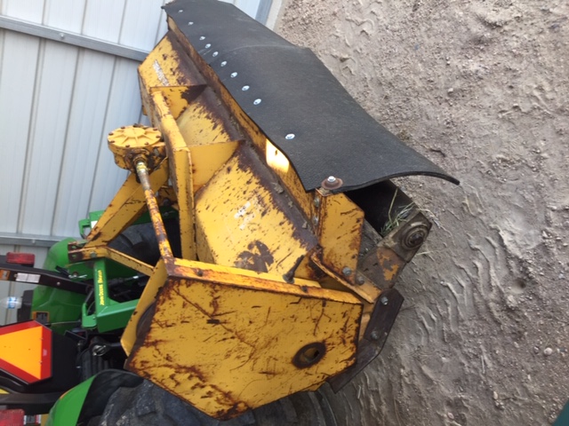

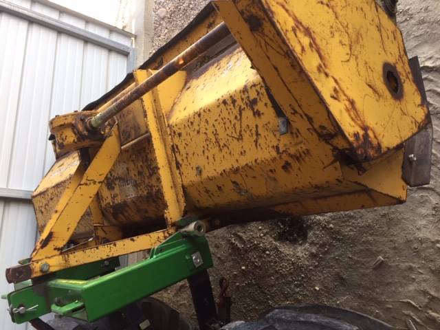

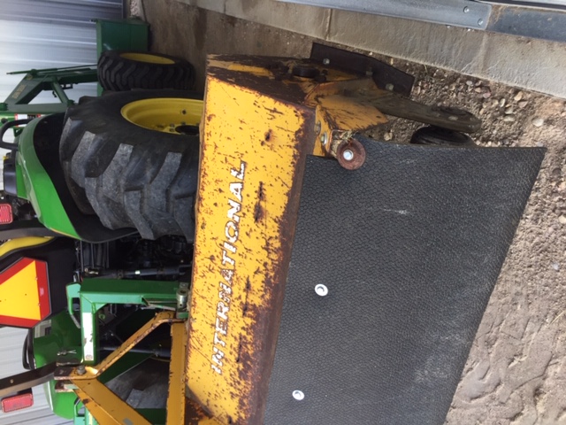

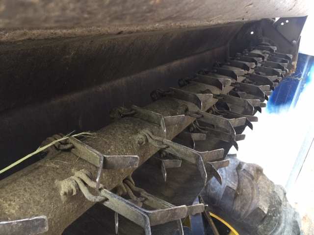

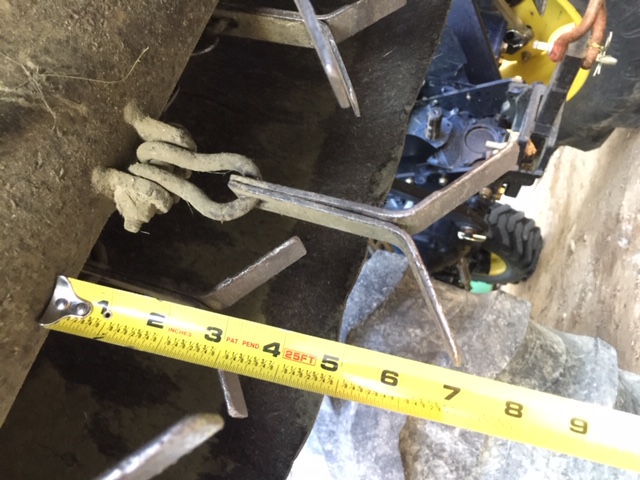

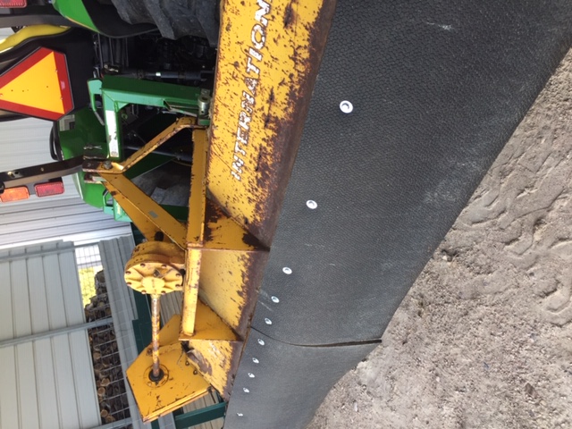

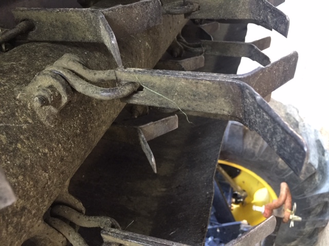

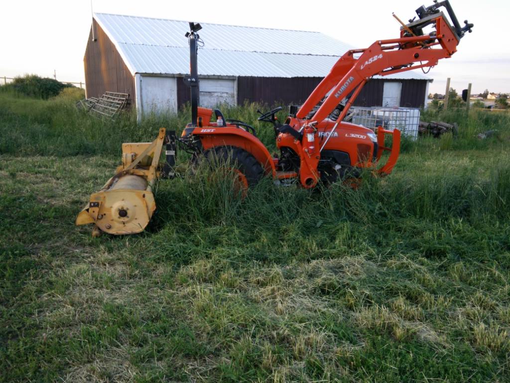

My dad bought this flail mower about 30 years ago at an auction. I think it came from the local college. We used it for 10 years or so, averaging only 20 hours a year. It sat for 20 years and I have started using again. About 40 hours a year
I changed the oil in the gear box, new belt, attached some home made skids... Its awesome I had forgotten how good this mower is!
Its missing a couple of the rings that the blades hang from. As I look around I don't see any setups quite like mine. I have read enough on this thread to know there are some experts on here. I'm hoping someone can tell me more about my mower and where I can get matching blade setups. I cant find any model numbers and haven't seen anything online. Ill put some pictures and I can get more measurements based on feedback.
View attachment 616644View attachment 616643View attachment 616642View attachment 616641View attachment 616640View attachment 616639View attachment 616638View attachment 616637View attachment 616636View attachment 616645

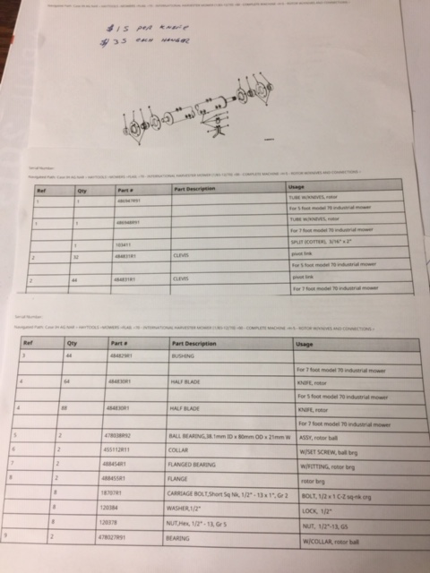

Ok here is what I found at my local Case IH dealer.
They can get them in orders of 10. the clevis is $35 each and another $30 per pair of knives.
I only need two clevis but over time as I need to replace more its going to be very expensive. it would be around $3000 for all new.
What about this.
I could replace the clevis with two chain links with close to the same weight and hang distance to balance and just attach the knives to that.
Then when it comes time to replace all the knives I can go with whatever knife I want and attach them to the chain links. if they are shorter that's ok I can just lower the mower.
If I could just find a hanger that would work I could buy whatever knives I want from Flailmaster.

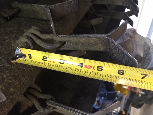

here are a couple more pictures and part numbers.

Hello noco,
Please do not use chain links to substitute for the knife hangers you will be asking for trouble. Please call flail master and see what they can do for you and the clean cutter folks in California if flail master cannot help you.
The shackles are a must have but you can buy side slicers from flail master at a very economical price. check with flail master to see if they have that type of shackle and tell them what size side slicer you have.
In order to purchase the correct side slicer you must provide them with the following:
1. the total knife length measuring vertically from the tip of the side slicer to the top of the vertical portion of the side slicer
2. the knife steel thickness
3. the diameter of the mounting hole
a. the distance from the top of the mounting hole to the top of the side slicer knife
4. you must use a protractor to correctly find the angle of the side slicer knives cutting edge. to do that you must have the single side slicer flat and then use the protractor to measure the angle of the cutting edge. Now very carefully bring the side slicer toward the center of the protractor and then you will be able to read the bend angle of the cutting edge. If its anything like mine its 37 degrees.
Its more important that you have the correct spare shackles for your mower. The knives you can buy in large lots if needed at a low cost per unit and the nuts and bolts you can buy by the bag at Fastenal.
Flail master may have them and you will not know until you call them.
