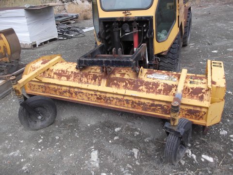

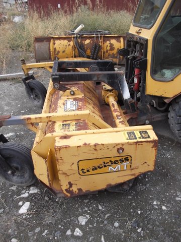

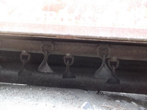

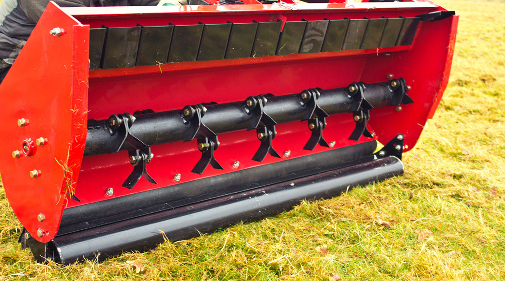

If a flail mower at my place looked that clean underneath, the only thing I would be sure of is that I could not afford it so it must not be mine.

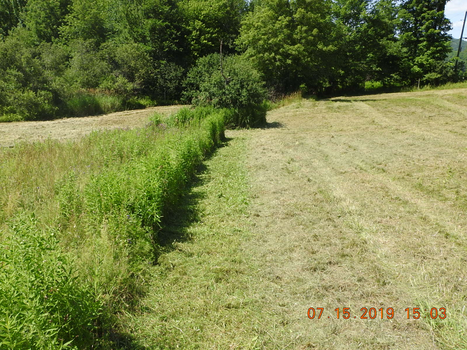

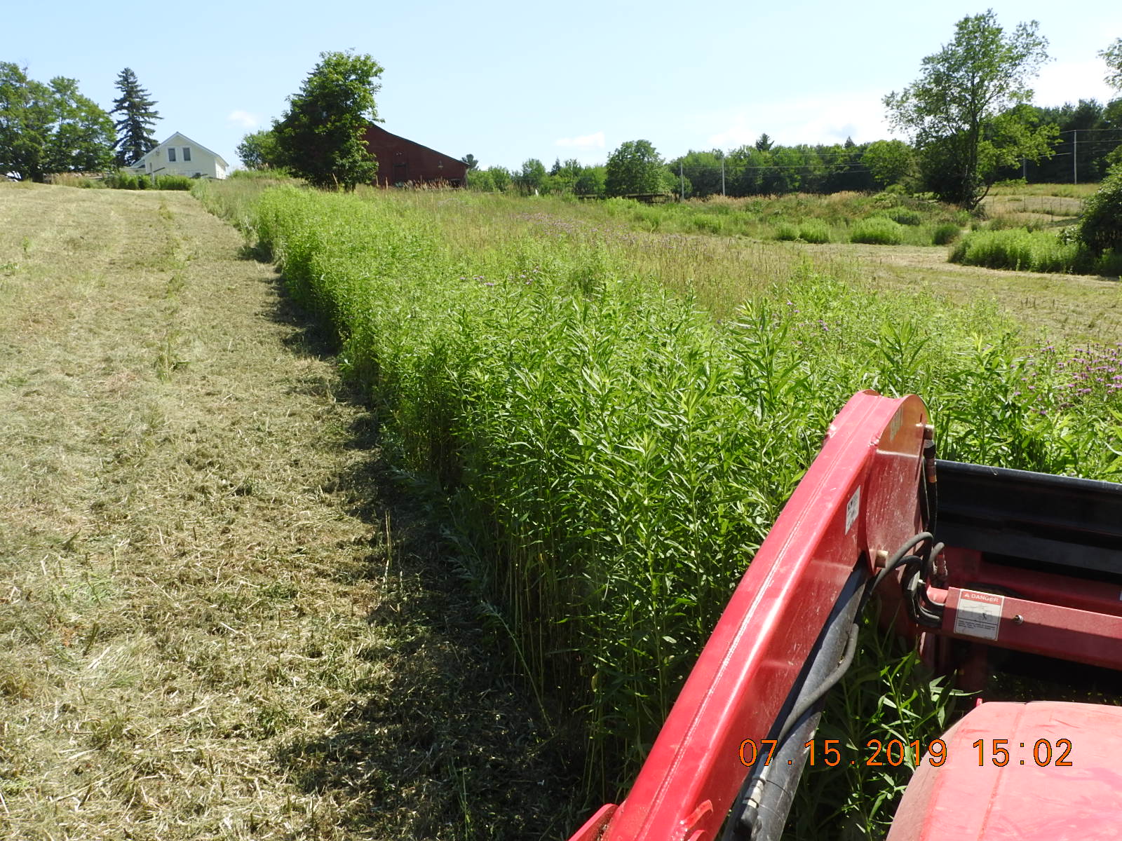

Pictures of what I mowed and what it looked like. I got the knives, not the hammers/duck foot.
