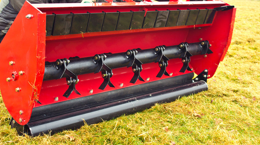

Hi guys, just called in, been a while .
Some flail mowers can cut cleanly with the rotor spinning in the same direction as the wheels . You will find that the flail stations on those rotors are attached to the rotor in straight rows along its length . There can be 3, 4, 5 or 6 rows .
Imagine a rotor with 4 rows, each row is mounted 90 degrees apart . As the mower moves forward, lets say a foot and the rotor has revolved twice in that foot of forward travel . The blades have struck the grass 8 times .
Now imagine a helical/spiral mounting arrangement that many mowers use now , and rotate in the opposite direction to the wheels and only have ONE cutter per spacing .
As our imaginary mower, now with a helical rotor (using the same blades)moves forward that same foot and the rotor has revolved the same two revolutions, the blade has only struck the grass twice . This is why people get crappy results when the try to cut going backwards with a helical rotor type flail (the roller also holds the grass down that makes it worse).
Gearing on helical rotor flails is tall to keep tip speed high which helps overcome the fact there is only one blade per position . The advantage of the helical design is that there are only 3 or 4 blades contacting the grass at a time, unlike a full row in the straight type rotor .
Also, helical rotors need big counterweights for balance, straight row rotors may just have a little one, as the straight rows at equal spacing balance themselves out .

Re: Flail mower basics and knife rotation

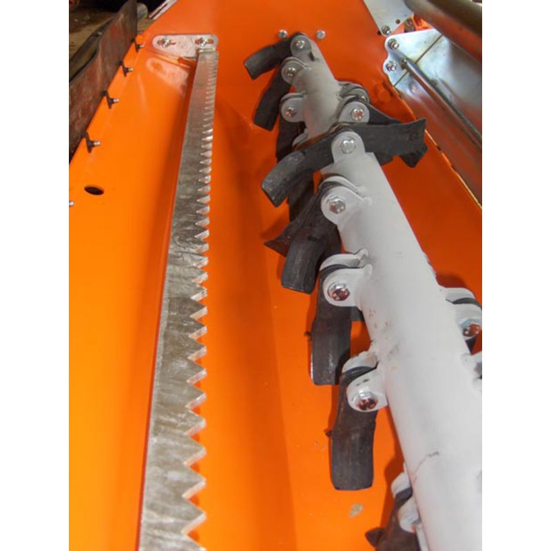

Straight rotor in red mower, helical rotor in orange mower .
