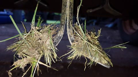

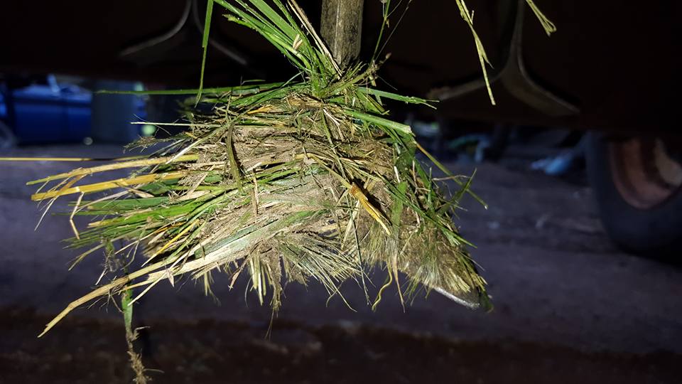

The other night, while flailing away at my grassy verge, I realized one of the reasons why I am so impressed by my mower: it doesn't sound like it's working.
You know, on a finish mower or brush hog you hear the blades cranking out. On the flail you don't hear anything. It's like it's not working, except that the grass comes out the back pulverized.
It's a psychological effect, but effective it is.
