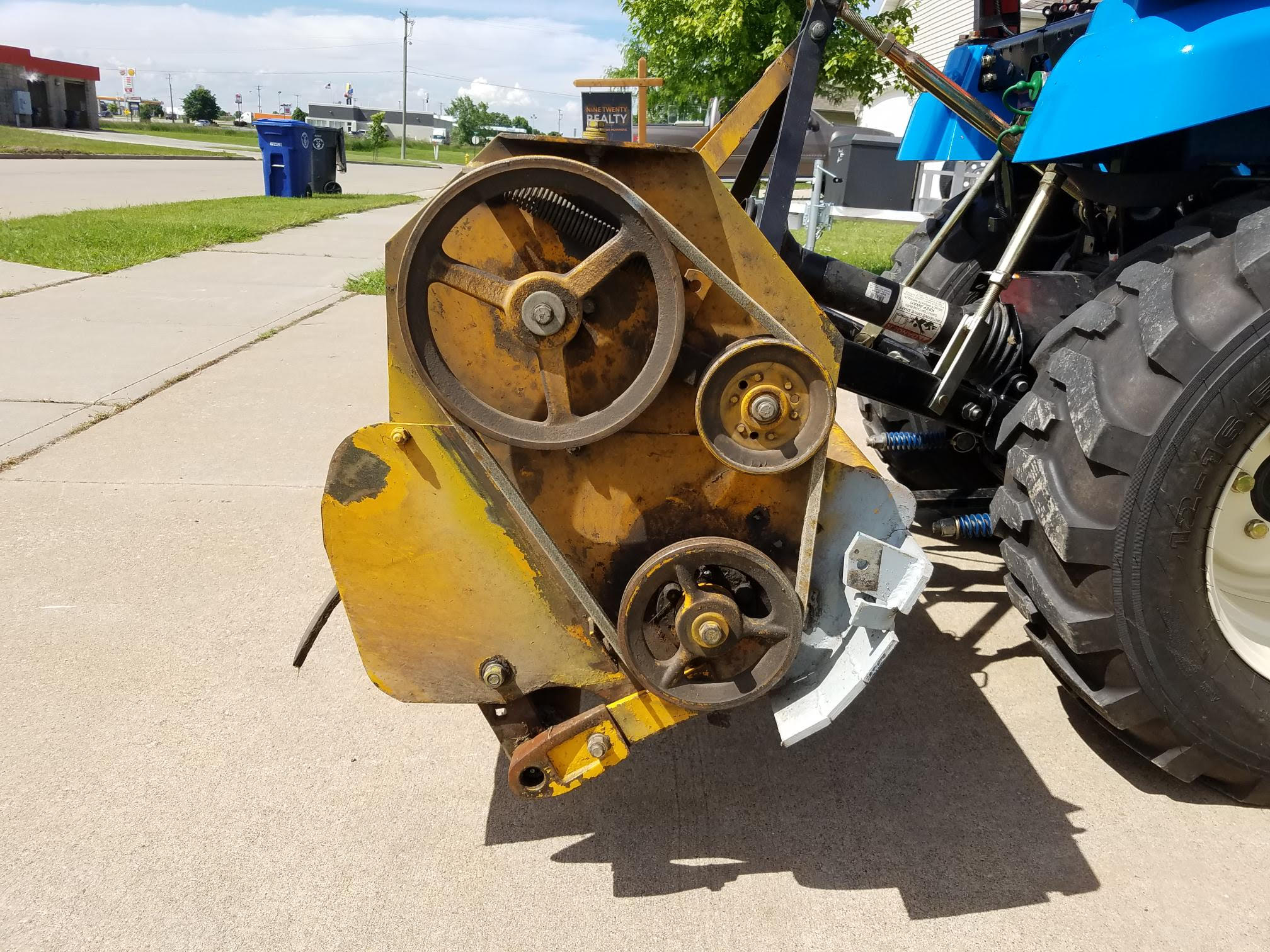

On this mower do the flails turn to opposite direction compared to one with the pulleys on the other end of the gearbox?
Opposite direction of the rear wheels . . .
/ Let's talk flail mowers #6,062
thank you all for the quick responses my little LS tractor with its 18.5 pto hp isn't exactly a power house, but it runs most things alright. at the time i bought the tractor i had a 4 acre lot that it was perfect for. Now i have that and a 12 acre lot... i need to look into a bigger tractor in the future soon. i'm using it to mow a field that has been planted with beans every year but now this year since i am working on developing the land for residential use it is a field of weeds that i need to mow down once a month.
The rpm idea is a good one, the motor can definitely rev higher so i will see how that works. also this is just for general field cutting atm, so i'm not looking for a perfect cut or anything just wanna get things taken care of. i've only tested it mowing a few short times on an overgrown lot here in town by where i'm currently renting and it didn't bog down the tractor, just didn't cut worth a darn. so before i take it out in the field with 2.5 foot high grass/weeds i want to make sure it will actually preform.
I will try a blade sharpening, some higher rpm's and make some adjustments and see what happens, still not sure about that gearbox though without a vent though.... :confused3:
D2Cat the pulley's all turn clockwise if you look at them like this unnamed7.jpg the flails go the same direction as the tractor rolling forward. should it be going the the way?

Your flail mower is set up to discharge forward as you mow. I know this because your flail mower
has a second stub shaft to allow it to be used with clockwise rotation of the flail mower rotor as
you face the left side of the flail mower. You can mow in reverse and improve the mowing finish
if you wish to do that.

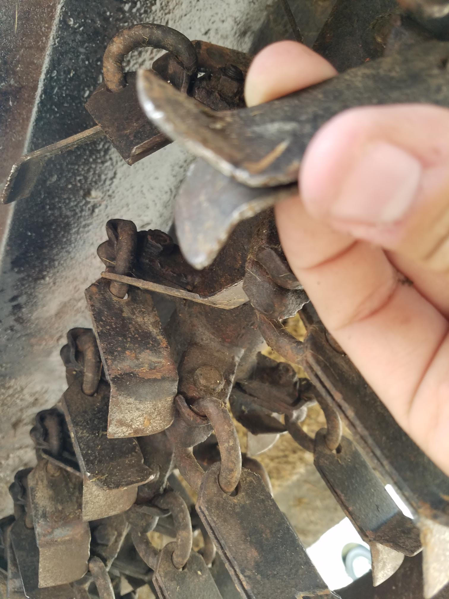

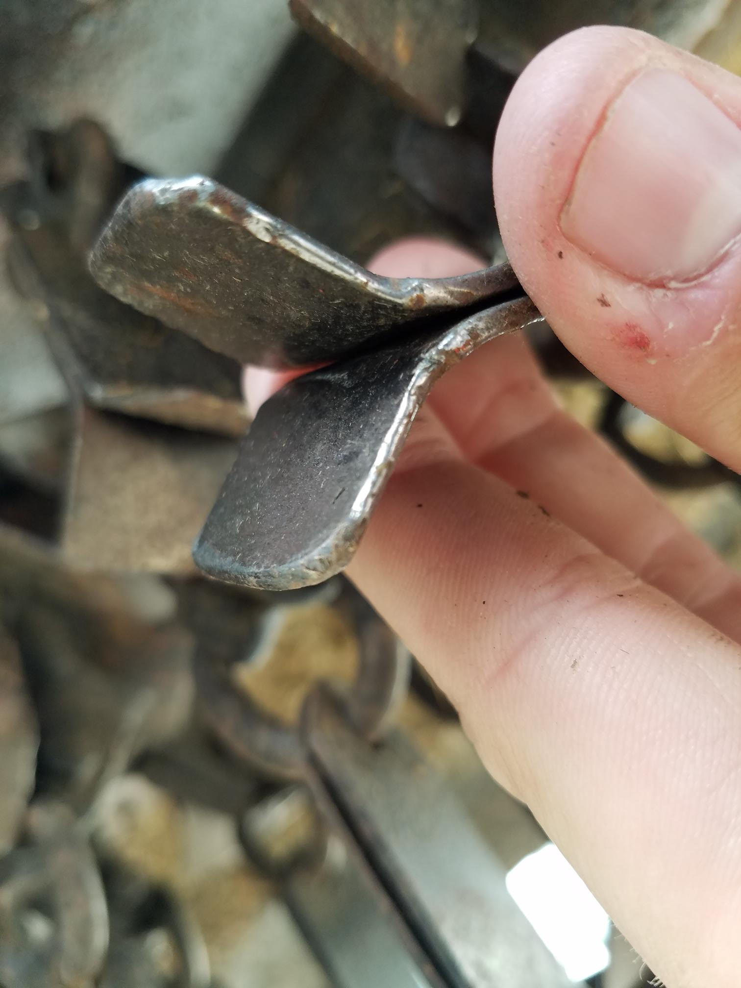

Thank you for the welcome, a little more info on why i'm concerned about it being a 1000 PTO speed unit, when i picked the unit up the owner had a IH284 which to my knowledge has both a 540 and a 1000 pto setting. me being stupid didn't think to ask about the pto speed the unit was used on, and now the owner has passed so my window has closed on that bit of info.

NOW as to the side slicer knives you have, they are the thin grass knives for your mower.

You have to be very, very, very, careful when dry grinding them or if you have access to a table belt sander with a
fine grit paper that will work in a pinch. I much prefer using a low speed wet well grinder and set the angle on the
tool rest at 37 degrees and cool grind away.

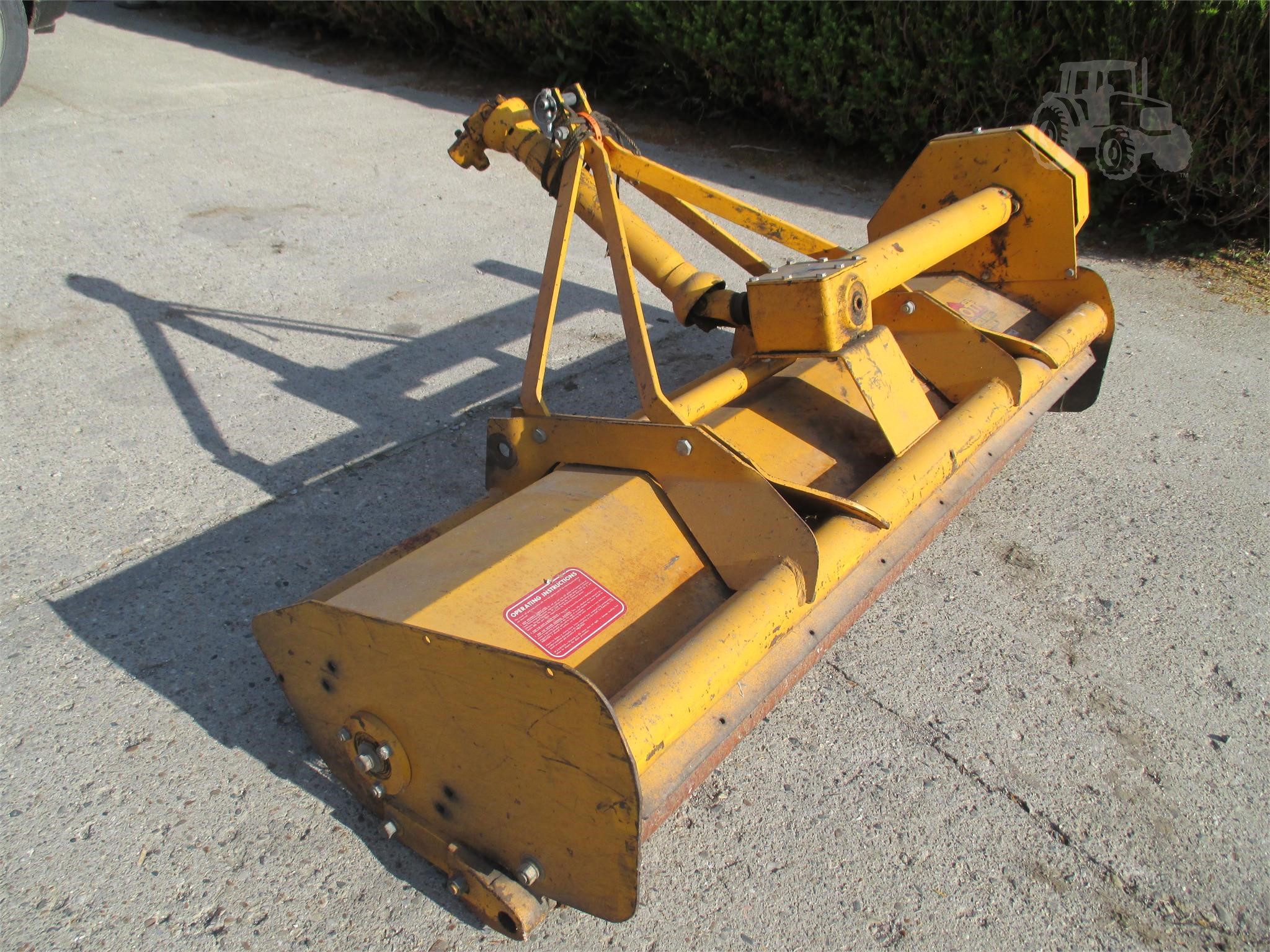

I'm fairly confident that his mower has the 1000 PTO gearbox on it
His mower: unnamed1.jpg small square gearbox.
1000 PTO: unnamed2.jpg small square gearbox.
540 PTO: unnamed3.jpg large round gearbox.
The size of the gearbox tells me that there isn't enough room for the large ring required to get a 4:1 ratio, only enough room for a 2:1 ratio.

D2Cat the pulley's all turn clockwise if you look at them like this View attachment 610203 the flails go the same direction as the tractor rolling forward.--------------------
Right, clockwise looking from the right side. Anytime there is an idler pulley it will be on the slack side of the belt, especially if it is spring loaded.
