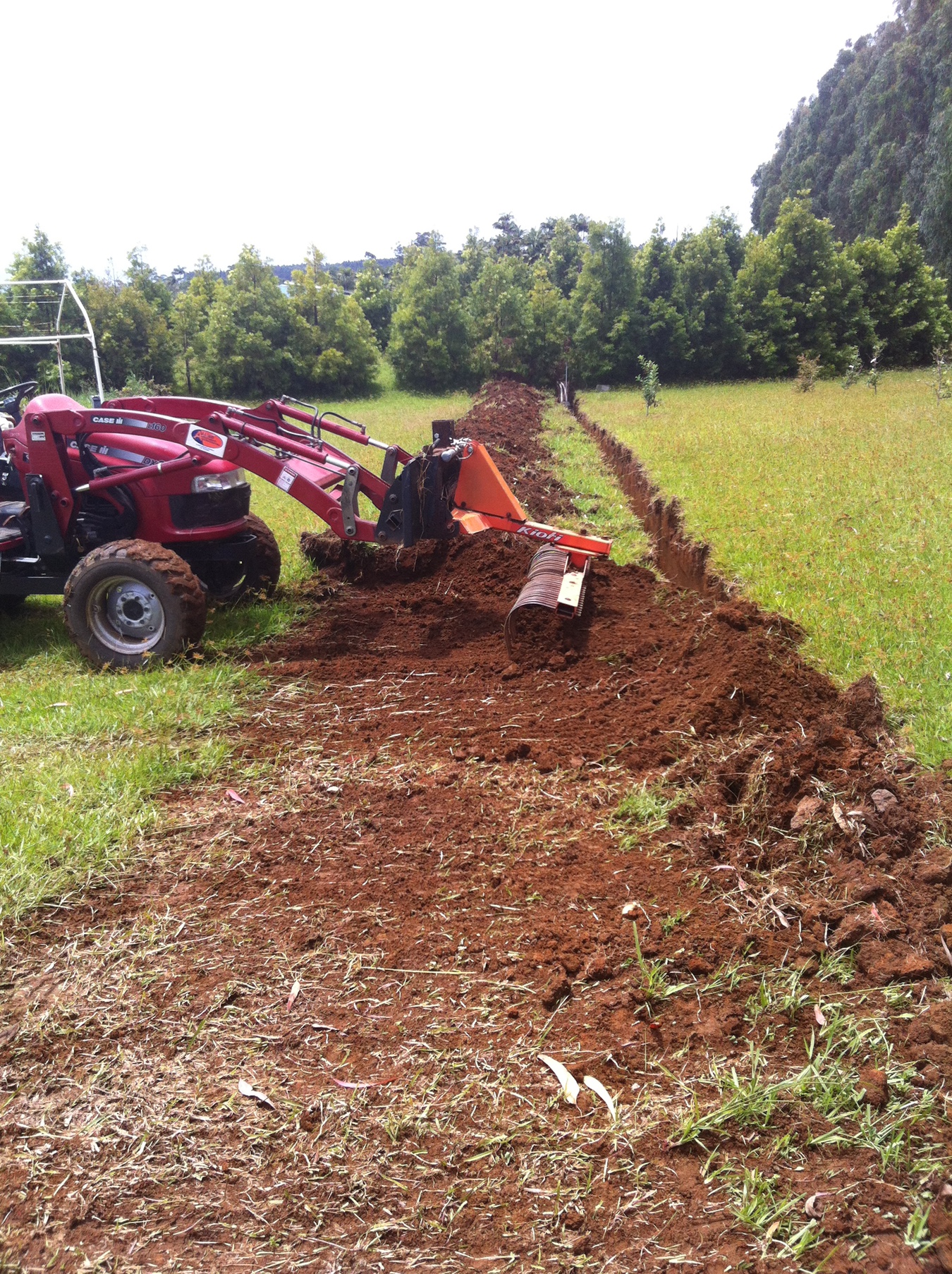

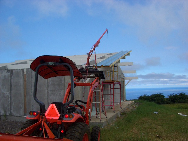

I did that as well. Mostly to mount the 3 point boom pole w/ extension when we were building the house. Hitch didn’t weather well so I’d like to remove from quick attach plate and remount a new hitch. Found the landscape rake quite useful mounted in place of FEL

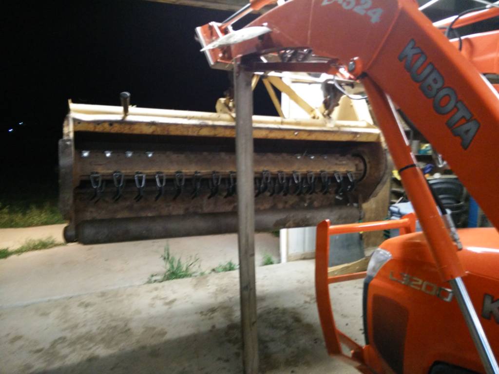

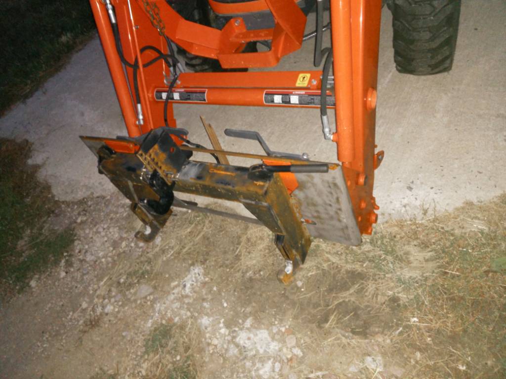

Pretty much like this, just homemade from the 2 components.
I made one as a snow plow mount. Worked well until the plow sold with the old tractor. I just welded a QH to a SSQA plate. Probably should have painted it. Made for a nice way to lift & flip the flail for easy maintnance. Used it for moving & loading other impliments as well. Have a spare SSQA plate & QH to make another, but haven't gotten around to it yet.

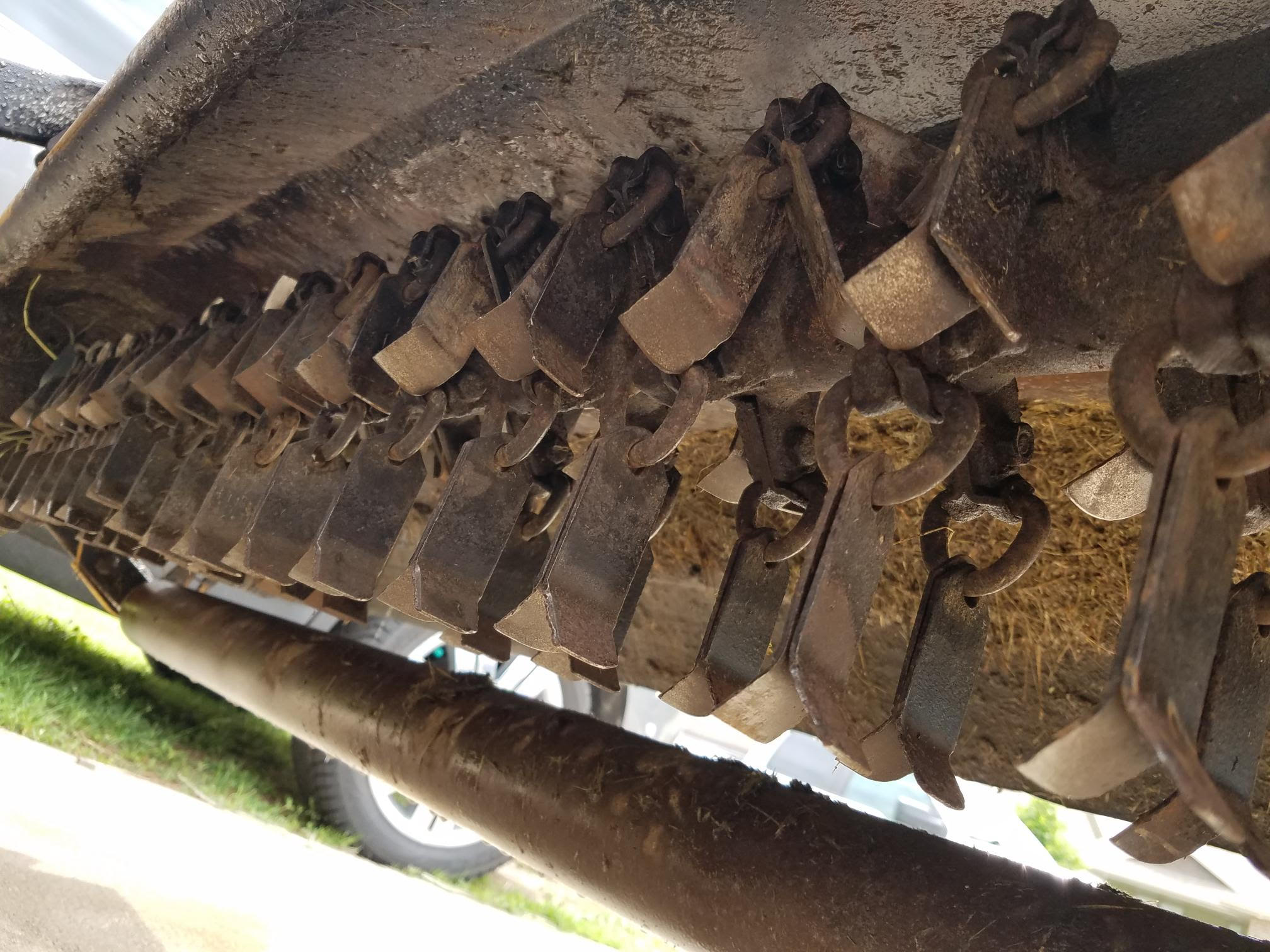

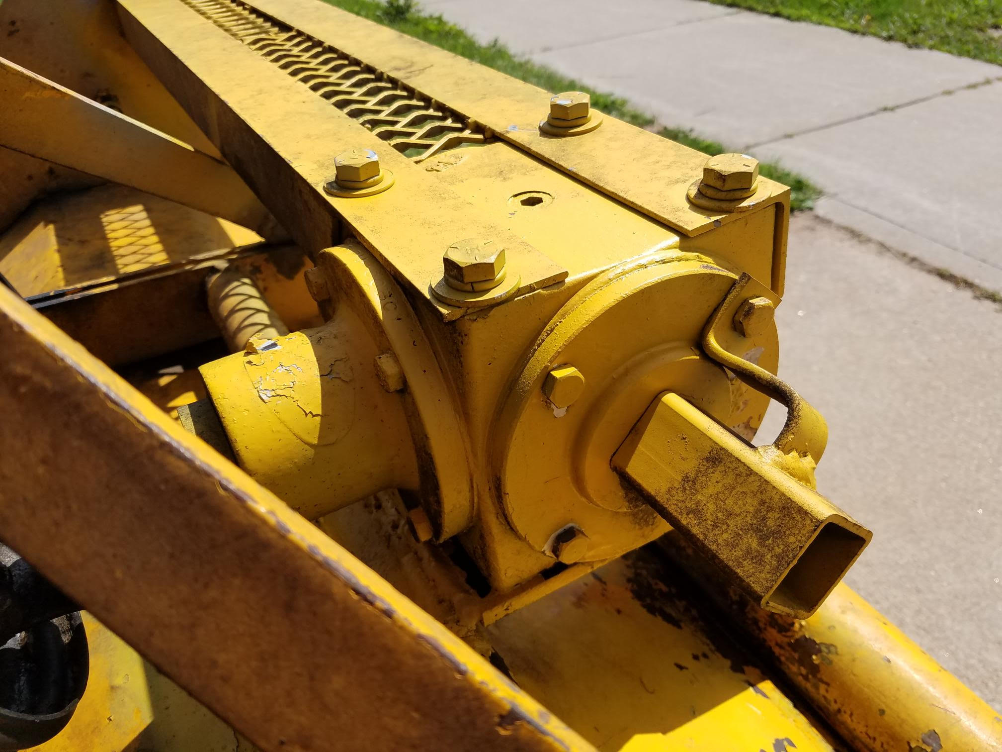

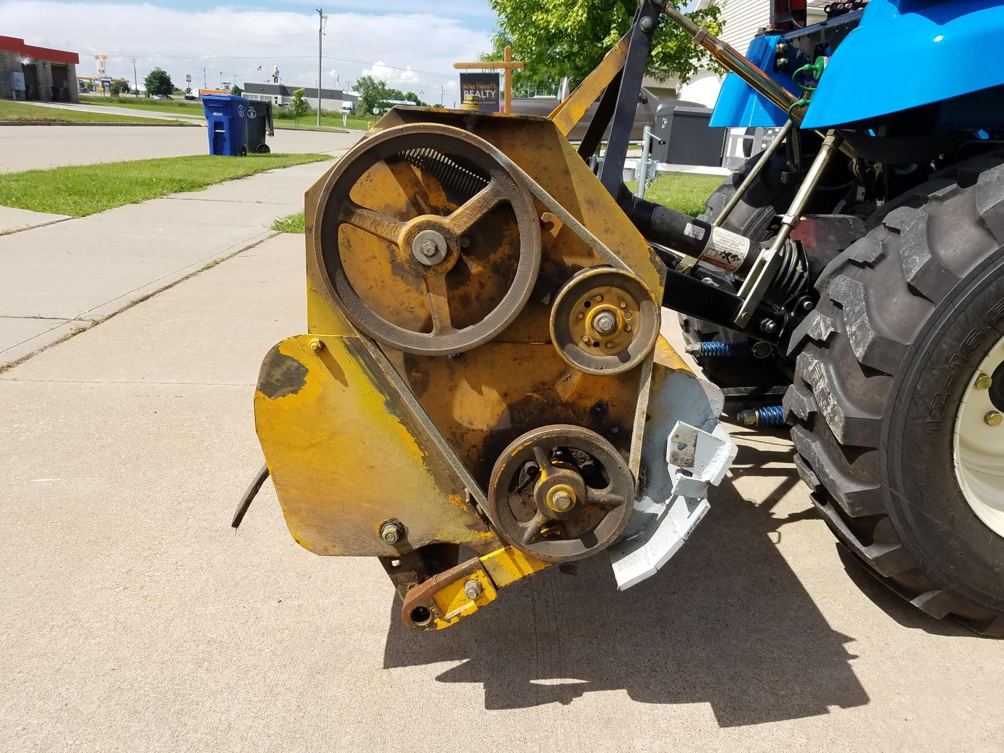

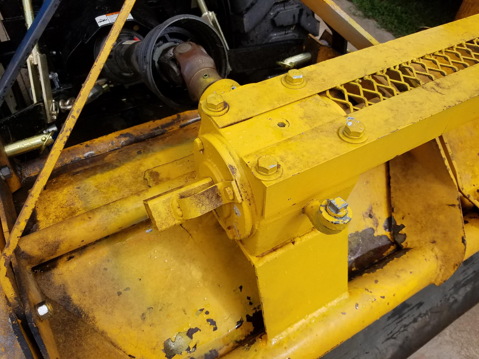

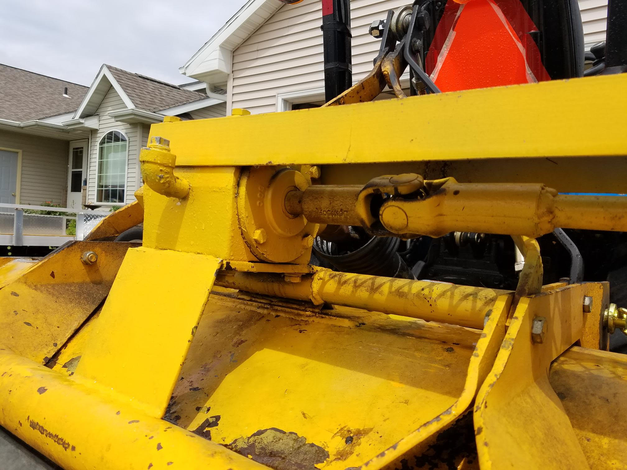

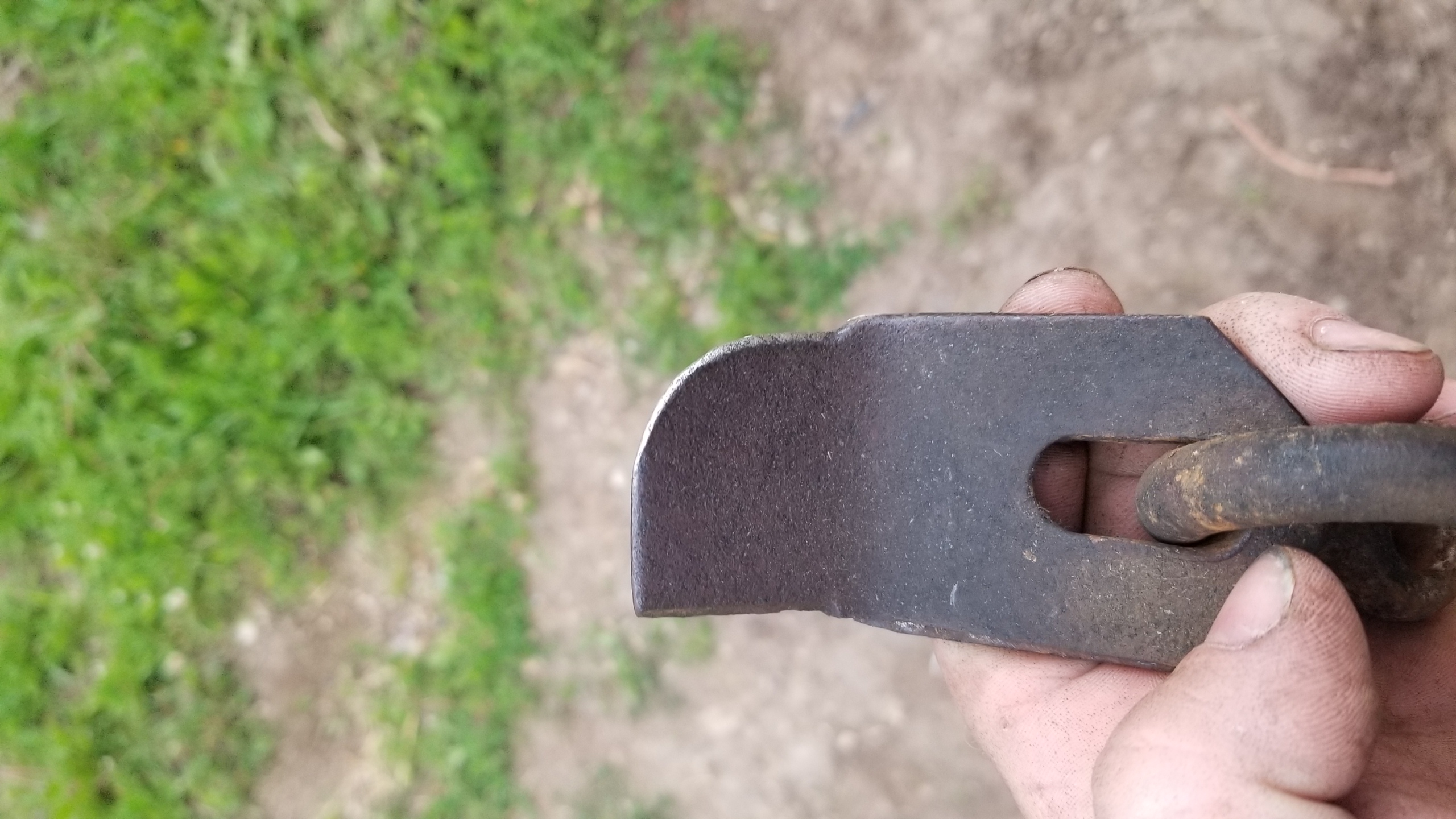

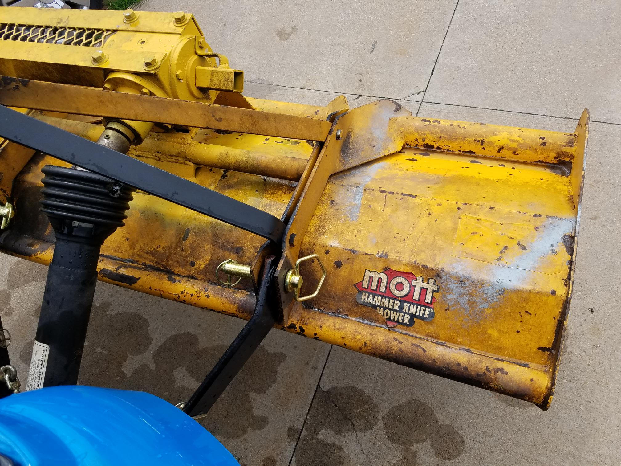

I'm a flail mower noob and looking for help on this one, I picked up a 60" Mott mower cheap but I'm afraid that i messed up and the gear box isn't for 540 pto speed more like 1000 pto speed, I know the Knifes are dull but it just doesn't seem to work all that well at my tractors 540 pto speed. but i'm not an expert on flail mowers (I've read though much of this thread over the years but still no real hands on experience) I'm thinking the unit is a Mott J60 if it needs 1000 pto speed, is it all in my head? I also believe that the gearbox has been replaced at sometime in the past.
So does anyone know how many rotations the knife drum should go with one revolution from the pto shaft on a normal 540 unit?
also shouldn't the gearbox have a vent somewhere?

If you are running it with that LS you have listed in your sig . . . PTO is only 17.5 hp . . . that's a 5' flail . . . maybe a little short on hp.

It IS for a 540 PTO. As stated before your HP may be a little lacking but if your tractor will rev higher than the PTO speed, you can run the Mott up to 700 RPM without any problem. I'd suggest you try inching the tractor RPM up by 100 at a time to see if it helps. You may also try raising the blades by lengthening the top link. That will cut higher and an extra inch less for the mower to cut may help also.

Agree, but if the grass is tractor hood high . . . you may have to crawl along, or as whirly suggested pour the coal to it, and still crawl. ;)
/ Let's talk flail mowers #6,059
On this mower do the flails turn to opposite direction compared to one with the pulleys on the other end of the gearbox?
/ Let's talk flail mowers #6,060
Looks like the rotor spins same direction as your tires. Try taking a half width cut and see if it does better, if it does, you are trying to cut too much for your tractor hp. What are you cutting? Really high or thick grass? That takes the most hp.
