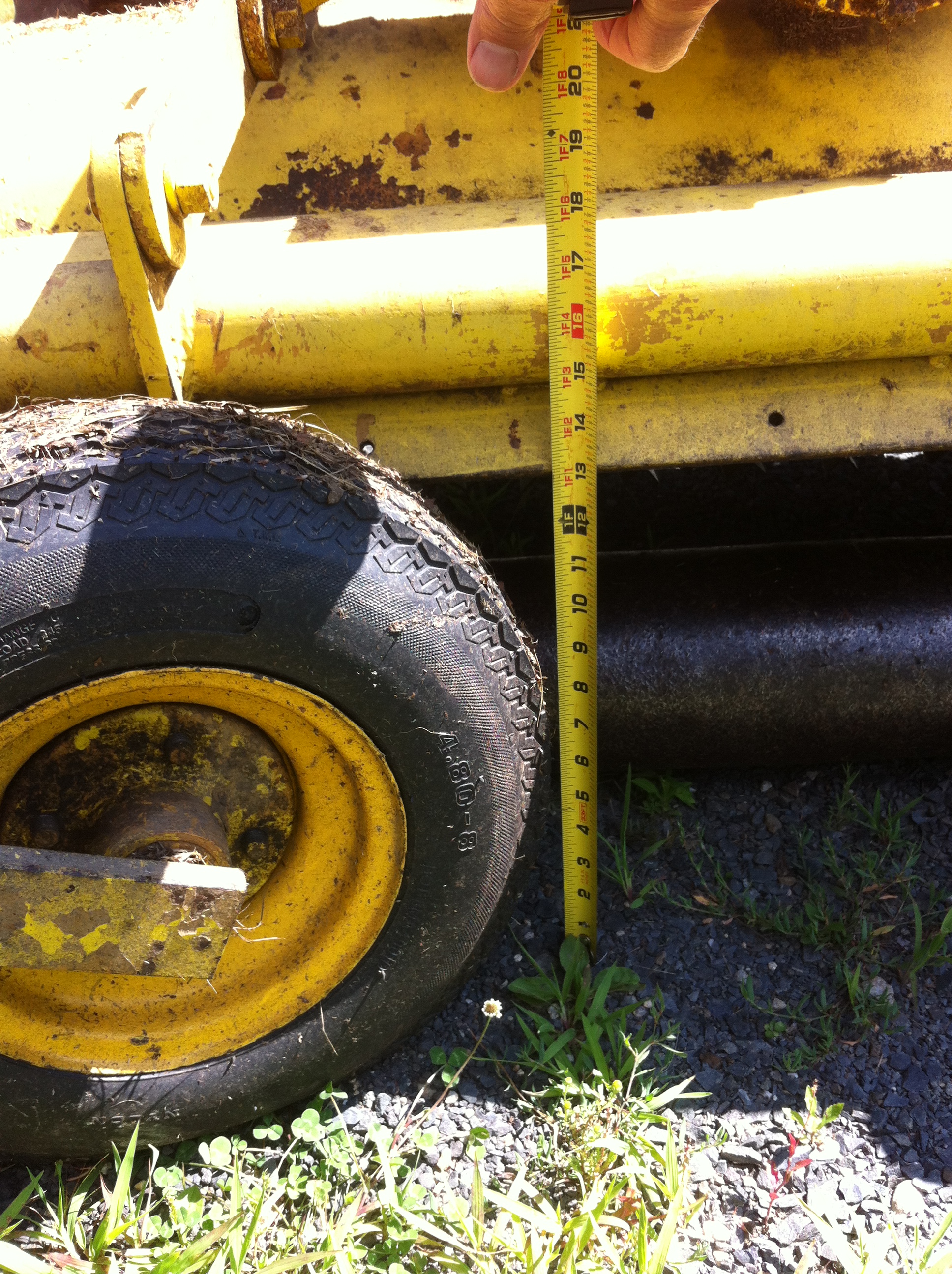

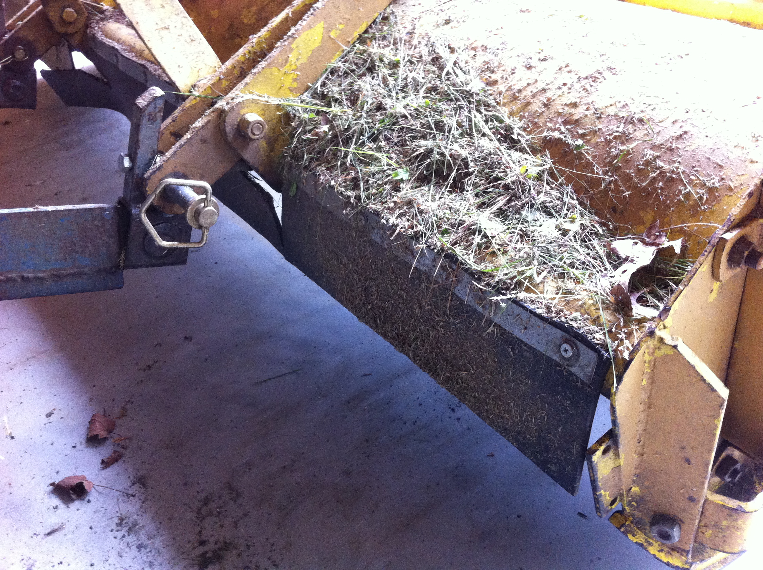

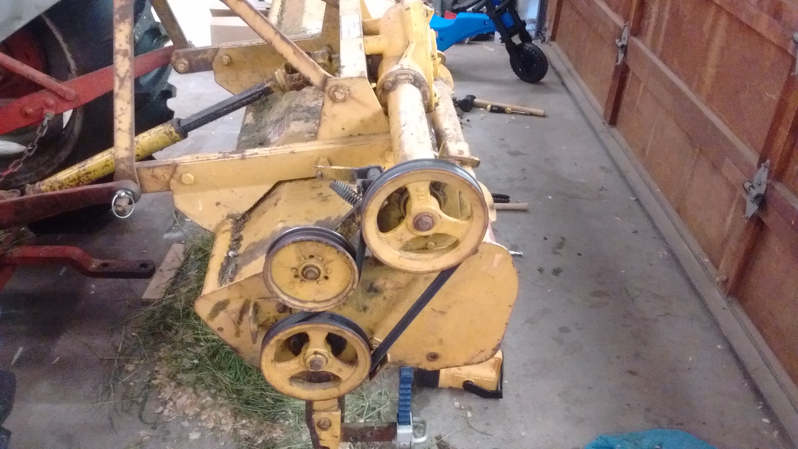

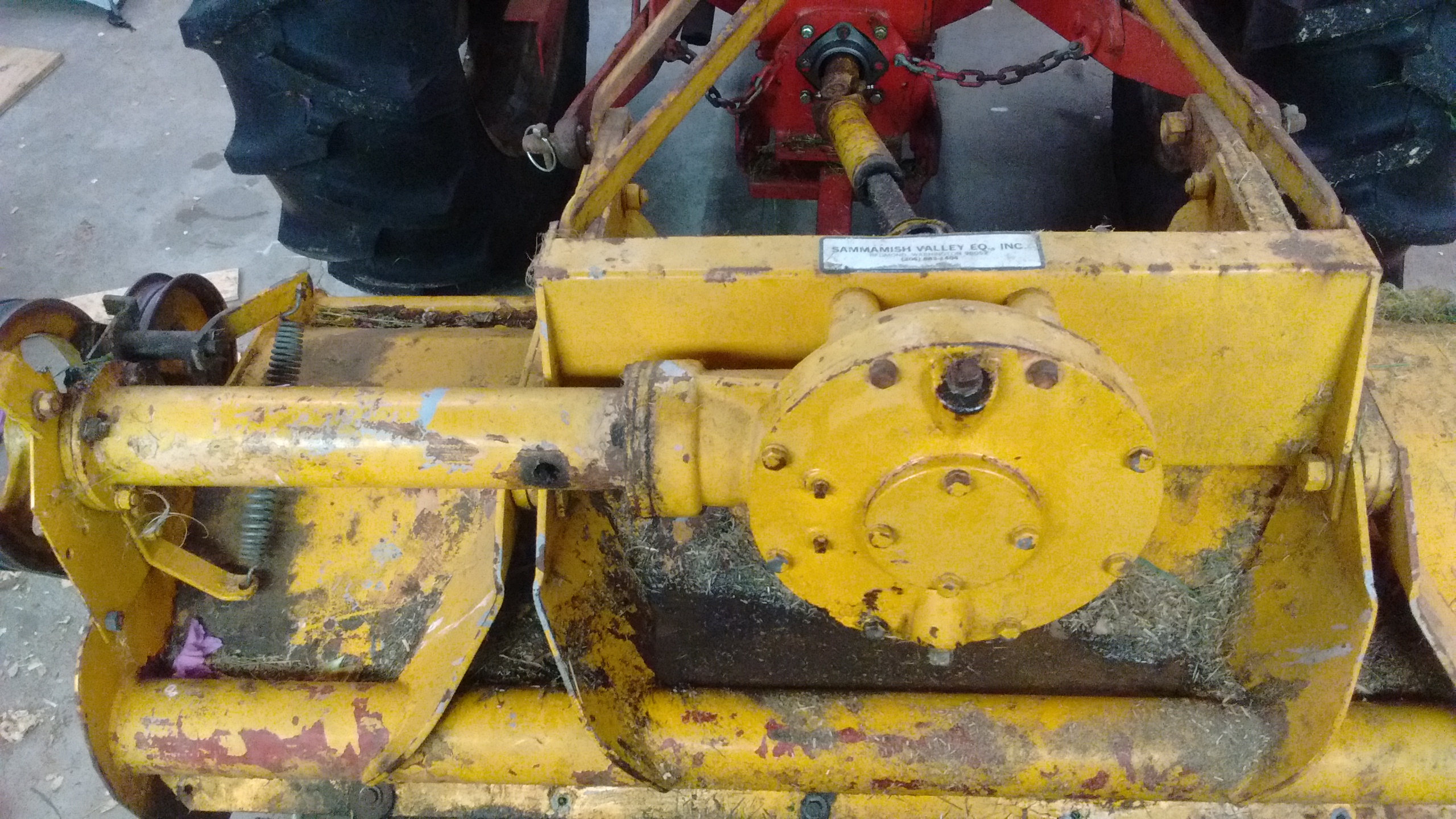

No it is a 918H, the gear box is way different than the 917 uses as you can see in the pic. I have decided that I am expecting more from this mower than it can deliver and am throwing in the towel. After all the sharpening, adjusting, resharpening and re adjusting, plus now I am finding parts availability is limited, should have done more research. I'll hold on to it until I find something else since it being an offset does OK on the county road that I keep the shoulders cut on since the county can seldom be bothered to cut them.
I am not expecting it to cut like the finish mower a bit rougher cut is fine since it is a large area that is kept cut for the appearance of the property. But the mohawks of uncut grass standing up are just not acceptable although reversing the rotor rotation did improve it somewhat. The old King Kutter bush hog with sharp blades will do a better job than the flail has so far.
I really appreciate all the help and comments, thank you all. I just got burned on this one, my mistake thinking New Holland would be a top quality product, I do have to say at least it is solid and well built. I will have to do more and better research before getting another, if I do. There are many things about flails I like, just not the quality of cut. At least not the cut from this one.
Is that OE bracketing on the mower in the photograph? Looks very stout...just what I need on my Titan flail.
/ Let's talk flail mowers #6,004
Yes it is OEM, a very stout, well built mower.

I apologize if this is a repeat, but is the belt tension and replacement on the 918H as involved as it seems? Any advise or workarounds are very welcome.
/ Let's talk flail mowers #6,015
It is so easy you could do it blindfolded, here is the procedure from the manual. Takes longer to remove the belt shield/cover than it does to change and adjust the belts.

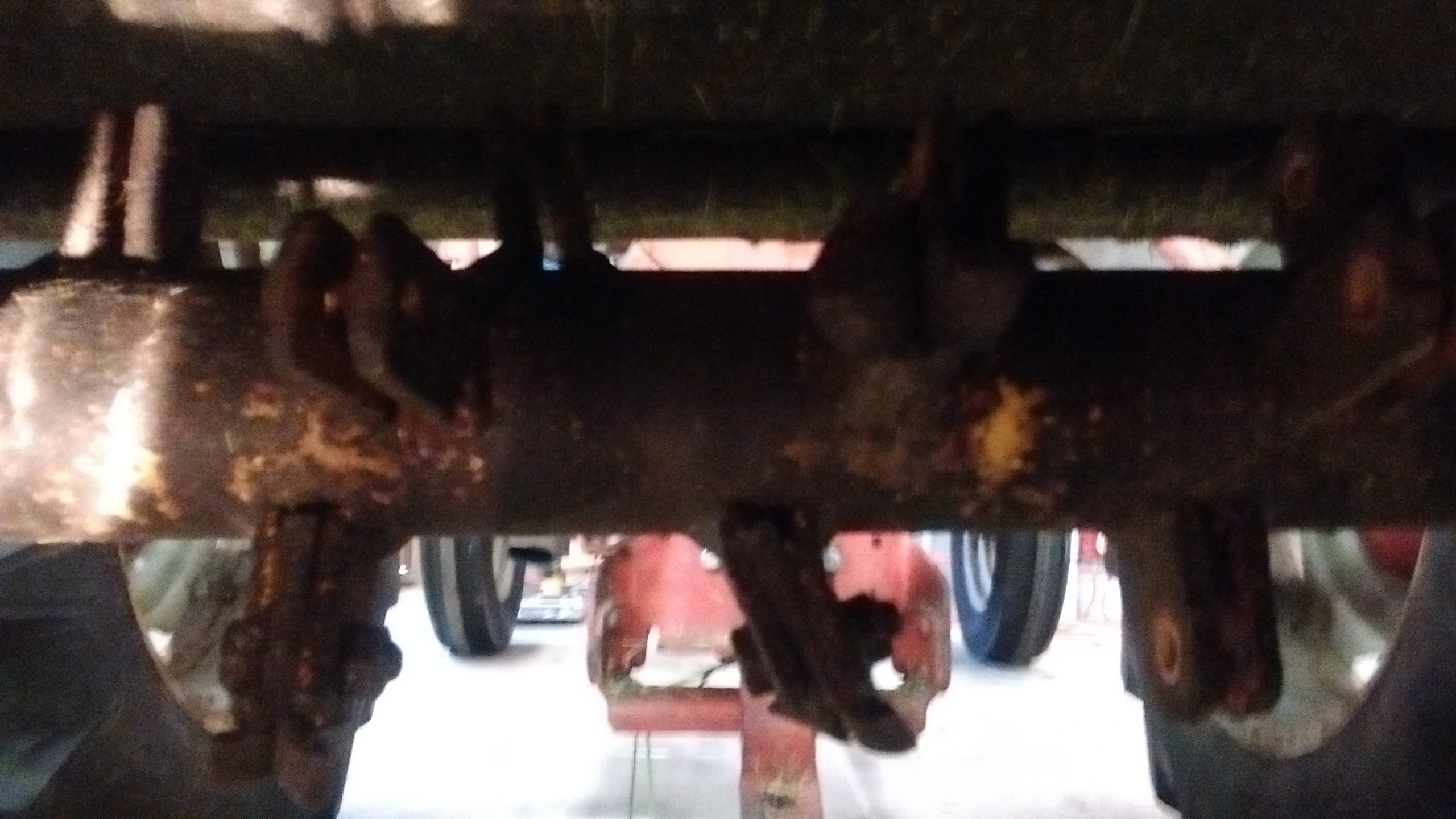

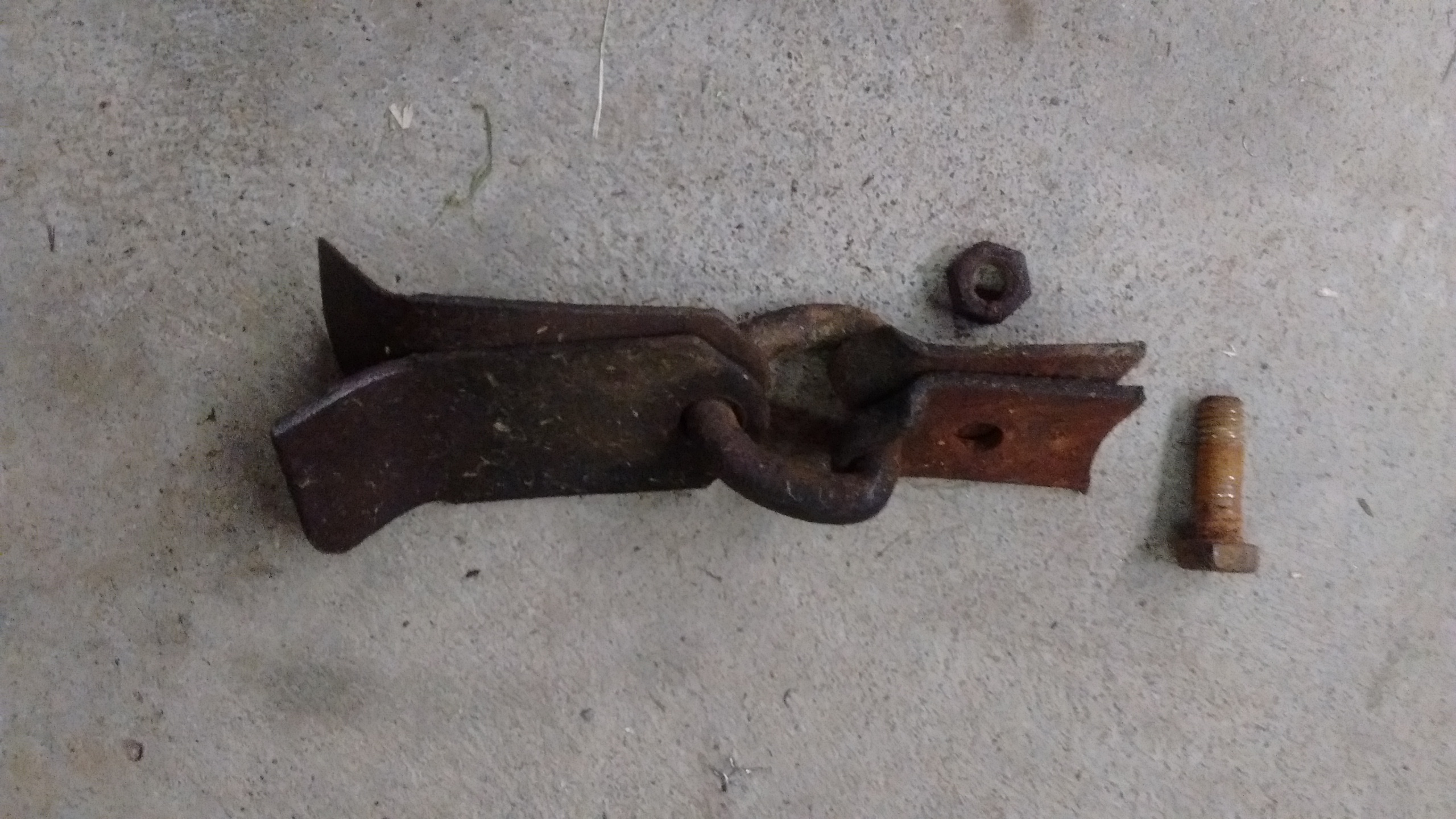

Haven't read the whole thread guessing been almost a year since I checked in. What are you guys calling "Hammer blades" I have two John Deere 25A's one with ducks foot and one with Y blades but first I heard of hammer blades. I don't see allot of difference between them, both leave a strip of grass where the wheel mashes it down. Been so wet this year I have only been able to mow once, after it dry's out I'll have a better chance of seeing how the Y blades do.
/ Let's talk flail mowers #6,019
Woodmaxx calls Duck Foot Blades, Hammer Blades. .
