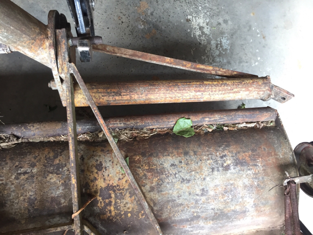

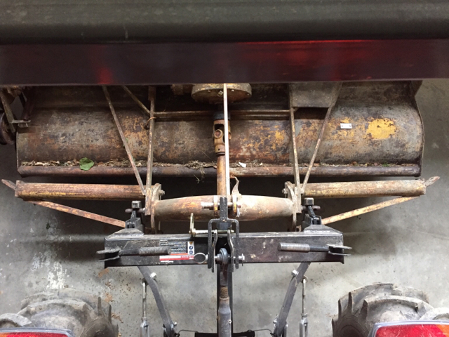

Sorry, Hunt... I have not had that issue with my Caroni, but I have a question...
The rear roller has what I would call a 'scraper bar'. I could not figure if that was a help or hinderance. I took a clamp and secured it to the top underside and run without it; I cannot see a difference? Does it have a specific purpose?

I think that scraper is just to keep stuff from wrapping around that roller, I've never had a problem with it and it keeps my roller clean. Why don't you like it doing its job?
Yeah, I think this is my 4th season (maybe 5th) and I like the way it works. The thing I miss about a rotary mower is the ability to back up and cram it under a tree or something..

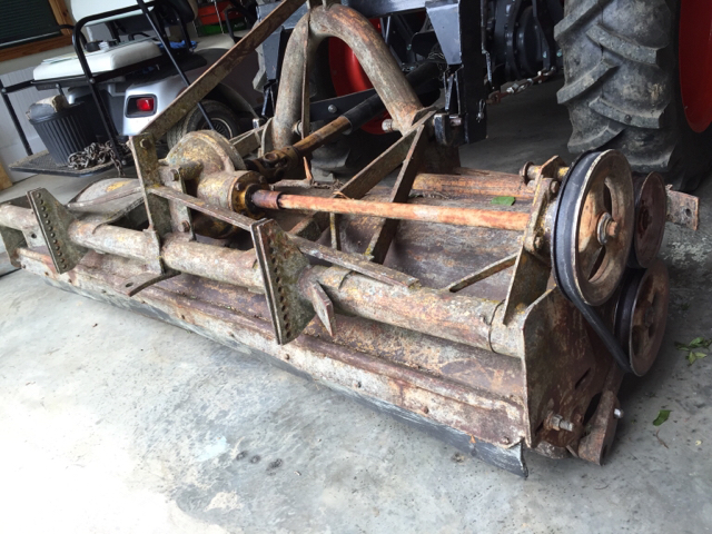

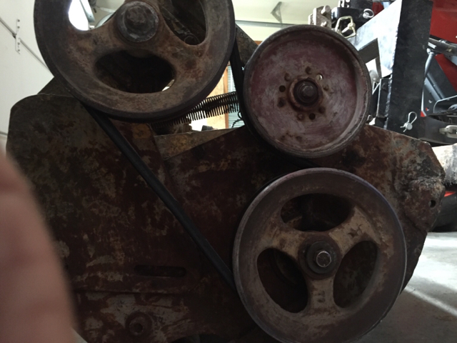

Ok, so I took the belts back off my Caroni and determined the rotor was the part locked up, the top (drive) pulleys turned fine. So I was envisioning the worst, tore up bearing and or race etc! Seemed awful quick to go that bad that fast but...
So I raised it way up and propped it up so I could crawl around under there and have a look. Talk about a fluke, or some sort of cosmic interference, But one set of knives on the very outside of the rotor flipped around and jammed against the outside of the housing and the flange that holds the rotor in and locked everything up!!!!! has anyone ever seen this happen before?
Boy oh boy, you talk about jammed tight!! So I got out a BFH and a couple chisels a couple prybars and I got after it. Try as I might I could not pry it loose! I was able to rotate the rotor around so I could get at it and started to loosen the bolt holding the knives. Well it was jammed so tight after getting the nut off I still couldn't get the bolt to move! Well banging and prying and messing with it finally it just almost magically all fell loose!
So I put the belts back on buttoned everything up and took it for a spin. Everything seems to work fine, it sounds a bit different but I'm just blaming that on those 3 shiney new belts..

Never seen or heard of this before. Don't think loosening the belts would cause it.
I would put a light weight nylon or aluminum washer on the bolt so the knives can't flip up there again. :eek:
Yeah, I don't think the belts had anything to do with this development just coincidence in timing. I've been running this thing for 4 years and never had this happen before, just a freak occurrence I believe, just weird!

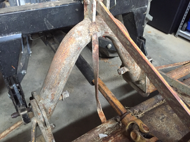

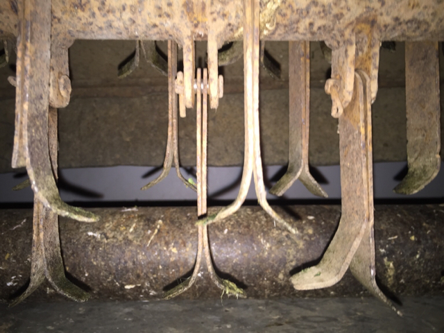

Finally got to see if sharpening the slicers helped the 918H and I am sad to report it made no difference at all. I went though all 96 slicers and turned the best side toward the direction of cut and sharp enough to shave with. If I make two cuts, one going each direction it will cleanup the tire track but what good is a mower you have to cut the same patch of grass twice to get it to look right. Here are a few pics showing what it is doing, grass was cut one week ago, well 8 days because of rain and as can be seen not deep. Iwant to like this type of mower but right now the disappointment factor is nearing the end of the scale.

If the side slicer knives cannot become air foils/airplane wings they will not cut level. A nearby ford New Holland tractor dealer, Clean Cutter or Flail Master will have the model 917 scoop knives if that is what you wish to change them to.
I see in your uploaded images that you have a rooster tail of unmown grass you apparently have a knife pair that is jammed up and unable to swivel.

Can you take a picture of your rotor? That would give us all the info we need to help you.
