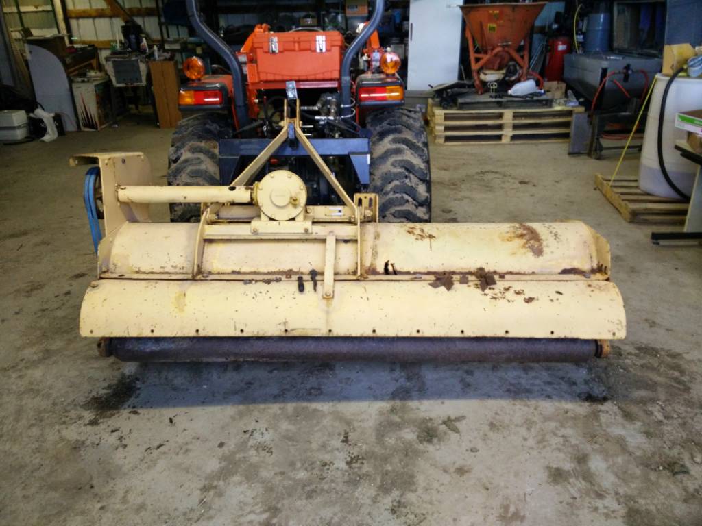

I've got a Ford 917L "Special". It's a 5' mower. I'm curious if anyone knows what makes it a "special". It has 12 stations, and 4 rows of side slice knives. The knives are attached 2ea to the station with a bolt. Maybe because it's offset?
After reading Wrench83's problem I went out to look this thing over. It hasn't been cutting very cleanly and tall (2') weeds, it will leave standing sometimes.
I think the guy I bought it from bought it at an auction and thought it was a tiller. I don't doubt he tried tilling his garden with it.
I violated all Flail Mower Rules and used a 4" flap disc to dress the knives. It didn't make much difference. I will probably order new knives.
I have 3 flails and this is the cleanest and the quietest, and is the worst cut.

Hello D2CAT,
I think "special" refers to the offset position of the flail mower but Neil Messick would know for sure.
Have you flipped the knives previous to this????? If not you may have a good edge on the opposite side.
The knives are a little dinged and I would check to see how much it would cost to buy a new set versus saving these knives with wet well grinder from Micromark. My dad always had a complete spare set of replacement side slicer knives (128) to replace any that were really dinged when he did the annual thatching on the 6 acre lawn that we had.
It took a lot to damage the old Matthews flail mower knives as they had a tapered knife edge and a slotted mounting hole. These knives and the tool less mounting system allowed the side slicers to become airfoils and clip the good sod grass and brush level every time without damaging the knives or when dethatching the lawn. The twin hinged air paddles aided in lifting the thatch and grass up into the collection basket all at once. through the duct that directed the clippings into the collection hopper.
The first time I dethached my lawn in 1990 using the first 36 inch lawn genie I owned with the canvas collection bag which I bought used from the dealer that my dad bought it from and then traded in for the 48 inch model which he gave to me a few years ago I ended up with 36 cubic yards of thatch and grass off a lawn of slightly less than one acre SO my lawn is long over due for dethatching and reseeding.
I need to buy 64 new thatching blades when I can afford it.

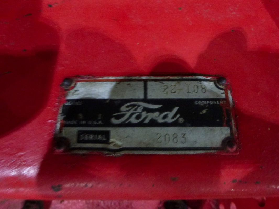

There were a pile of different Ford 917 flails over the years. Different letter designators after the name for the various iterations & they were small evolutions to the design as far as I know, not major redesigns. My 917 has the model 22-184 stamped on the serial number plate. Nothing special & it has plenty of offset. Some of the 917s came in a rough & fine cut trim. Given the 4 bars with lots of holes for mounting stations I assume the only difference was the knives that got put on.IMG_20150525_185656.jpegIMG_20150525_182923.jpeg
/ Let's talk flail mowers #5,274
Serial number plate says: Ford 917L, 22 BU 6601, serial - YJG
/ Let's talk flail mowers #5,275
Oh, and I assume the 84 in the model number has to do with the 7' (84") working width.
