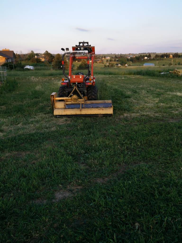

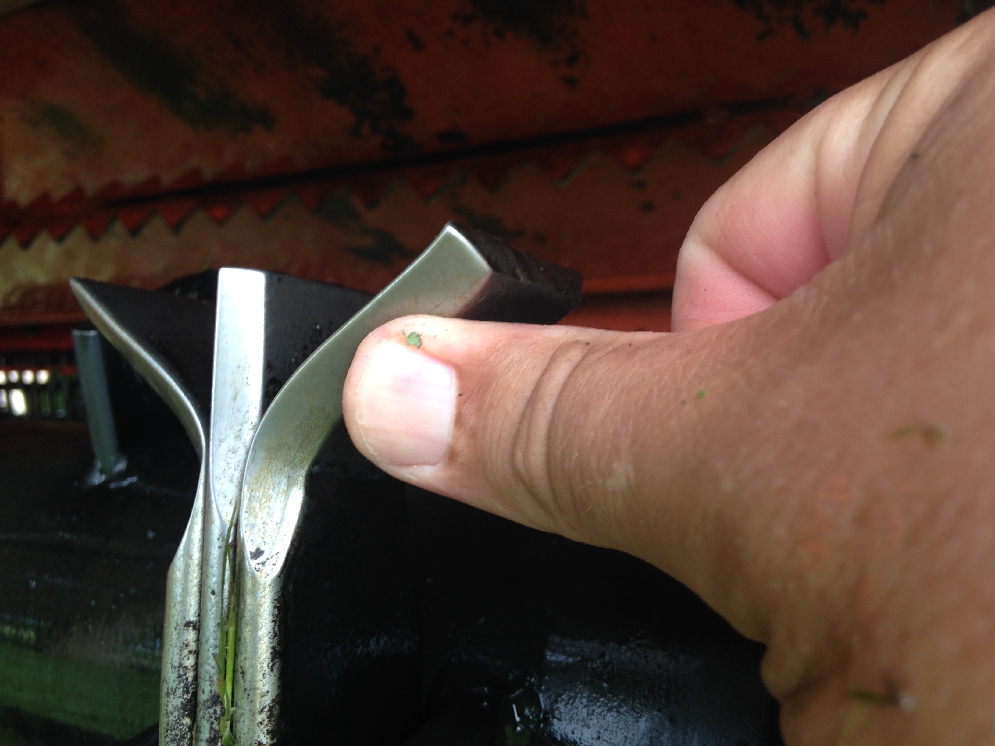

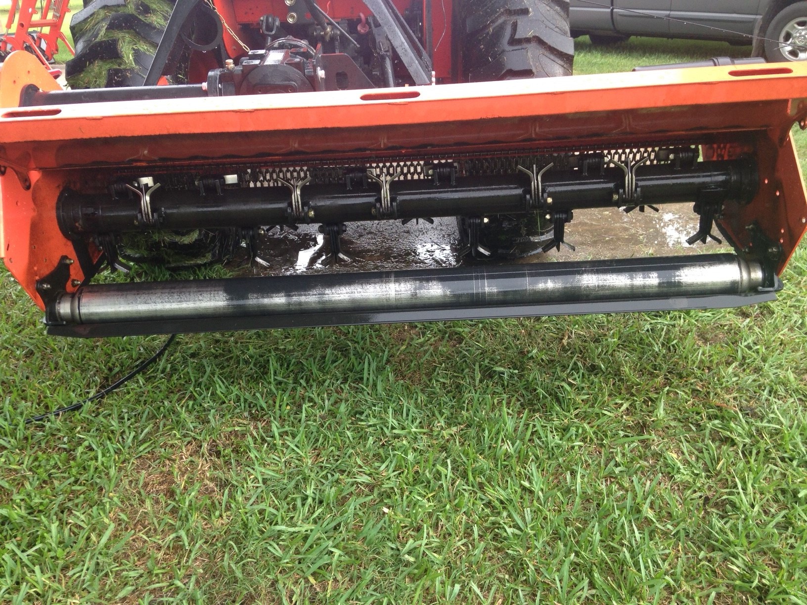

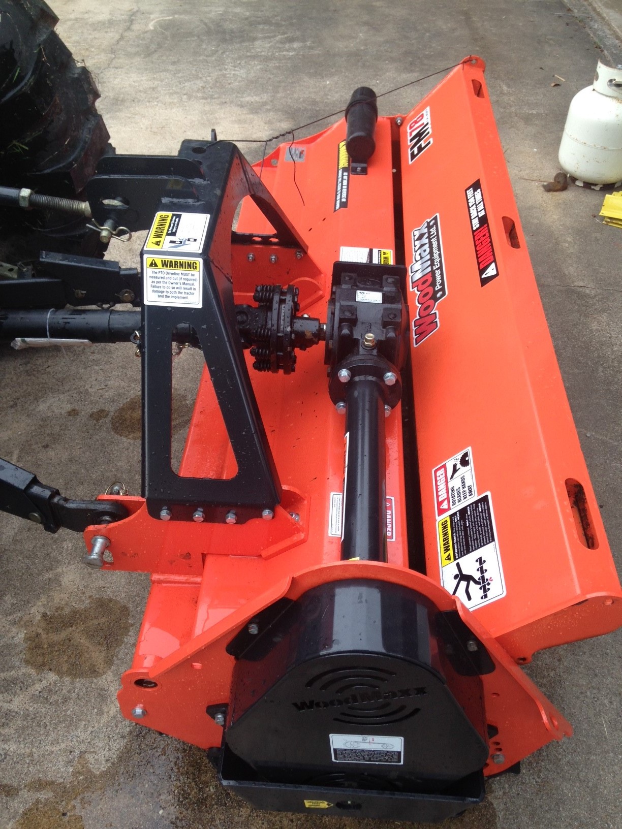

I guess I have about 20 hours on my Woodmax FM78 now. Cleaned it up last night and inspected things before I put it back in the barn. Didn't notice anything out of place or unusual. I'm happy so far. It will leave some tall clumpy weed stragglers sometimes, but most grass it cuts up fine and the clippings decompose quickly which is what I was looking for. The knives are going to last a LONG time just mowing grass, especially since I can flip them around at some point.
PS, the 6ft Modern Manufacturing Super Sunshine brush hog is for sale. Like new. Will deliver in the Houston area.

Excellent photos & description, StuartDK45SE, thanks!
What have you experienced so far with the "solid state" (as described at the Woodmaxx site) belt tensioner? I wonder about the longevity of such a device in a tractor implement subject to the acidic grass residues, shocks, and vibrations that a flail mower experiences. On the other hand, a lot of tractor components are solid state these days...

I took the cover off the belts a while back an everything looked okay with no signs of slippage and the pulleys and belts were remarkably clean. The tensioner feature is one of the reasons I chose this model.

The Woodmaxx belt guard does look better than guards on some other companies' models, and I'm glad to hear that everything underneath looked good!
