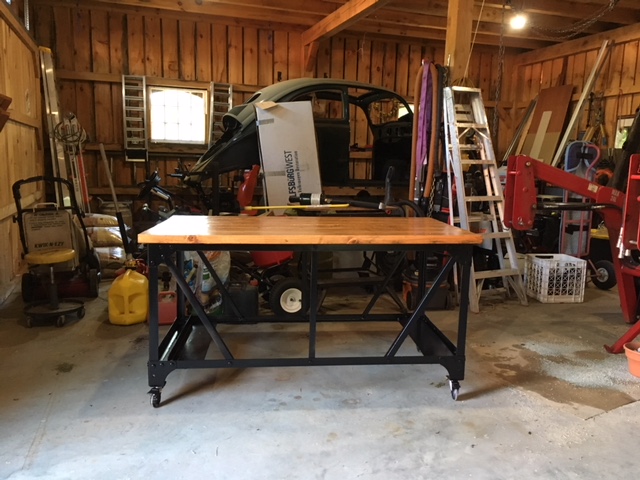

I also used the crate that my Woodmaxx Fail Mower came in. Remover all the upper pieces and added 4 casters to bottom to made a storage dolly for it.
I’m sure your dolly makes hookup to your tractor much easier Ron but, can you move it around your shop if you need to? Would you go with larger casters if doing it again?
/ Let's talk flail mowers #5,252
Bigger casters may help. But they raise frame higher. I had these 4” low profile setting on a shelf. When I need to move over a seam in floor. I use the 3’ pry bar from HF to move dolly.
