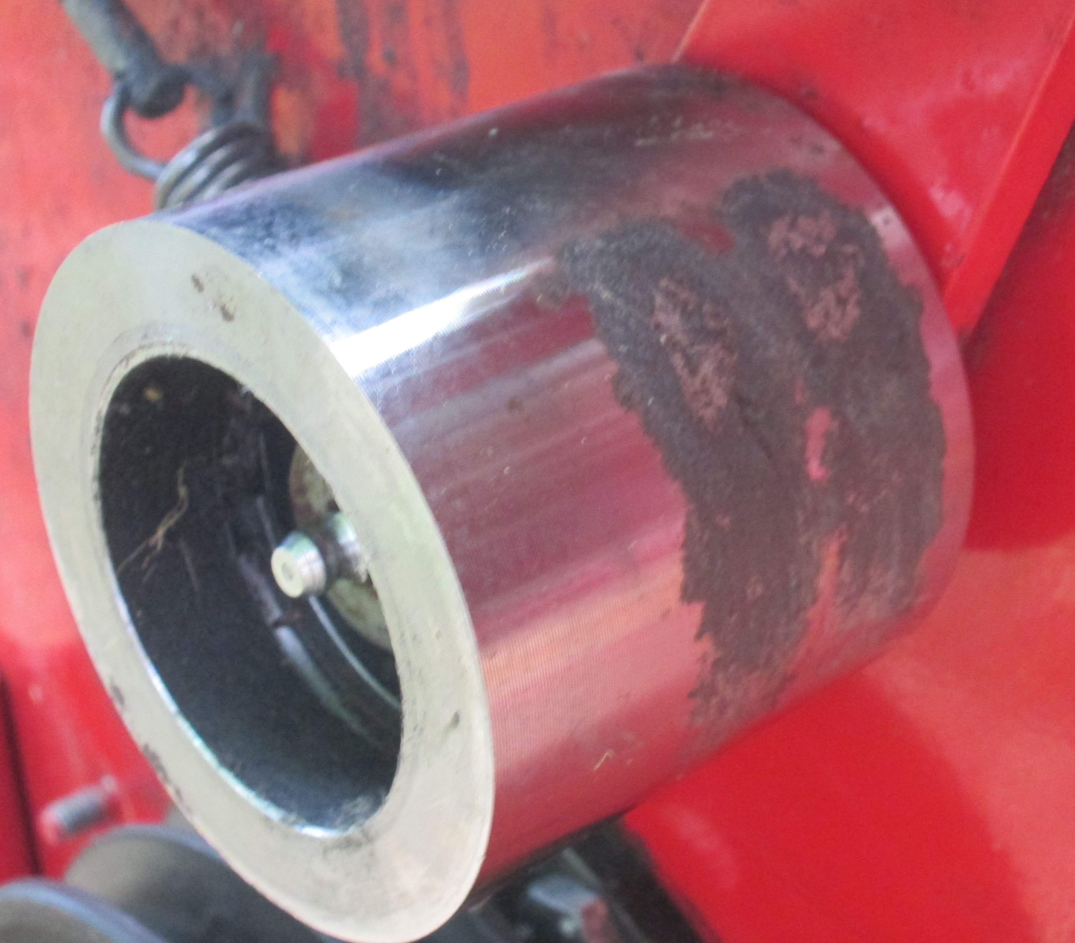

The original belts on my Caroni TL1500 got fried after less than 20 hours. The roller has some black residue on it that I'm trying to clean with acetone, but it's not making much of a difference.
Does anyone have suggestions on how to deal with it?

Hello Jerik,
The snubber pulley did not seize did it?
Use a thick layer of DL hand cleaner to break the bond between the rubber and the metal.
Rub it in the snubber pulley and then wrap the pulley with a couple of blue shop towels if you have them and use a rubber band or two to hold the shop towel against the snubber pulley and leave it for a couple of days and the rubber should peel right off.
I would also do the same thing with the grooved pulley as well to clean it.
Believe me it does work and it works well. I used this method for years to break the bond of old rubber mining tires and steel rims especially if the so called "brains" that mounted them before me used never sieze to coat the rims which only made the rubber swell up and made it that much harder to remove them.
Razor blade or scotch brite probably.
I will use sand paper.
Is it over tightened? You can press the middle of each belt, press 1 cm by 5 KG force, then it is ok.
I don't think so, as it turns easily now. But the fact that I have the residue maybe indicates that it wasn't turning at some point.
