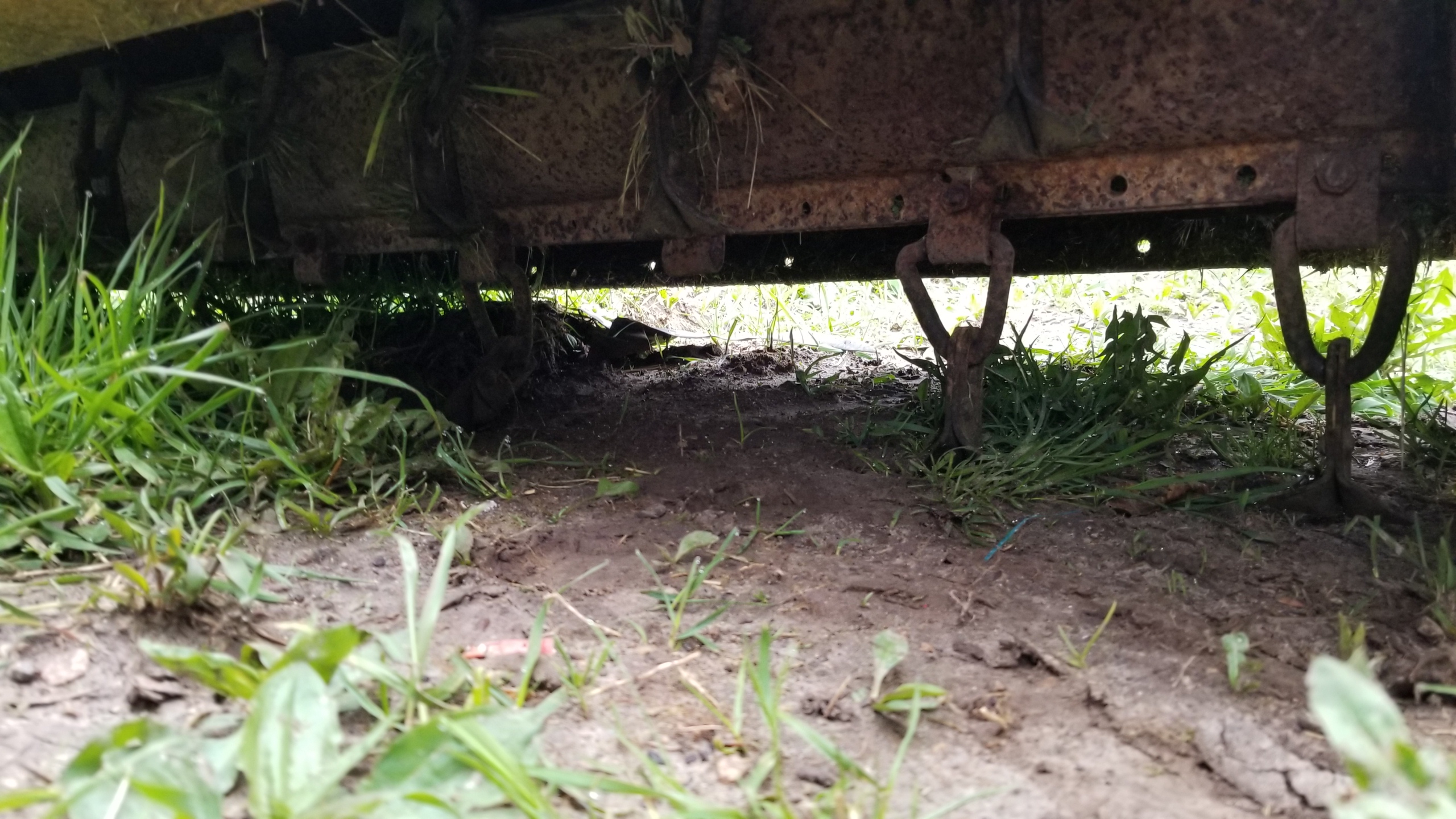

Your knife pattern isn't normal for a 917. For rough cut they use every 3rd hole, finish they use every hole. It appears someone decided to go between rough and finish and use ever other hole. Never hurts having more knives.
Did you have to modify your 917 to use the quick adapter? I bought a quick adapter that I'm going to mount onto a SSQA plate for my skidloader, mostly to move implements around. That would be a great 2nd purpose for the adapter.
That flail was beat to **** decades before I got it. I wont claim most things are right about it. It was missing some knives, as it turns out because they were hitting the hood where it was tweaked. Rear roller adjustment was welded solid. I replaced the knives staying close to what was there. It's worked well. I can't say vibration free, but I blame that on the hood being half cracked in two (not fixing that, it still works) & not a single mounting boss on the rotor being straight. Worked great for a $100 flail, but is now retired as my backup & rocky field I dont give a crap mower.

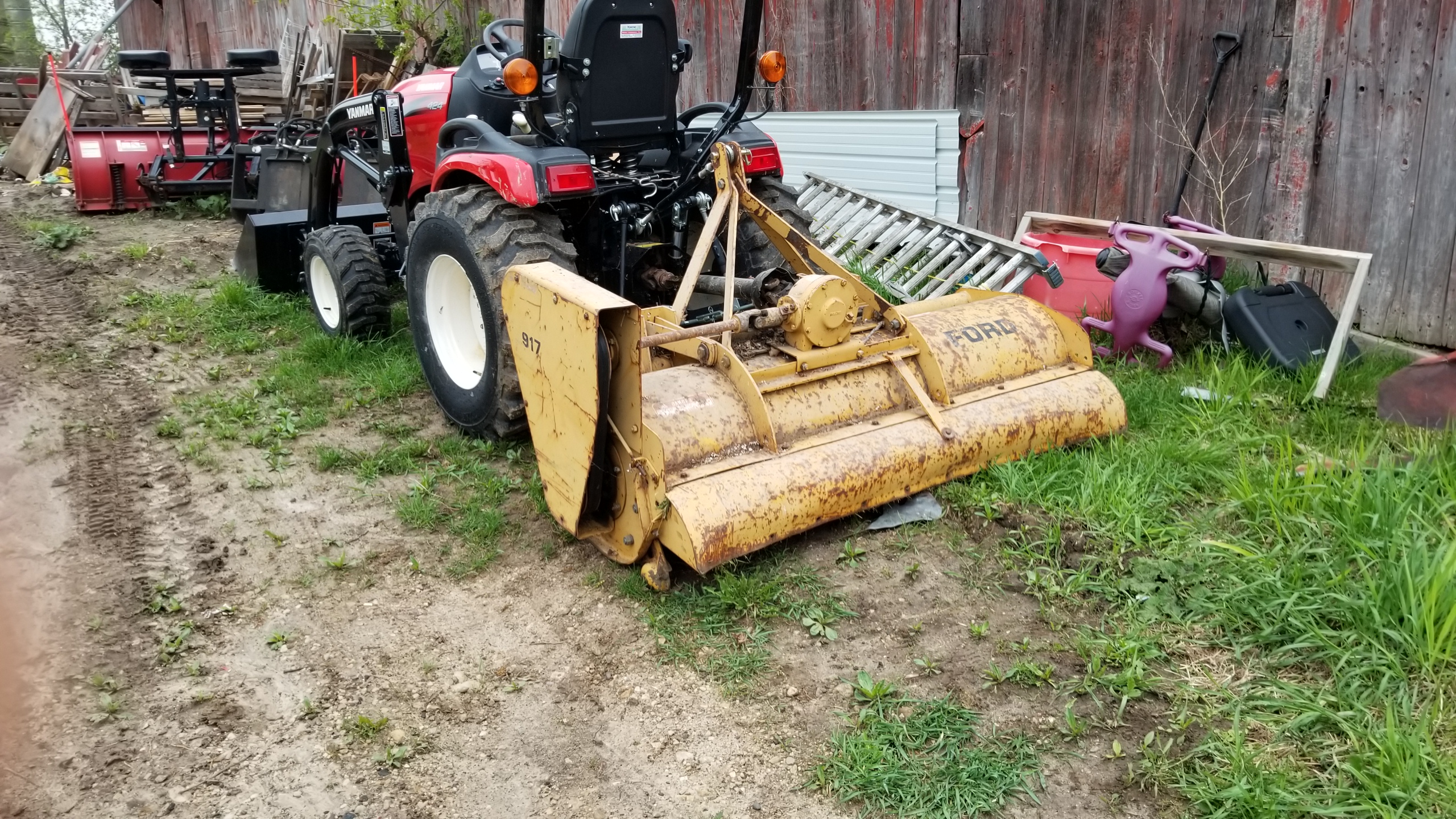

I finally finished reading this massive thread. I might as well throw my hat in the ring. I bought this 5' Ford 917 recently (already posted it in a separate thread, but this thread is more impressive...). I'm still working on getting it fully functional. It was missing the rear roller and one of the roller supports. I'm currently having a local shop make them for me, and I have new bearings to install for the roller. The rotor bearings seem to be in decent shape yet. Just needed to grease them.
A number of blades were missing along with a few broken and the rest are horribly beat up. After reading this thread I've decided to get a set of both the original blades (airplane wings) for when I want a nice finish and a set of side slicers for knocking down some CRP land that is coming out of contract this fall after 20 years. I will only be grass (as far as I know...), any brush I'll take my brush saw along to cut down to ground level before mowing. I don't think I'll mow the whole 30 acres, just a nice path around the outside and burn the rest off :cool2: . I will also mow some trails. Once I have all the heavy stuff knocked down I'll switch over to the smooth cut blades to maintain it. Both hang on the same hangers and D-rings so no problems there. I'm also ordering a new belt (double V) to keep on hand.
I have played with it a little bit and it does cut decent on my little 24HP (18PTO) tractor. I can't lift it real high, but high enough to get it off the ground. It's HST so I can go slow in the heavy stuff. Overall the thing is in decent shape for being so old.
