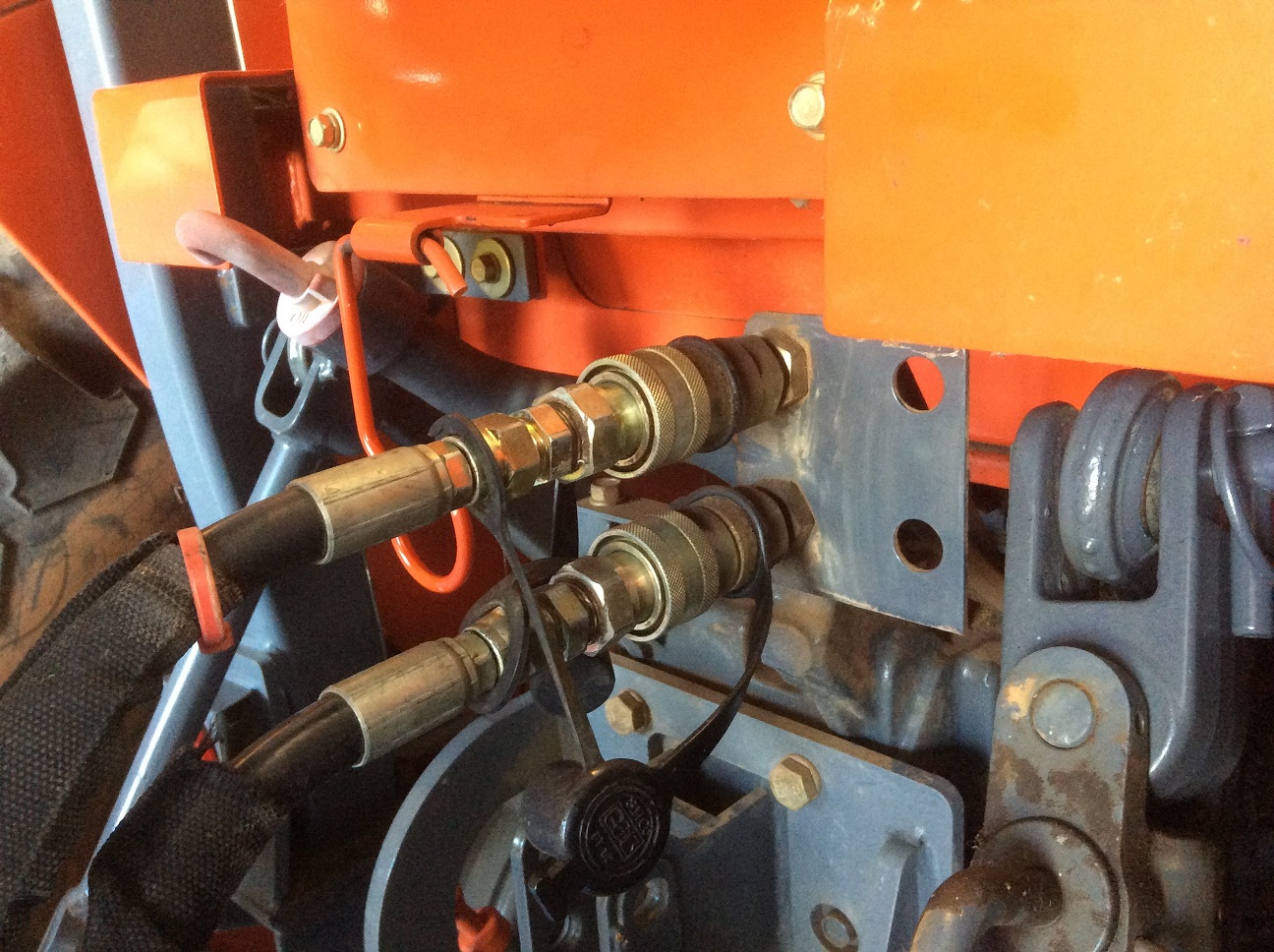

If you detach or unplug your loader (bucket only maybe) and use longer hoses, you could have rear hydraulics
That is my pl
