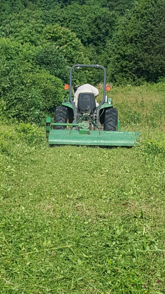

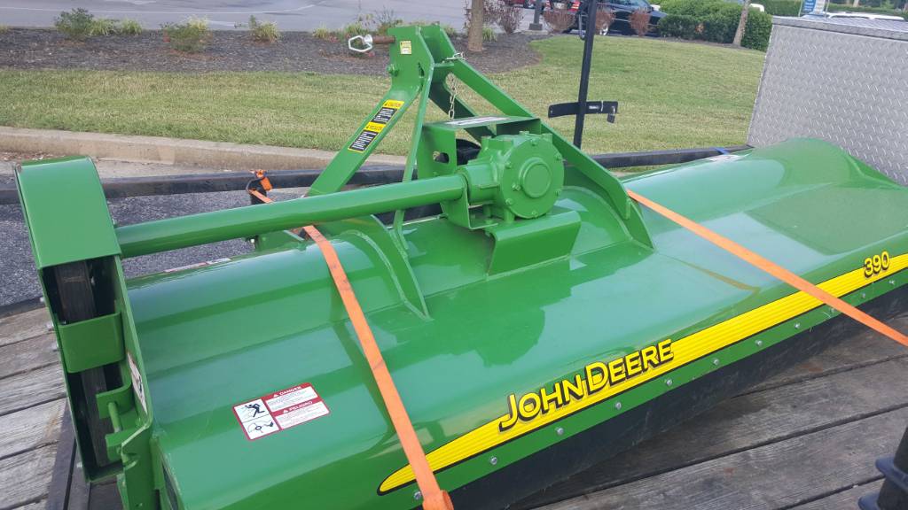

I have both a JD25A (with side slicers), and a JD390. Sold the BH 3210 once i mowed the field a couple times with the 390. Will keep the 5' rotary for backing into the tree line with the 4300HST, but all pasture, paddock, and field cutting will be done with the flails. I love the way they mulch the cuttings and lack of windrows and clumps as i attempt to reclaim neglected hillside pastures. Attached is a pic of my first pass with the 25A behind the JD 4300HST this past spring. The stalks left behind look rough, but keep in mind the first cut was 6-7' tall brambles and assorted brush. The second pic is the 2nd cutting a month later . After seeing this I decided to get the 8' wide JD390 for my 70hp AGCO Allis 5670. The 390 takes care of the brush up to 3" softwood trees. But i prefer not to use it to back into trees to protect the rear sheet metal. As we get the vineyard set up, I'm considering a 54"-60" flail and 17-21 hp tractor for maintenance. 20180603_193443.jpeg20180603_085800.jpeg1529191270386.jpeg

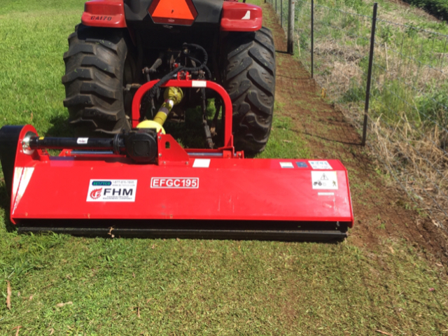

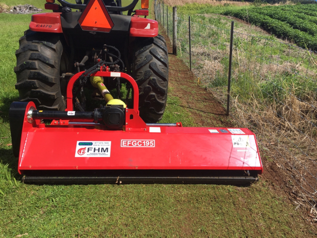

Mateng mower, forgot to grab a pic of it behind the tractor for regular mowing.
/ Let's talk flail mowers #5,384
The dealer is about 500 miles from me, OTS Auto Electric, Nisku Alberta, Canada. Shipping was cheap, $140.00

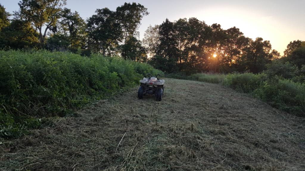

A couple of picks of the paths cut through the "forest" as my grandkids call it. A small very overgrown and neglected orchard. Like the results from the flail mower better than the bush hog in this application. Mulching action of the flail leaves fairly fine residue, the hog left lots of branches. Will have to see if the flail will clean them up.
/ Let's talk flail mowers #5,400
Hello metalbender,
Glad to see that you are happy with the first mowing in the "forest"
As long as you keep the mower at two inches in cutting height you will recut much more material.
Please forgive me as I do not remember this, but do you have the side slicers or scoop knives with your mower?
If you have the scoop knives they will not recut the material left on the ground.
The mowing job looks great though. will you be going through and mowing at right angles to reclaim the orchard rows?
