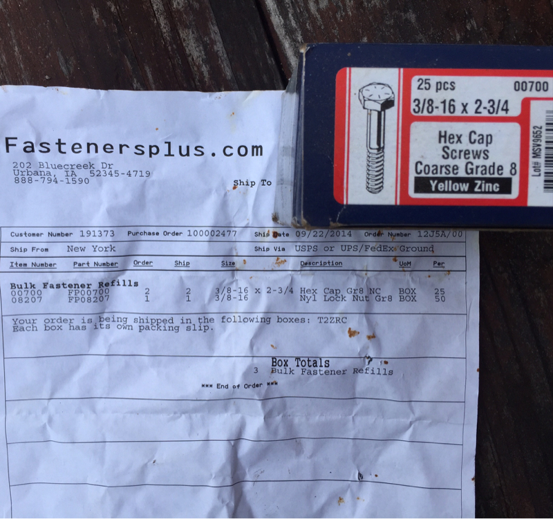

Looked up the bolts I use for attaching modified Flailmaster clevis to Caroni rotor: 3/8-16 coarse thread 2.75 inches long. Grade 8. Use matching nylock nuts. Advantage of the 2.75" bolts is that there is virtually no threaded area exposed to high speed debris once the nuts are in place. That makes them MUCH easier to remove than the factory supplied bolts. I didn't buy the bolts and nuts from Flailmaster. Invoice in photo below shows one internet source but even A box store should have them.
