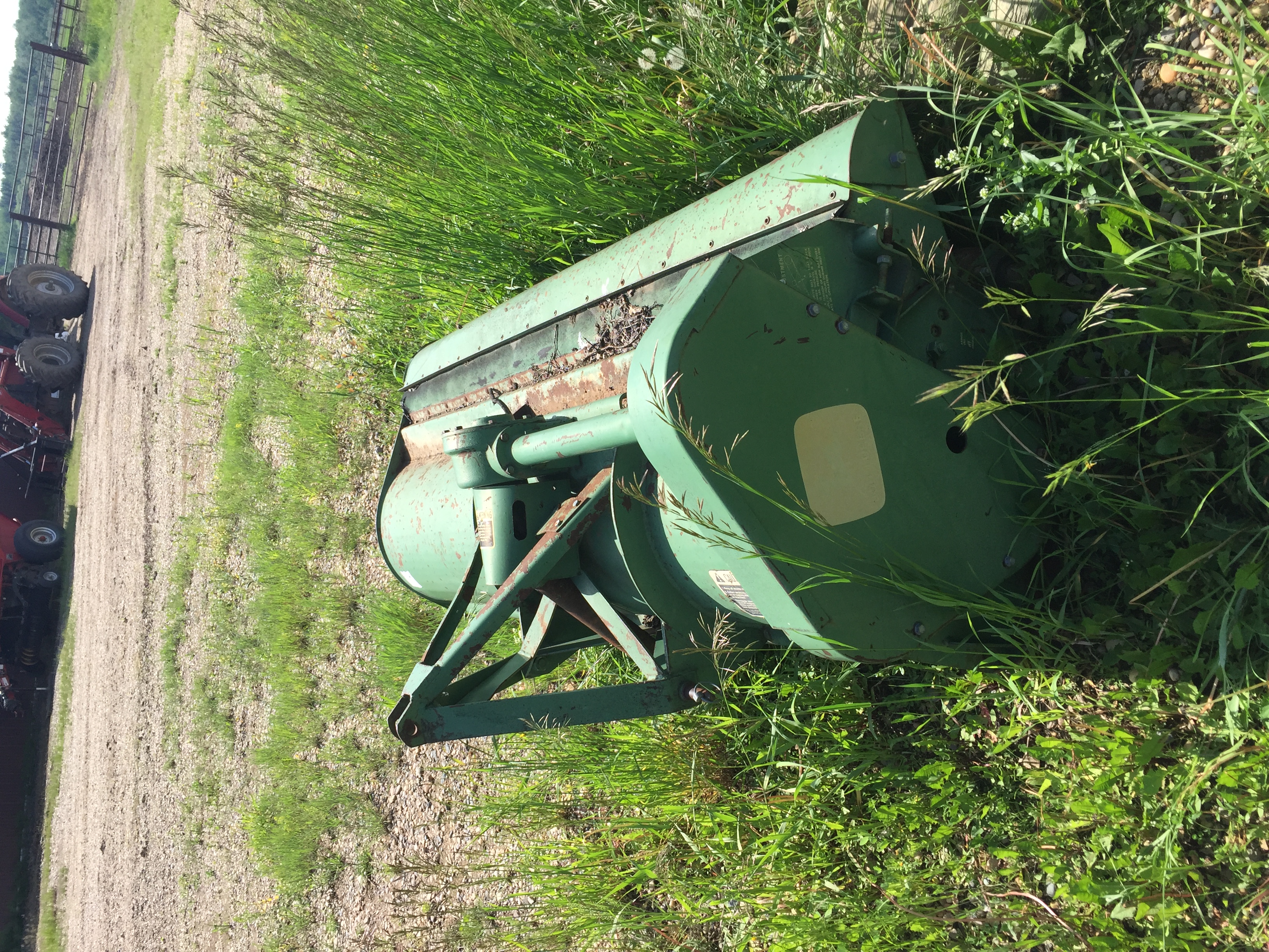

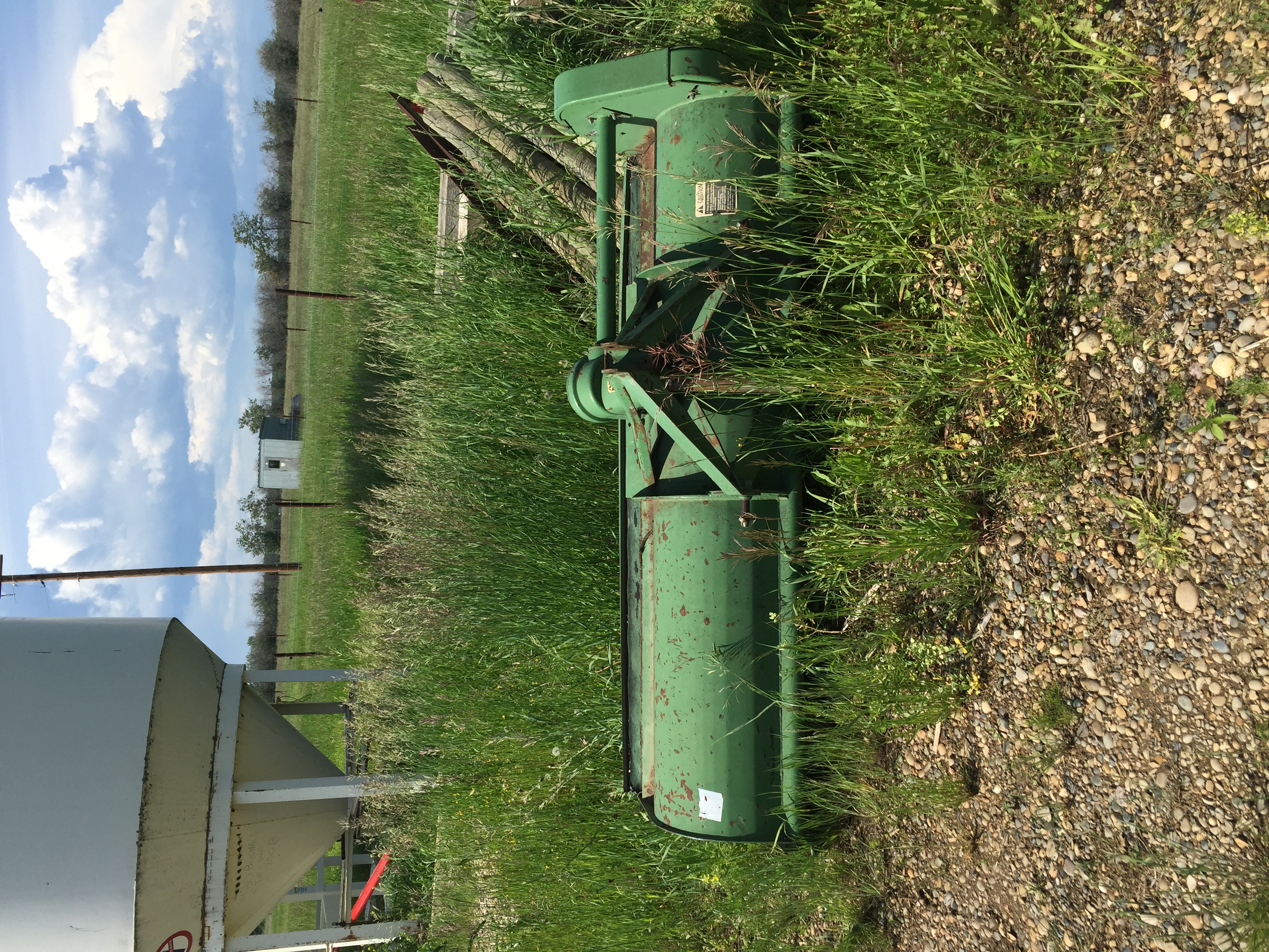

image.jpegimage.jpegimage.jpegAfter talking to a Land Pride dealer in Alberta and finding out how many Canadian Pesos they want, that option is out. However this same dealer mentioned a local farmer that bought a new John Deere flail some years back and never used it. He took some pics when he delivered a new tractor last year. He didn't know the model, I haven't spoken to the farmer. Anyway he is looking for 5200 Canadian Pesos, that works out to about 3900 US. Opinions?

That JD looks like a medium duty flail similar to the Italian imports. Good quality but doesn't justify premium price. Caroni TM1900 available new for $2000 from AgriSupply. Similar units available from other manufacturers for roughly same price.

Way too much, it may have never been used but it's still used and looks like it sat outside for a while anyway. JD flails have a light gauge deck compared to some other brands.

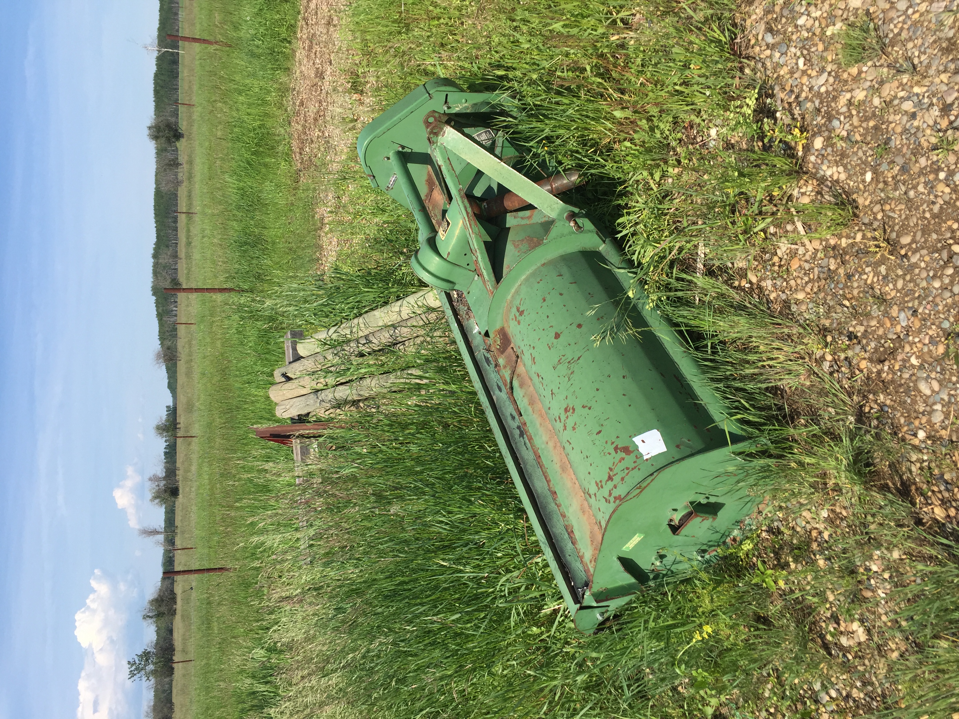

View attachment 475105View attachment 475106View attachment 475107After talking to a Land Pride dealer in Alberta and finding out how many Canadian Pesos they want, that option is out. However this same dealer mentioned a local farmer that bought a new John Deere flail some years back and never used it. He took some pics when he delivered a new tractor last year. He didn't know the model, I haven't spoken to the farmer. Anyway he is looking for 5200 Canadian Pesos, that works out to about 3900 US. Opinions?
That John Deere flail Mower is either JD 290 or 390 model, it looks like the wider JD390(8 foot width of cut) burn rubber and run over there to buy it, don't walk!
SO with the Canadian dollar being 76 cents for every US dollar your looking at $2,964.00 Canadian. I would raise a stink about theft at that price if you bought it before I got there!!!!!!!!!!!!!!!!!!!!!!!!!!!!!!!!!!!!!!!!!!!!!!!!!!!!!!!!!!!!!!!!!!!!!!!!!!
I would run over there and pick it up before someone else does as the 390 down here is almost $10KUSD
At most your going to need a new parts and owners manual new Kevlar belts, an oil change with new 90 weight oil and a new PTO shaft.
Parts are available and at the value of the loony your better off buying what ever you need from a JD dealer in your neighborhood.
BUT in saying that, A V belts are metric and all bearings are metric and easily obtainable locally. As far as side slicers, scoop knives and knive hangers buying them from a JD dealer may offer you the better price per knife if you need them.
Bring it home, remove the V belt guard, steam clean it inside and out, check the knives and knife hangers buy some JD paint, Kevlar belts, add new oil, and sand it and paint it over the winter or sooner and you will have a $10KUSD flail mower come summer.
You may just need a new PTO shaft, New V belts and an oil change, Just be sure to remove the V belt guard and grease the fittings under the V belt guard that may be buried in rubber and grass dust.
Run, Don't walk there with your checkbook!!!!!!!!!!!!!!!!!!!!!!!!!!!!!!!!!!!!!!!!!!!!!

Leonz, I'm surprised you think that mower is worth that much. Cosmetics are nothing but the overall construction doesn't appear much different than a medium duty Caroni. I can believe JD retail is $10K because they use special green paint made by soaking the dye from $100 bills. But, how is that mower functionally different from an Italian version?

It is not functionally different at all, I just remember my dads JD290 being a great, solid, heavy flail mower and its there to be purchased today unless someone else purchases it before he gets there.....
My thoughts are simply that the mower is there and he could take it home tomorrow, pick up a new PTO shaft, gear oil, new V belts and JD paint at Farm and Fleet or Canadian Farm Supply, New knives and hangers if it needs them and have it almost ready to run by Friday without painting.
It is a steal at that price even with a new PTO shaft(which it needs anyway) and it will do everything he wants to do with it and also mow good sod using the same mower.
A days work to inspect it and get it ready with new replacement parts and he has a flail mower that will outlast his current mule and he can upgrade to a bigger frame size/HP without needing a larger replacement mower to match the HP frame size.
He can always sell it and get most if not all his investment back as it is very safe mower to operate in all conditions as we both know.
My thoughts anyway

I have a 390 JD flail, I paid around 6K Canadian for it new. Be careful with the JD dealership. it will cost you about a grand for a change over of cutters and d rings / hangers and bolts.. JD charges like half screwed buffalo's for their product..( I thought the green paint was expensive..try the Unpainted stuff!! LOL)utters in their catalog are like a buck and a half each their smooth cutters P/N 31900 are 2.58 each. Granted it is in US dollars and a full set will be substantial weight for shipping but I think a person is still money ahead going through Flail Master.. I am going to pull the trigger on a set for mine. I'll keep you posted..

This mower has seen quite a bit of use. Many of the little paint chips are from rocks being mowed and spun up against the inside of the housing creating little dings. It might still be in very acceptable condition, but it is a long way from new. Value is in the $2500-$3000 USD range in my opinion if the knives are decent and it spins true without vibration. Having said that, I'd take this over a new Caroni if the prices were somewhat close. Heavier gearbox, quieter to operate and so on.

The guy is asking 5200 Canadian. The dealer I spoke to said he looked under it when there last year and as far as he could tell it appeared unused. It has been sitting in the farmers yard, uncovered for several years. Occording to the dealer, I haven't spoken to the current owner, the guy bought it to replace another he had at one time.

If those are the actual photos of the farmers JD flail, it has had plenty of use. The little dents from the inside out do not happen unless the mower is being used. The knives and rotor and bearings and all might be in great shape. But "unused" is not an accurate description, especially from a dealer that ought to know.

Not sure about the paint dings. If it's anything like my Mott it takes a lot to ding that housing. However the 3pt pin areas look worn as do the skids and has the diagonal down brace been bent and straightened? Don't think it's unused. Go have a look and deal direct w the farmer, maybe you'll learn something you haven't yet. Jim

Agree, that picture says used all over it. "unused" would be fitting for Craigslist ad though... you can stretch things on there.. LOL

JD's are not as a heavy of housing as a Mott and will dent much easier. If was in fact never used (very doubtful) it should have been kept in a shed not outside in the elements. $5200 Canadian is way too much. If it was kept inside and still looked new would raise the price but it wasn't kept inside and does not look new. It's definitely not a 390 looking at the trash deflector. If you can buy new with a warranty for less money would be a better option. Looking closer it does appear to have dents and a fair amount of rust. The cutter shaft and underside could be very rusty too.
