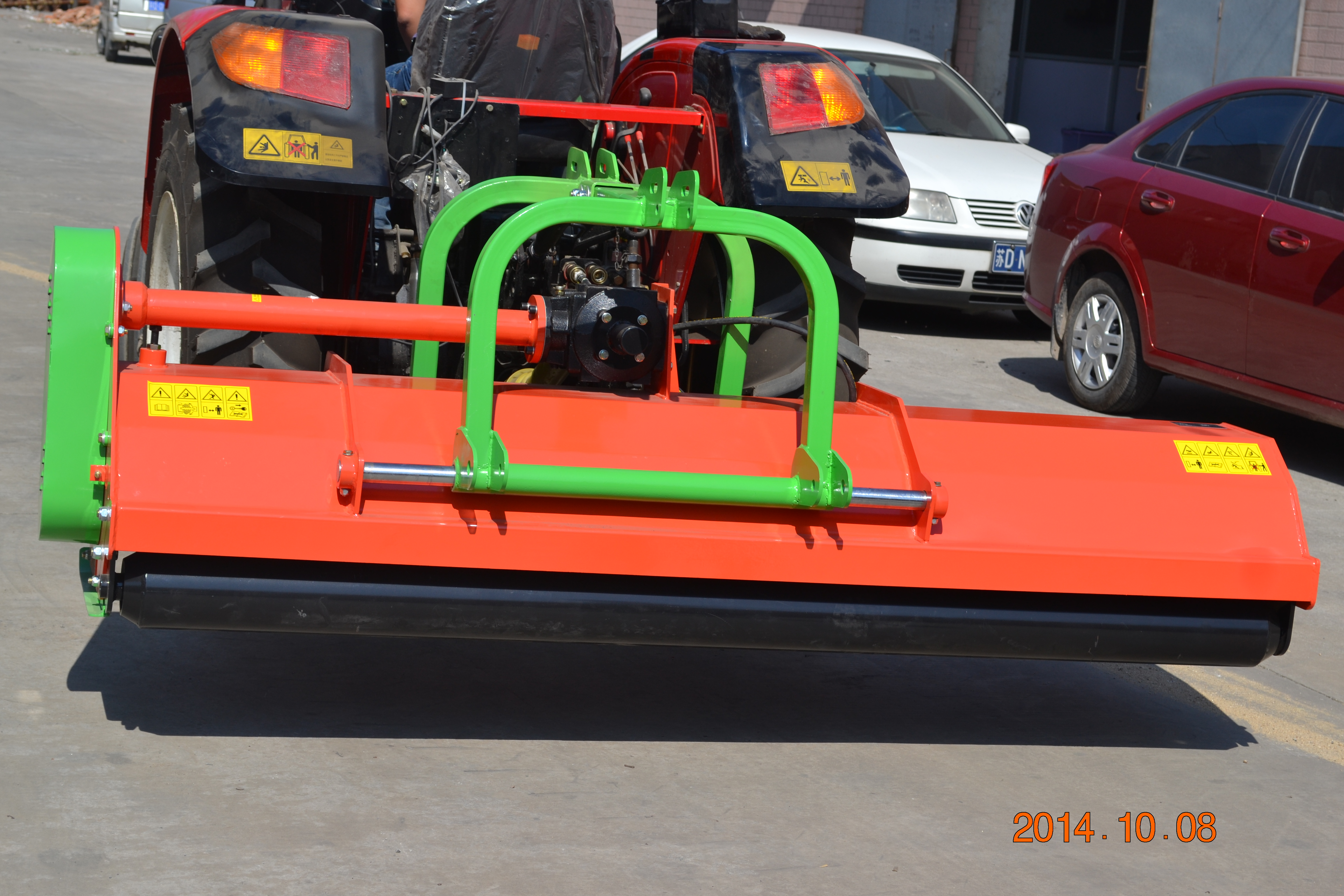

Hi, Here are some more information about this flail mower, we called it as AG or BCS mower here in China.
This model used to be the biggest flail mower which we produced, its rotor pipe is 5" and 0.32" thickness, its roller pipe is 6" and 0.32 thickness. It used to be with 2.7 lbs casting steel hammer, or 1.76 lbs forging steel hammer. And 0.25" thickness body panel, 0.32" thickness side body panel.
It is heavy duty and can be used on Cat 2 or 1 tractor, you need to check your tractor weight and horse power to choose correct one.

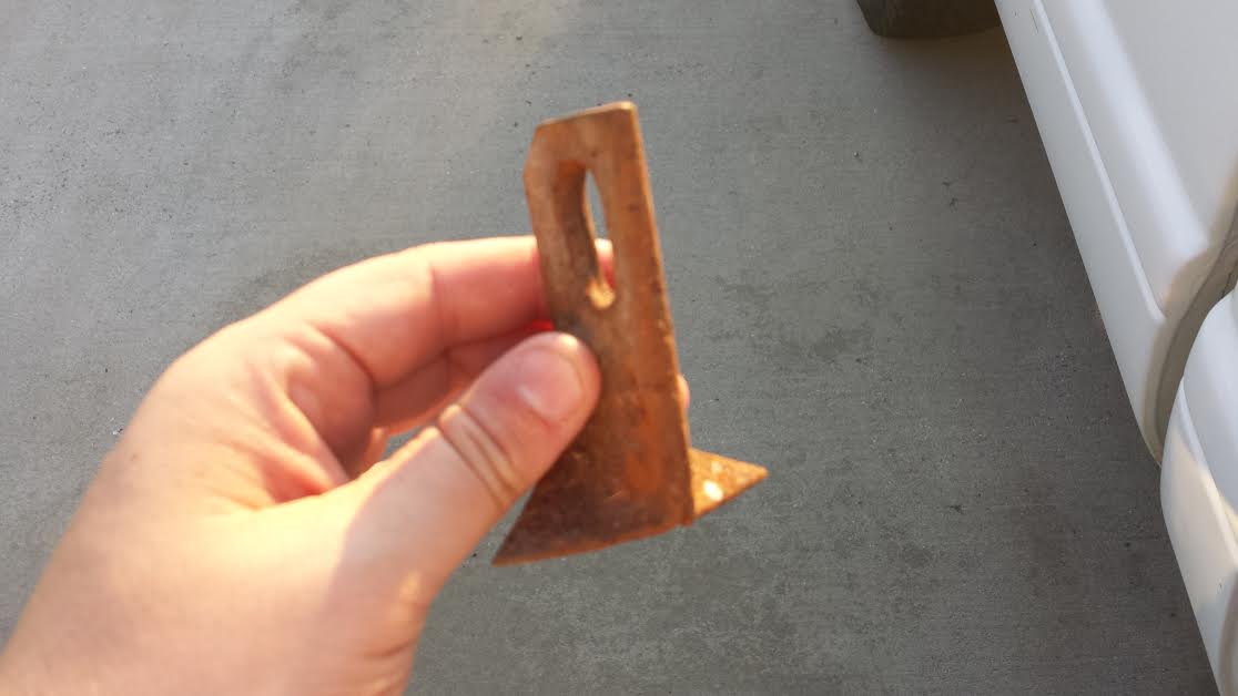

Thanks Jack. I weight one of the bare hammers without the bolt and it is 36 ounces or 2.25 lbs. I don't know what the bolt and nut add to that.

Thanks Jack. I weight one of the bare hammers without the bolt and it is 40 ounces or 2.25 lbs. I don't know what the bolt and nut add to that.

I had this hammer, its standard weight is 1200gr/2.7lbs according to its design, but because of Chinese poor casting technology, the casting hammer is with too big weight difference. You can check more hammers on your mower, they looks same, but with quite different weight. Then this will need more weight balance on rotor shaft. So now we almost give up casting hammer. Only choose forging steel hammer. by the way, I m still thinking about higher standard forging steel hammer to control the hammer weight difference. Often check with your mower's rotor shaft, especially the weight balance block, I already had some report from my customers that their balance weight block lost after several years working.
