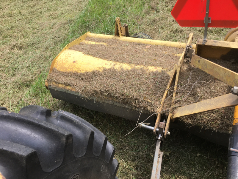

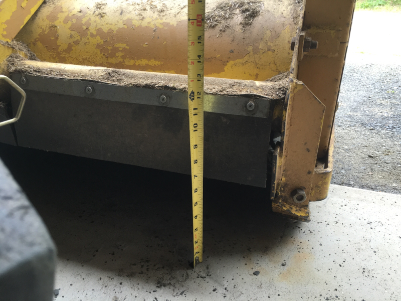

Speaking of suction, do you flail owners regularly see loads of clippings on the mower and debris in the air when mowing? My Mott SHD88 came with no shields, so I made some. The debris is awful when mowing over some month-old cuttings like I did today. But messy any time. Here's the front of the mower when I got done about an hour today: View attachment 475567 And here's the shield I made a few years ago: View attachment 475568
The mower is on the ground in the pic. The rear shield is similar and clears the ground by about 4", closer than the front. The mower cuts very well (fine cut w side slicer pairs) but the airborne grass clippings are a pain on an open tractor. What do you guys experience? Jim
My Mott 72 w/ side slicers has the same debris on top after mowing. I have a rubber shield on the back similar to the one you show but none in front.
As you can see in my avatar my tractor is as open as it gets and it gets some of the same debris on the back by the PTO. Actually, I never thought twice about it.

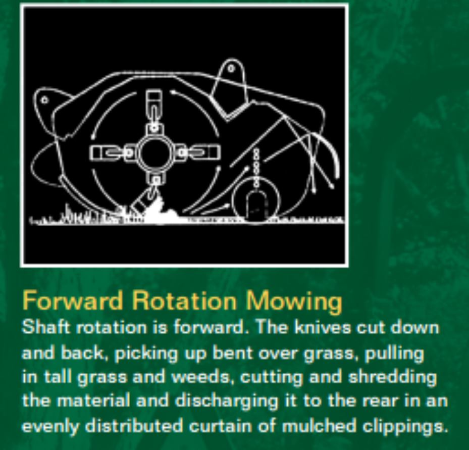

Copied from an Alamo brochure, the shaft is rotating same as tires:

Who died and left them in charge? :) That doesn't make any sense. The cutting edge of the blades in that graphic is moving to the rear and up. As I mentioned, my flail cuts better going the other way and it still discharges out of the rear and down. Along with any rocks or wood chips. Mine has a flexible skirt on the front. The only time I get chaff blowing around is if I'm cutting with a stiff wind at my back. And if you look at the front of the cutter, you can see the grass blades being pulled into the cutter so it's not bending them over. In any case, I prefer the rotation and cut I'm getting no matter what anybody says. I'll stick with it. :tractor:

Oh I see what they have to do with those "backward" cutting mowers. :) They have to add that Quasimodo hump on the back to deflect the debris down. Wasted metal and energy.
