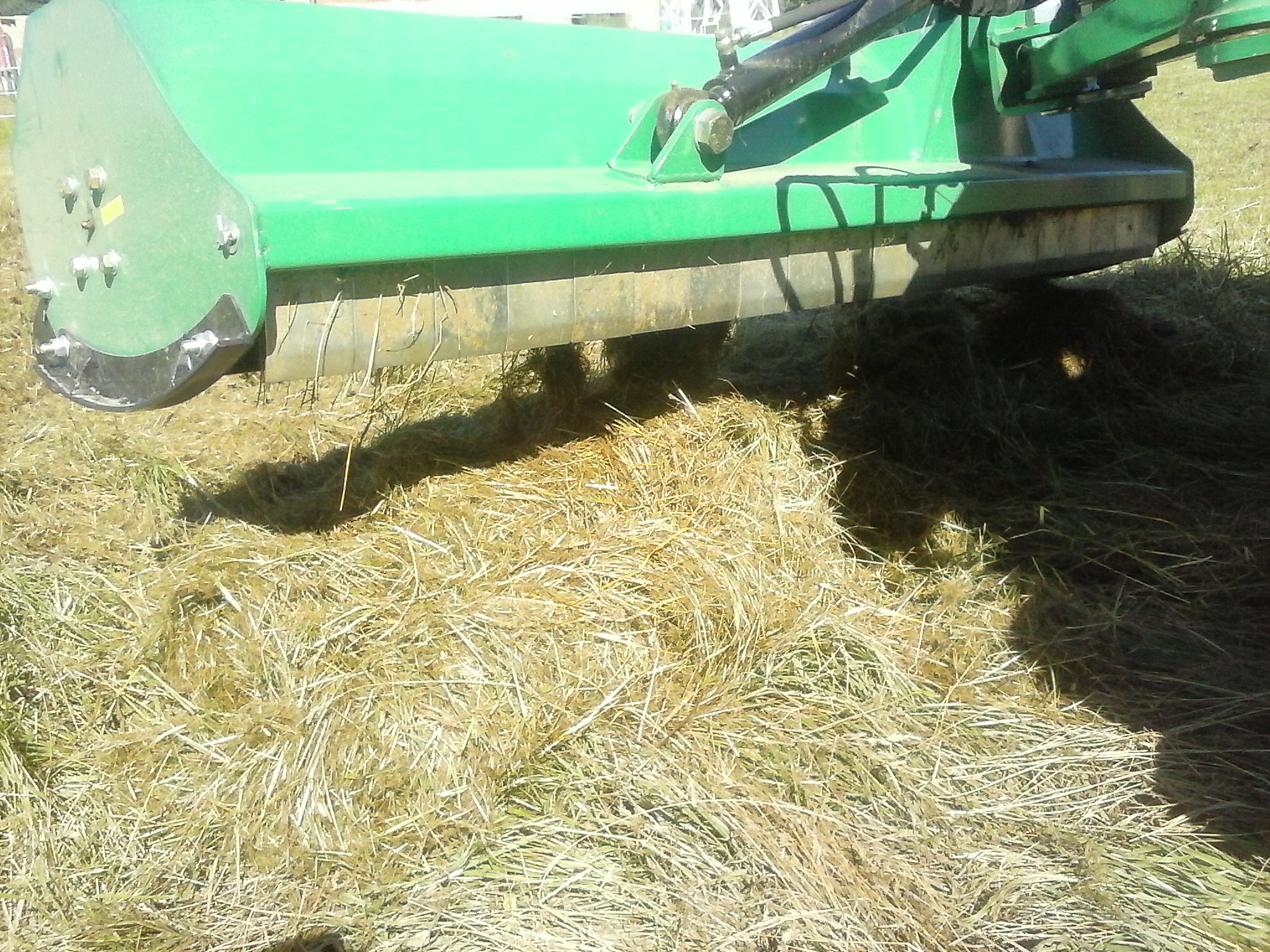

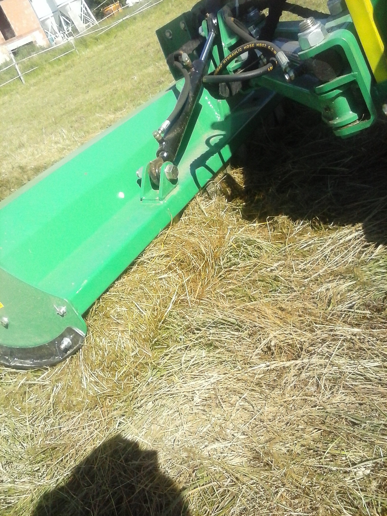

Hi Leonz, I have a customer complain the flail mower throw the grass from front, after I watch his photos and video, I guess this is because the grass is wet and fall down on ground, but what can we do when flail mower cut such "grass"? Or this is not the "grass" which flail mower cannot cut?

Hello Mr. Yuan,
I do not have the ambition to yell in Mandarin; but once again this "flail mower owner" is not using the flail mower properly.
It is much too low to cut properly and as result it is scooping and shearing
the matted grass up like a sharp scythe with the scoop knives on your flail mower.
He certainly decided to mow without adjusting the rear roller(Lower the rear roller)
to raise the mowers cutting height-you can adjust the rear roller on your flail mowers
to adjust the cutting height I hope?
He has to lower the rear roller to raise the cutting height Mr. Yuan.
