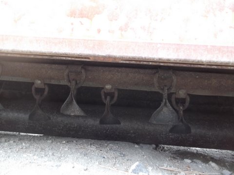

Those blades work well on light brush but for cutting grass, they should be sharp. The edge I see is rounded and dull. Your blades are just ripping the grass instead of cutting so the grass builds up on the fronts. They should be "lawnmower blade" sharp. My flail uses the flat edge spoons and it cuts like a finish mower and takes down tough brush. The only place I get a little grass accumulation is in the chain link above the blade.
/ Let's talk flail mowers #3,062
Those blades are brand new and that's the way they came. I was surprised that they were not sharp.

It looks to me that the knives do not open up while rotating. I can easily spread them with my hand though.
Hello OzarksLandowner,
AH yes it is the dreaded mounting hole
issue rearing its ugly head again.
A Side Slicer Knife with a slotted mounting hole one half an inch long by one quarter inch wide allows
the knife to become an air foil and lift to the horizontal to allow the knife to slice the grass and
brush cleanly with no dirt digging.
The issue for Clean Cutter, Flail Master and the other manufacturers of these knives
is that they have to create the knives exactly to the specifications of the original knives.
AS I have mentioned previously the flail mower rotors are smaller in diameter and the
knives are longer in length and mounting stations are either D rings or weldment's on
the steel tube used for the typical Flail Mower Rotor except in the JD models where
they have the second weldment welded to the steel tube which is a machined and
modified block of tubular or solid steel to allow mounting the D ring straps.
Hopefully when flail mowers become the dominant way to mow all types of grass and
brush for the homeowner and mowing contractors they will start making Flail Mower
Rotors with a larger diameter welded pulley that will allow smaller knives to be mounted
on the rotor with a tool less knife hanging system that is spring mounted and slotted
knives can be used to thier advantage to create smaller clipping and recut the clippings
much faster.

Are you saying that the knives that do not have the slotted holes will not open up when rotating?

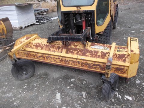

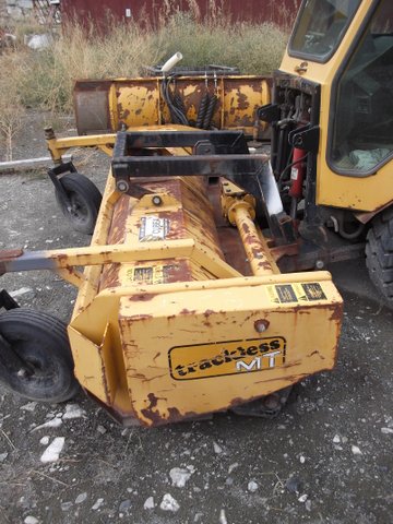

I've been looking for a used flail, and came across this. It's a front mount. Can it be modified to sit on the 3 point. Rotation? I haven't seen this in person yet image.jpegimage.jpegimage.jpeg
/ Let's talk flail mowers #3,071
I've been looking for a used flail, and came across this. It's a front mount. Can it be modified to sit on the 3 point. Rotation? I haven't seen this in person yet View attachment 471784View attachment 471785View attachment 471786
A 3PT hitch could be salvaged from another implement and welded on without much trouble. However, the gearbox is mounted very low and I'd be concerned that it cannot be easily adapted for a rear PTO.
The real question is why don't you just get the whole rig? I've always wanted a front mount flail!
Yes, As long as the new beast is working for now I would not worry too much for now though.
Do not go anywhere near it, it was a municipal machine and it already had one gauge wheel arm broken as evident from the paint on the right wheel set.
The other thing is the gearbox as its being driven by the automatic transmission and this trackless vehicle is 160HP+-.
Go to Tractor House and Auction Time to buy if you want used.

I've been looking for a used flail, and came across this. It's a front mount. Can it be modified to sit on the 3 point. Rotation? I haven't seen this in person yet <img src="http://www.tractorbynet.com/forums/attachment.php?attachmentid=471784"/><img src="http://www.tractorbynet.com/forums/attachment.php?attachmentid=471785"/><img src="http://www.tractorbynet.com/forums/attachment.php?attachmentid=471786"/>
I wouldn't hesitate to purchase municipal as long as I knew which one.
I think making the three point hook up would be the easy part. As stated, being the gearbox is low that could be the tricky part.
Now my main concern is, is that a 540 gearbox?
Since the three point has to go on the front, would you leave the wheels on?
Might be able to use a chain drive from the PTO shaft down to the gear box, depending on the direction of rotation desired.
The input now to the gear box is probably around 2000 RPM.

It's a 540 gearbox. I decided not to pursue a deal. To far away and to much tinkering for me.
