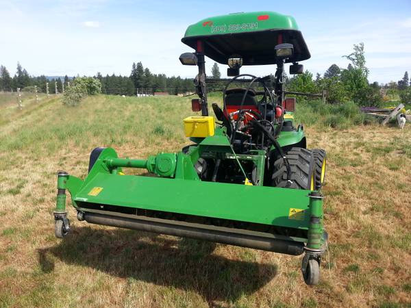

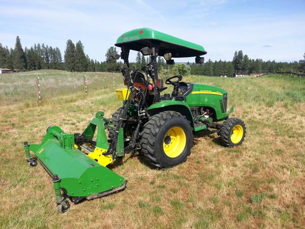

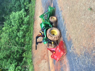

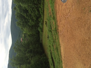

Thanks Leonz,
This has been a great resource for decision-making (head-scratching). For many of us, small property folks, we're not in the position to buy, try it out, and then move on if we don't like it. We're going to live with it. I live in an area where you don't see flails and salespersons don't know anything about them so it was hard to see one first hand. This forum provided a lot of discussion that helped me work to a solution that provides the best balance for me (some brush clearing but decent looking). Thanks.
BTW, don't know why the photos came out sideways, I know I took them standing straight up. :)

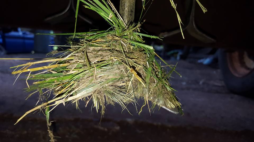

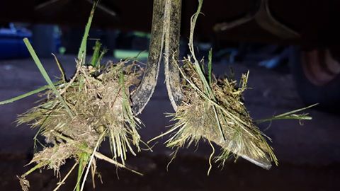

What would be the cause of grass building up on these knives? I really can't tell how much it affecting the cut but I'm sure it has to be.

Go very slow and have the rpm max just did 10 acres & had the grass like that within 5 mins. because I started out going to fast.
/ Let's talk flail mowers #3,057
Are you stopping the PTO before you lift the mower?
It's a pull behind that I have hooked up to my three point lift to control height. I haven't done much mowing with it but what I have done is pull out onto short grass and shut down the pto.
/ Let's talk flail mowers #3,058
I thought that may be the case so I put my tractor in 1st on the low side with the same results. RPM was plenty high enough.
/ Let's talk flail mowers #3,059
Hello Ozarks Landowner,
I hate to tell you this but you seem to be digging dirt with the flail knives.
There should be no dirt whatsoever on those knives. you need to raise the
mowing height on your flail shredder and slow down the tractors forward speed.
Is there a hydraulic cylinder lift linkage or worm gearing and hand crank that is connected to the rear tires to control the flail shredders mowing height?
Are the tires holding air?
/ Let's talk flail mowers #3,060
I thought the same thing about the dirt. The actual height adjustment is a top link mounted to the hinged hitch and the body of the mower. I have it hooked to my draw bar to raise and lower. Most of my property has high and low spots so a pull behind may not be the best. I'm really not going to use it much for any kind of lawn maintenance but just food plots and fields so I will be able to keep the cut a little higher hopefully.
The tires are holding air.
Back to the vacuum affect you were talking about way back I can certainly see the grass starting to lift even before the drum is over it.
It looks to me that the knives do not open up while rotating. I can easily spread them with my hand though.
