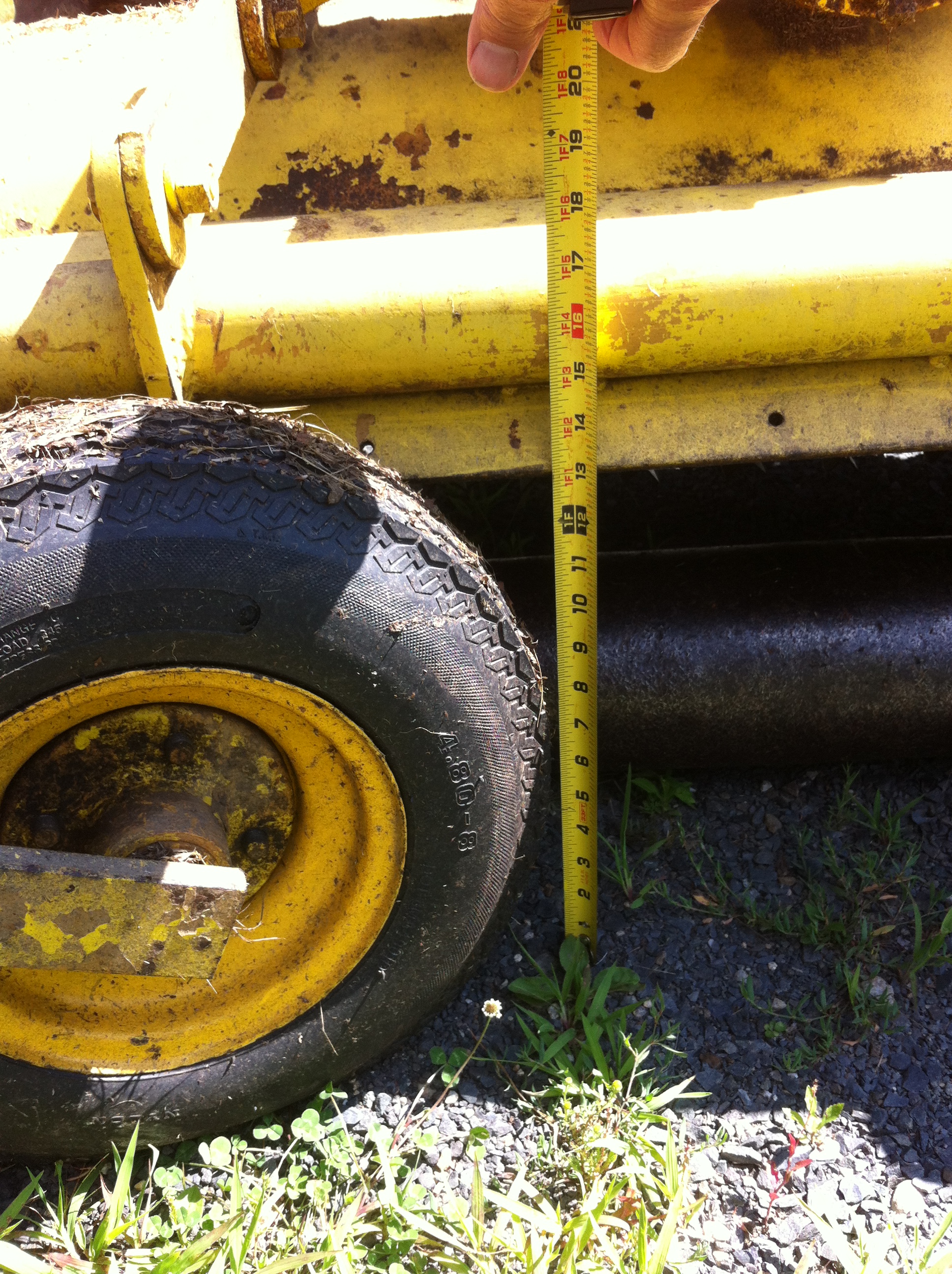

Getting back to the optional rear wheels for a moment. My SHD88 has them, and I use them to take some of the weight off the rear roller and bearings. They swivel nicely for turns. However, they don't swivel all the way around, and the tires hit the rear housing at that point. Therefore, you must raise the flail to back up, sometimes a pain. If you don't raise it, the tires dig into the ground, not turning, since they're jammed against the housing. A pic will help here. 2015-07-21 15.36.46.jpg
Also, the Montage catalog lists the rear trash deflector as 6" wide. That won't even come down to the top level of the rear roller. I can make a deflector, but how wide should it be? I was thinking 12". As it is now, with no deflector, there's cuttings all over the place, and me. Any advice here? Thanks, Jim 2015-06-30 15.46.53.jpg

Getting back to the optional rear wheels for a moment. My SHD88 has them, and I use them to take some of the weight off the rear roller and bearings. They swivel nicely for turns. However, they don't swivel all the way around, and the tires hit the rear housing at that point. Therefore, you must raise the flail to back up, sometimes a pain. If you don't raise it, the tires dig into the ground, not turning, since they're jammed against the housing. A pic will help here. View attachment 469745
Also, the Montage catalog lists the rear trash deflector as 6" wide. That won't even come down to the top level of the rear roller. I can make a deflector, but how wide should it be? I was thinking 12". As it is now, with no deflector, there's cuttings all over the place, and me. Any advice here? Thanks, Jim View attachment 469746
Hello Jimmy,
About the wheels, you can have a new pair of longer weldments made to allow you to back up but its better if you just clamp down on the steering brake if your comfortable doing that while moving if your mule has two brakes for the rear wheels.
Those wheels are high floatation tires if I remember correctly too so they have a larger diameter and width and that is why they get stuck while backing.
The 6" deflector for the mower is what you want. The clippings are carried over the flail mower rotor and bounce against the deflector rubber and then drop down and fall away under the edge of the deflector and the tiny clippings/dry grass are not carried back under the the flail mower and blasted up front all over you and the mule.
A wider deflector rubber will only hold the clippings and create a dust storm of grass clippings and fines as the knives will continue to pull the clippings forward until you lift the flail mower.

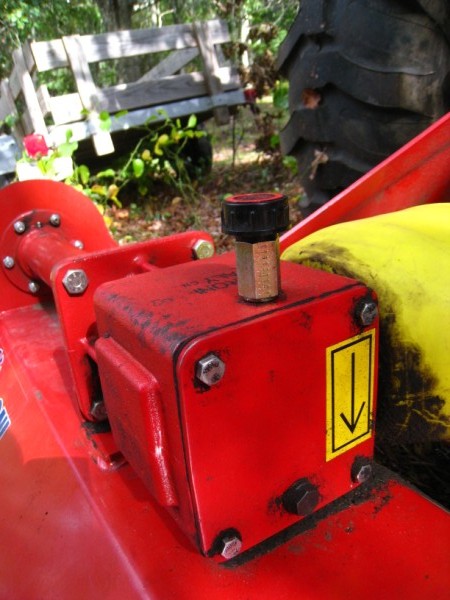

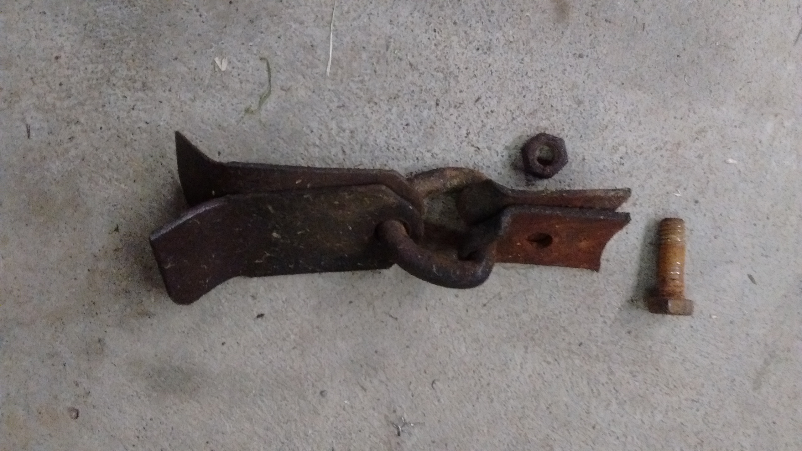

I was able to grind enough of the beat up retaining clips to get wrenches on the bolts/nuts and remove the rest of the knife stations.

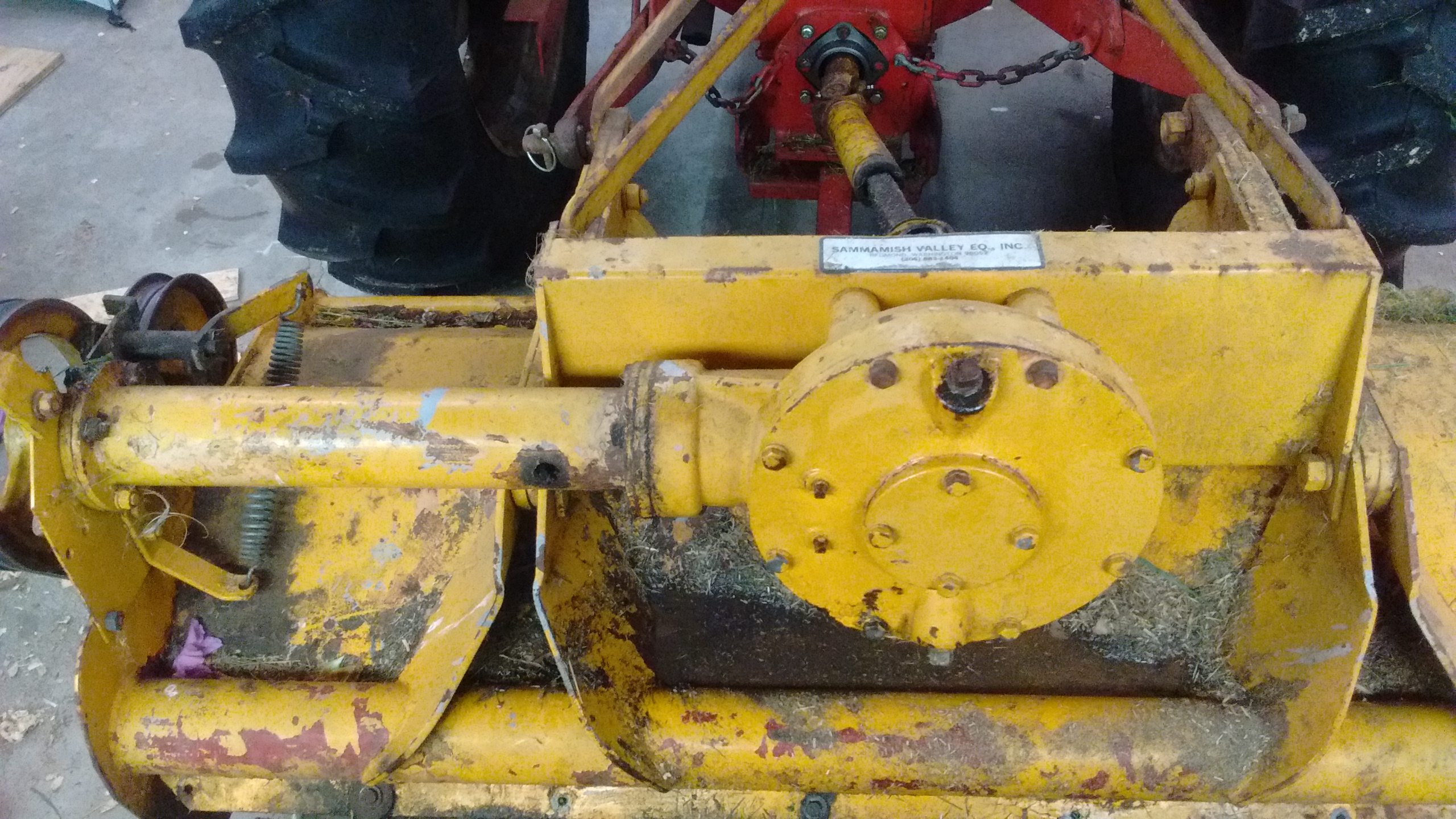

Any suggestions around using a really thick gear oil to avoid the leaking seal? I've also seen a few posts where folk stuffed the gear box full of grease. Anyone had success with that?
At the end of last year I picked up a 6' flail mower.
View attachment 469478View attachment 469479View attachment 469481
Ran it for a pasture clear or two, but the tractor needed the pto shaft replaced so it didn't see much use. Finally got the tractor repaired, and now I want to get the flail in good working order.
While I had the tractor apart, I figured I would replace the oil in the flail's gear box. The oil that came out was >REALLY< thick. Like ten minutes to slowly drain thick. I replaced it with 80-90 gear oil and went in for the night.
Came out to the garage in the morning to a puddle of oil on the floor. Looks to be leaking out from around the input shaft in the tractor side of the gear box. Oddly, it doesn't seem to have leaked at all in the 8 months sitting in the barn.
Long term, I imagine seals need replacing. Short term, would there be issues reverting to how I got it? Fill it with a much thicker oil?

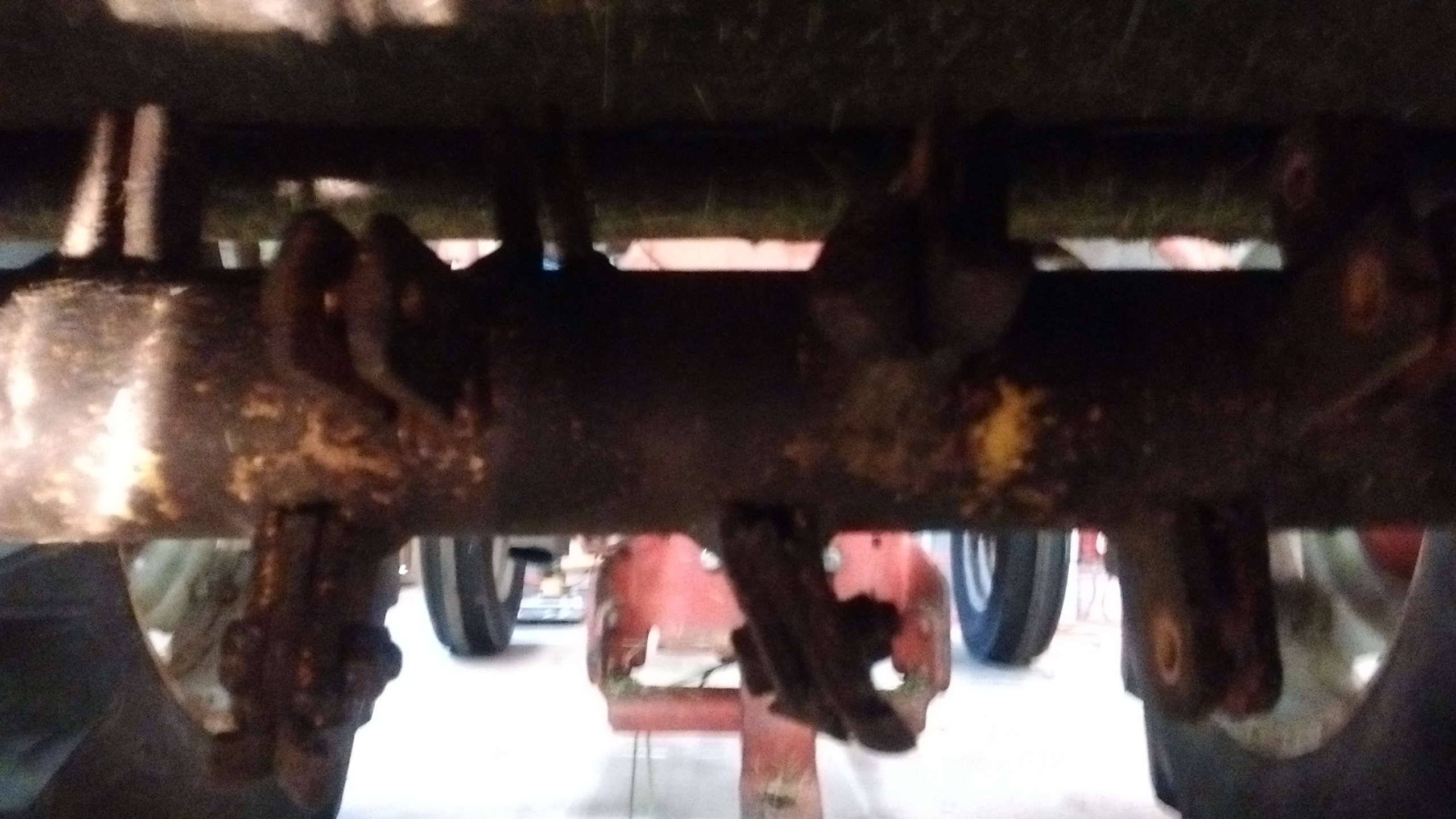

Next, it needed a bunch of missing or broken knives replaced, and those that were still there were pretty beat up. Decided to replace all of them, but the order hasn't arrive yet. I pulled the old off last night.
A section of 4-5 knife stations must have hit something really bad. Maybe 3 stations bent, one missing entirely. For the three beat up stations, I haven't been able to remove the bolts. The retaining clips that hold the d-rings in are so bent that I can't get a wrench seated on either the bolt or the nut. Any suggestions there?
/ Let's talk flail mowers #3,007
Lots of people put corn header grease (barely pourable grease) or the like in old rotary cutters. Not worth it to replace the seals & the grease seems to work fine while not leaking.
I'm sure it doesn't lube quite as well, but a minor increase in wear on an old gearbox won't significantly change its lifespan. It's just a couple of basic gears in there, not a jet engine.
/ Let's talk flail mowers #3,009
Don't use regular grease, use the pourable grease, like Fallon said.
Here is one of the threads on it: http://www.tractorbynet.com/forums/attachments/271324-grease-rotary-cutter-gear-box.html
Thanks. I'll look around and see if I can find some corn header grease.

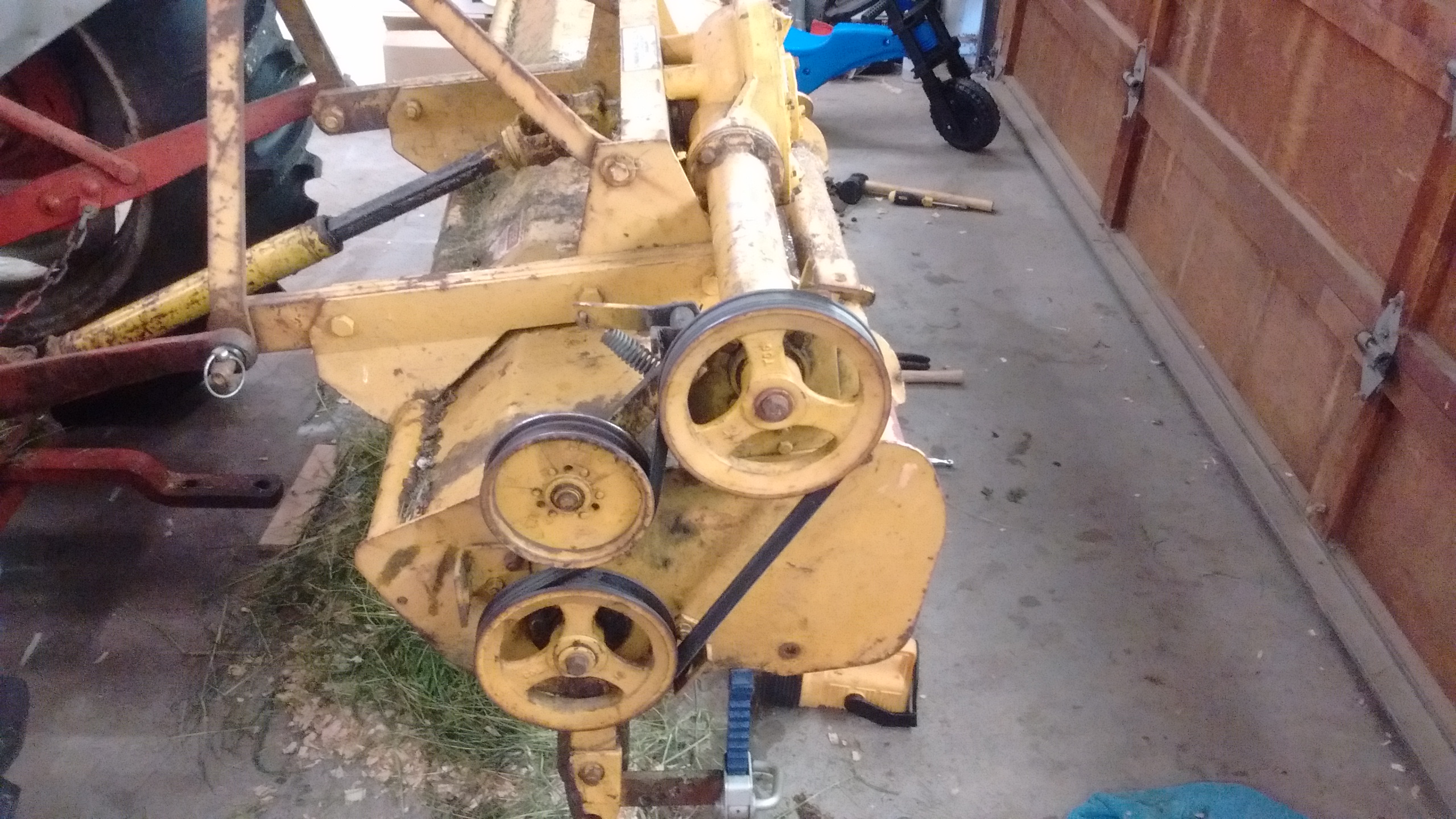

The tension pulley deflects the belt path way more than feels 'right. I suspect the belt it may be oversized. If that's the case, I would like to buy a new belt.
Based on the photos, anyone able to positively identify the mower? I haven't found any markings, but think it may be an older 6' Mott/Alamo.

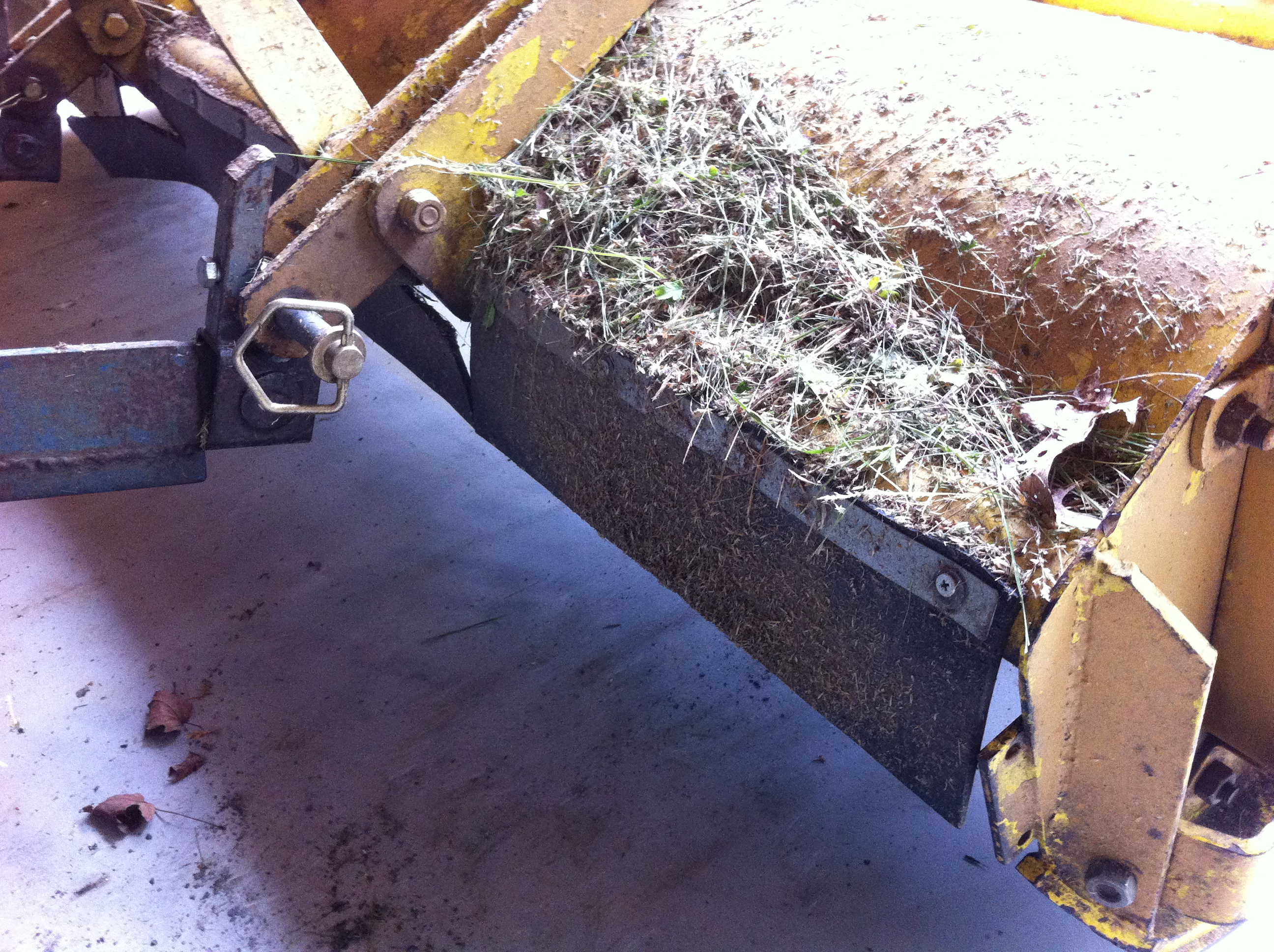

Leon, just to be sure, you know I was asking about the rear trash deflector, even though my pic was of the front. I made that one too, not sure how wide it should be. It's around 6" too. Thanks.

Hello Jimmy,
You can allow yourself about 2 inches of rubber above the rear roller +- to allow the clippings to pass freely over the rear roller so you would want a 4 - 6 inch wide piece of belting across the rear discharge. The idea is to control all the flow coming off the knives in a regulated stream as it passes the deflector rubber. it also helps prevent anything from bouncing very far if a knife set kits something that is at the cutting height level.
I hope that we see more flail mowers with trash doors like the landpride flail mowerswith the cast hammer knives(Maschio brand) I hope Kubota does not kill them off from being sold by their Landpride implement division.
Hope this helps.
