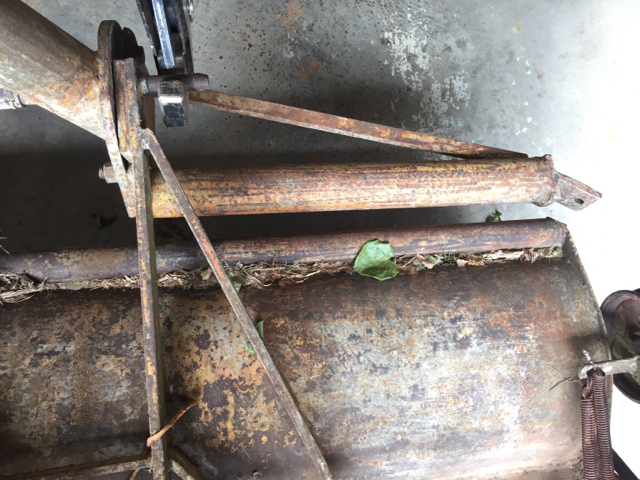

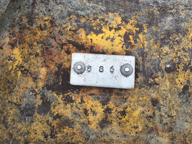

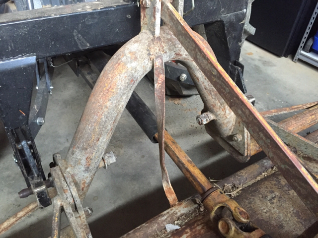

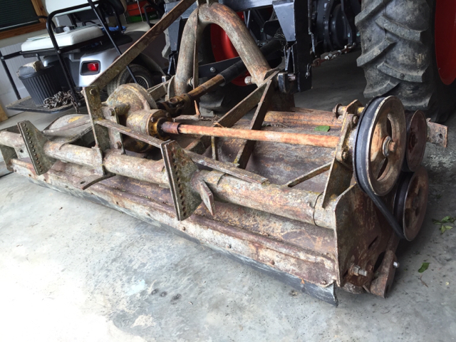

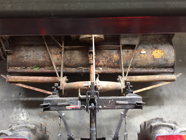

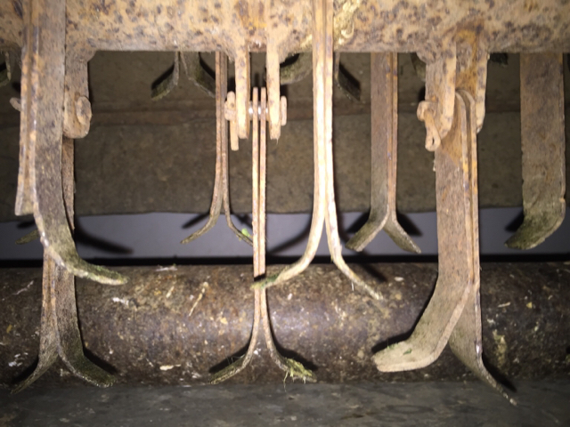

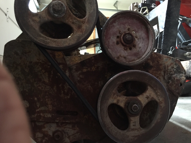

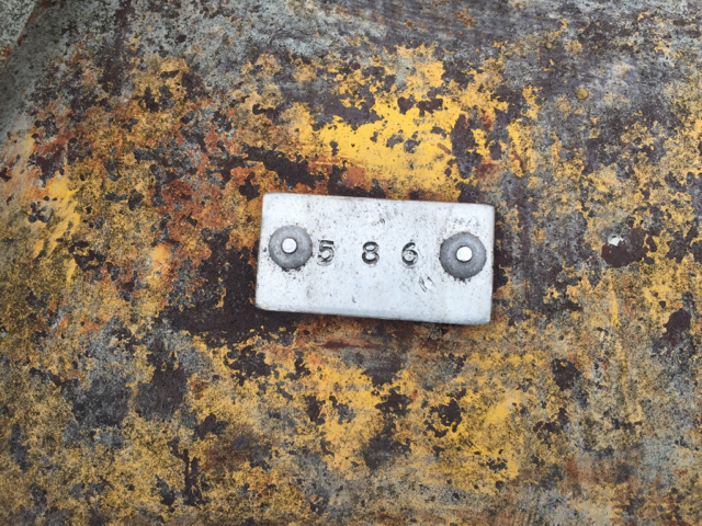

Can the nation take one more look at the mower I picked up last week and help me ID it?
I have contacted Alamo and they said they had never made a round tubed frame.
This looks factory but could be some good custom work I guess.
Thank you,
Lenny
Thank you,
Lenny
View attachment 469584View attachment 469585View attachment 469586View attachment 469587View attachment 469589View attachment 469590View attachment 469591
I don't know anything about what it is but I don't see how those knives could open up the way they are attached.

Can the nation take one more look at the mower I picked up last week and help me ID it? I have contacted Alamo and they said they had never made a round tubed frame. This looks factory but could be some good custom work I guess. Thank you, Lenny <img src="http://www.tractorbynet.com/forums/attachment.php?attachmentid=469584"/><img src="http://www.tractorbynet.com/forums/attachment.php?attachmentid=469585"/><img src="http://www.tractorbynet.com/forums/attachment.php?attachmentid=469586"/><img src="http://www.tractorbynet.com/forums/attachment.php?attachmentid=469587"/><img src="http://www.tractorbynet.com/forums/attachment.php?attachmentid=469589"/><img src="http://www.tractorbynet.com/forums/attachment.php?attachmentid=469590"/><img src="http://www.tractorbynet.com/forums/attachment.php?attachmentid=469591"/>
Looks like an Alamo to me and they changed the 3pt somewhere along the way

I am pretty sure its an old Mott Interstater Flail Mower.
I cannot believe that!!!!!!!!!!!!!!!!!!!!!!!!!!!!!!
Is the JD dealer you chatted with a full product dealer??
I would call another JD dealer out of the area-Mississippi as an example
and as last result call JD in Moline, Illinois as they can help you for sure.
