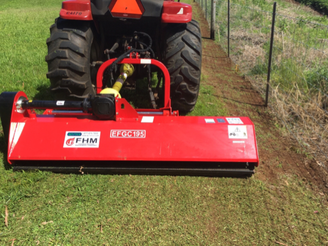

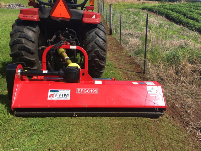

Hi David,
I m glad that your are choosing a Chinese flail mower, I m proud for this since I m from China.
Here is my suggestion, the EFGC and EFGCH, these two flail mower, they are using same rotor shaft, it use Chinese seamless steel tube, model Q235A, its outer diamater is 108mm and thickness is 8mm. According to our experience over years, we recommend 1750mm at most which mean EFGC175 and EFGCH175, the longer the mower is, the higher potential risk will be that rotor shaft will meet problem after years. So if your flail mower need to replace new rotor shaft some years later, you can call my friend in California for help.
By the way, could you take some photos about the hammer on your EFGCH mower? Because we all used casting hammer in the past, now the trend here is using forging hammer, so I would like to see what hammer this factory is using now. Thank you in advance.

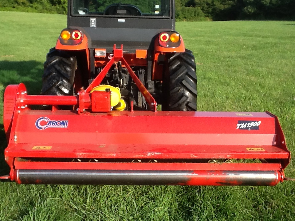

I'm surprised your mower doesn't have a slot. Ideally the topping lift should be to a slot. That allows the mower to adjust automatically to slight variations in terrain and keeps the rear roller on the ground where it should be. The topping lift is mostly irrelevant for flail mowing as you'd use the 3PT arms to lift over an obstruction or for travel. Chain would work but you'd need to get the length right so you could lift for transport and to clear obstructions.
I have found my preference pulling my Caroni to have the top link fixed without using the slot...adjusted just far enough back to lift the front of the mower's side skids about an inch off the ground as measured during setup on a flat, level driveway...keeping the weight mostly on the rear roller. I find that this reduces the rutting caused by the side skids, and more importantly the side drag on my 3-point arms when turning. I still lift the mower for very sharp turns, but this way I don't have to lift it just for larger arcs.
Although this configuration doesn't allow the mower to "rock" back and forth at all, it still rides up and down over terrain just fine, owing to the fact that my 3-point arms are free to go up and down even though their geometry with the mower is fixed. Okay, sure, it isn't going to track to a 1/4" accuracy over small undulations, but it's dang close enough that I can't tell any practical difference in the result.
And sure, if I actually catch it on something a lot closer to vertical, like a tree stump or something, it's going to be a problem. But I doubt that a couple inches of slack in the top link connection is going to help with that scenario.
Just my opinion, formed after trying out a few different setup configurations.
